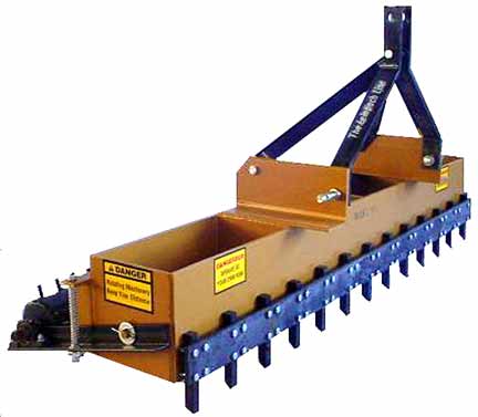

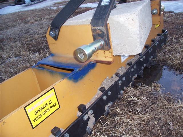

Although my quick hitch is a speeco, I ran into the same problem with my Leinbach Yard Tool aka pulverizer. Here are some pictures of the mod.
Basically I just cut the 2 angle iron strips from the main frame and moved them inwards just enough the the black arms could match up on the outside of the angle iron. Hard to explain, easy to see. Also had to notch out the angle right underneath the pin so the hitch would be able to slide under and connect.
Now after doing all that, I am ready to sell the Yard Tool because I have replaced it with a Harley Rake. :)
