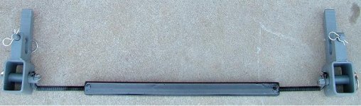

It's been discussed and discussed I know. Just wanted to share the pictures. 97214-3VGA (27.5 inside clearence - NOT the 93691-1VGA which is 26.5) was on sale for 69.99. 9.99 shipping and I used a online coupon for a 10.00 gift card.
Drilled out the holes on the J-hook for quick release pins so I don't have to use bolts. Three of my implements will work sweet as delivered with the hook. The used allied snowblower does not meet quick hitch ASAE specifications so I bought the optional adapter bracket for it (I think it was 8.99). Bought a few cat 2 bushings from Agri Supply because the lower implement pins will fit much better with cat 2 bushings.
Pretty easy and cheap solution. I haven't hooked it up yet, but, my tape measure tells me it will work fine.

1 - What size bit did you use to drill out the J-hook?
2 - Where did you get the quick release pins?
3- What size quick release pins are you using?
I'm about to buy the Quick Hitch and I like the way you have yours set up. Thanks

I believe 1) 1/2 " bit, all you are doing is cleaning out the powder coat/paint. It will wear out within a few hook changes and just using it. Not really necessary but I did do it as well. 2) Any tractor supply, again 1/2" pin. Take the hook with you. I bought the nice ones with the handles and wound up cutting the pins down to the point of just being long enough to fit with a hair pin clip. Some of my implements swallow up most of the hook and the long pins were in the way.

Thanks for this information, ninefinger. I'll be buying the harbor freight quick hitch this week. Very much appreciated.

I found that the part holding the top link and upper hook gets in the way of some of my attachments, so I modded it a little with the 'ol grinder.
