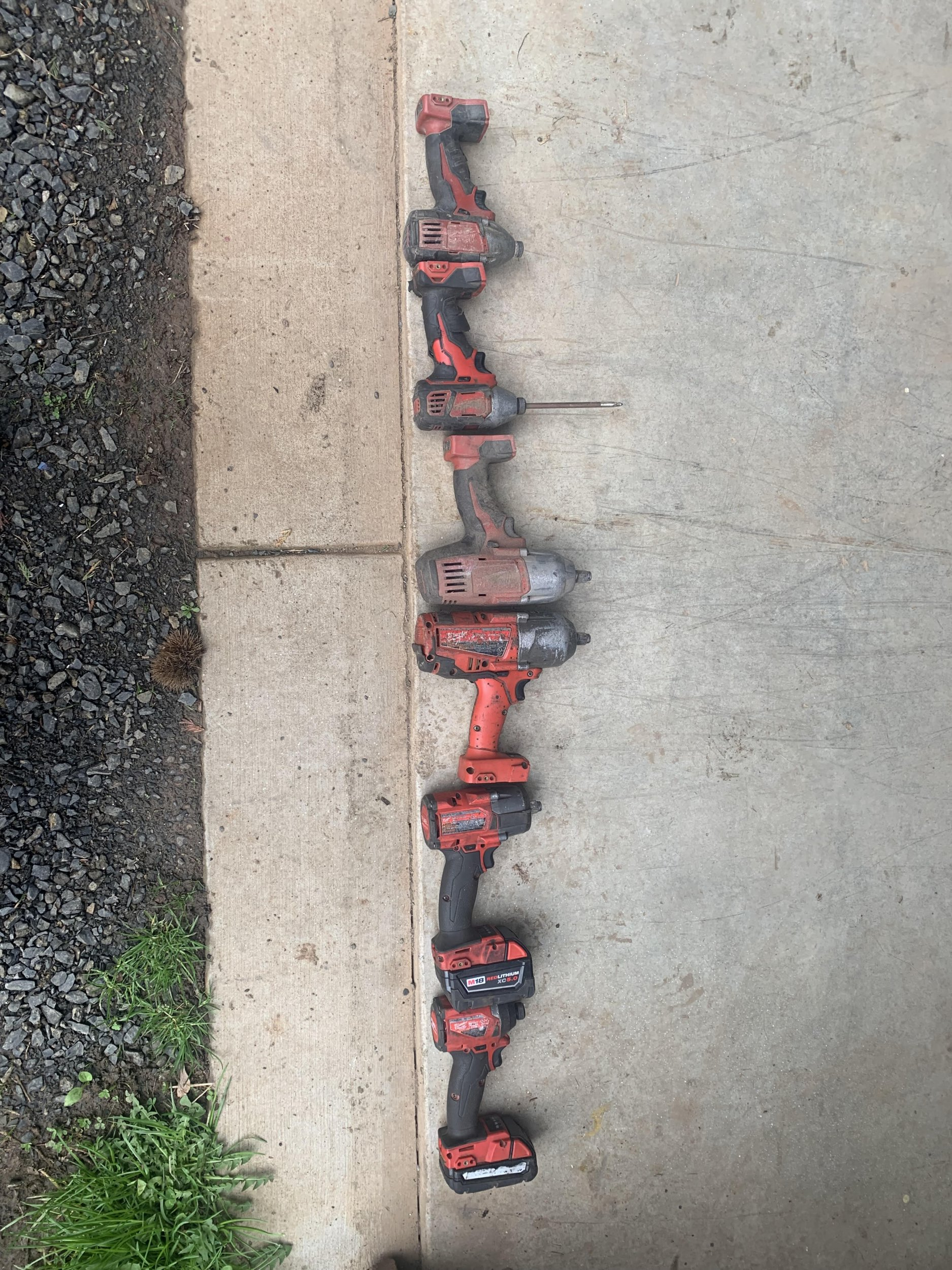

Hum - you are using a impact wrench to torque the lug nuts on your cars wheels ?
Not a good practice.
I just did the spring tire change over on 3 vehicles using my Milwaukee M18 1/2" removing the lugs and installing them using a torque stick it didn't even take the battery down enough to put it on the charger.
Of course I also use never sieze on the wheel studs and the hubs and rims.

It is said not to use a torque stick, or at least rely on it- especially with a non pneumatic impact. One probably shouldn't ever rely on them I guess. That being said, I do the same sans the never seize. Then a walk around with the big T.
   / milwaukee battery 1/2" impact question #48
Because I do use lubricant I use a bit less then the recommended torque on my pickup 110# versus the called for 130# Iv'e verified the results with a torque wrench a few times and it has been quite good.

I did the same thing with steel wheels way back when. But with todays light weight materials the rims are made of, I like to use some method of verification.

Only takes ONE time. Richard. I run them on with an impact but the final torque is always with a torque wrench and... I'll drive them around the block and check them again.

Reasonably accurate and consistent torque isa good thing. Torque wrenches help achieve that. Checking torque after some mileage is generally considered a good idea and suggested in many manuals. Seems to be especially true for wheels made from soft materials such as aluminum.
To the best of my knowledge torque specs assume clean, dry threads. In the northeast with corrosive ice melt on the roads... a case could be made to use some sort of lube, with reduced applied torque. Personally, I leave them clean and dry.
FWIW, I know a few folks with really pricey exotic performance cars with crazy high dollar wheels. Get within 1000 feet with a impact wrench and a torque stick could be a life/death decision. :)

Haa....that woulda been nice, but no such luck. Just reading the replies. Im leaning toward the mid torque honestly as it is considerably lighter and should do all i need since my air impact always has. Still not 100% sure though
