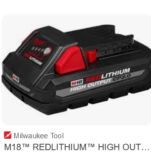

The M18 3.0 High Output is my new favorite for my Drill/Drivers. They are compact and lightweight. Can occasionally find a decent price on Ebay.
