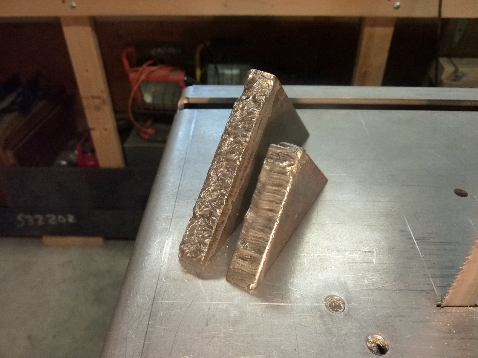

Plasma broke, torch cut.
/ Making Nicer Torch Cuts ??? #49
The preheat flames shouldn't touch the steel and you shouldn't be melting the top edge of the cut. You should have a nice square edge and a smooth cut surface.
