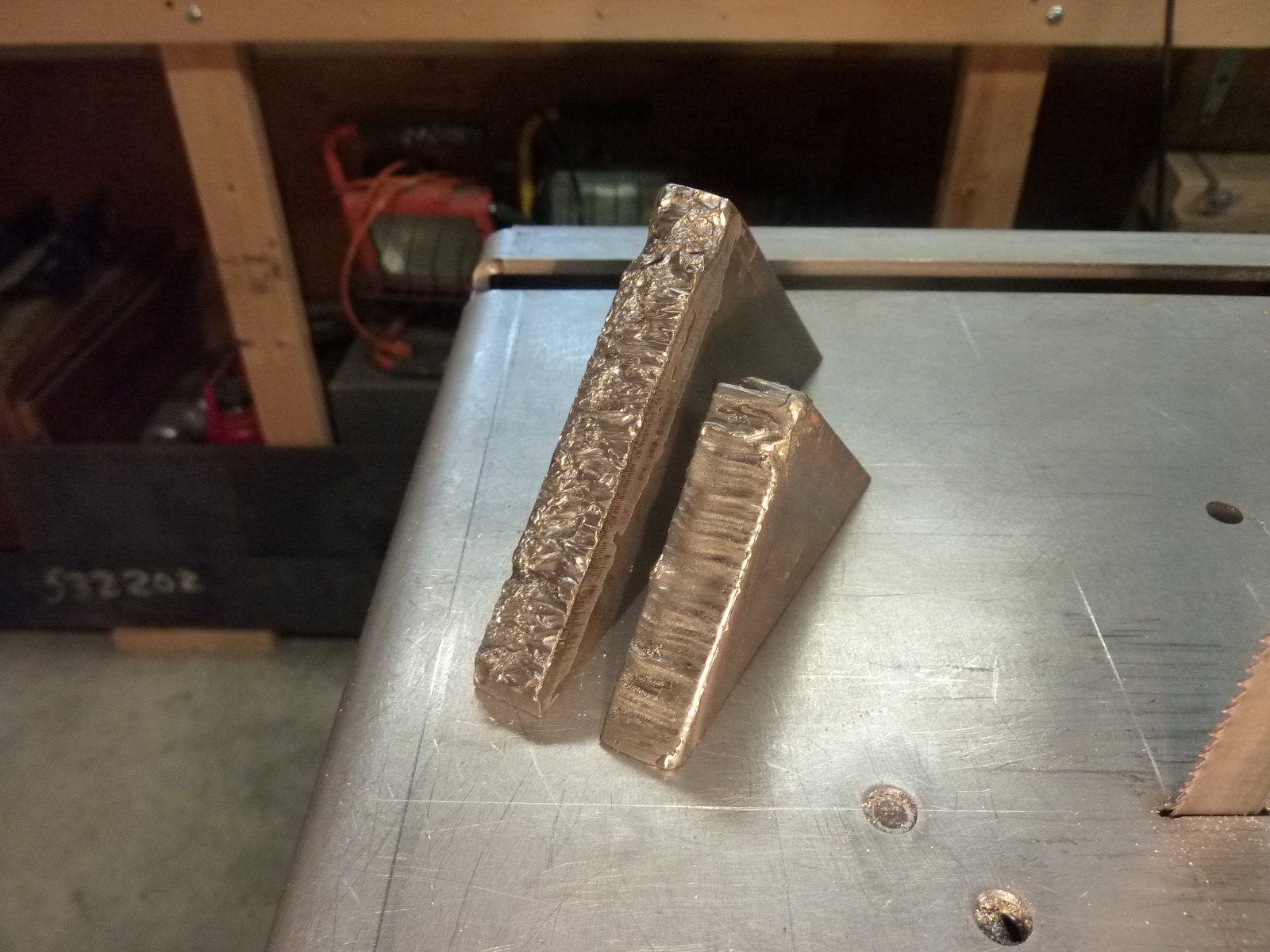

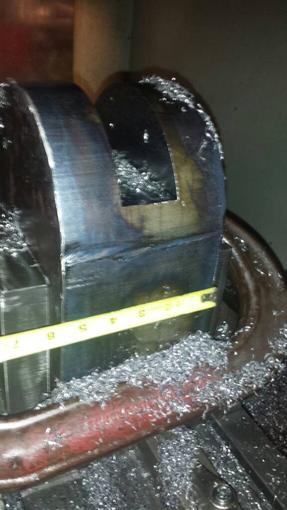

Made these parts last week for a job at work, the cuts are alittle choppy but when you get that thick every single bump or shake shows.
/ Making Nicer Torch Cuts ??? #26
You did that by hand??!! That's as good as my old Linde burning machine!!
A friend of my father once told me he saw a guy cut out 4 inch circles out of 3 inch thick plate that would clean up in a lathe in one or two passes. I never believed him....until now.

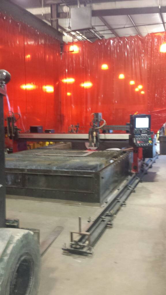

Still not simple to cut plate that thick even in a table.
/ Making Nicer Torch Cuts ??? #33
We run propane it's a lot cheaper.
/ Making Nicer Torch Cuts ??? #34
Natural gas is popular too on cutting machines. If you have the right tip and the right preheat, the plate could be 12" thick and you could do a cut as nice as Shield Arcs. Thick plate cuts nicer than thin plate and if you're using a cutting machine, there's no excuse for not having a perfect cut. The most common reason for flaws on thick plate is not enough preheat. For bevelling thick plate, they often use an extra preheat torch or 2. A shop up here goes through 200 tips a month fabricating vessel components.

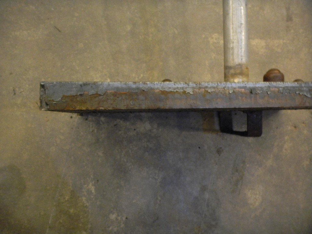

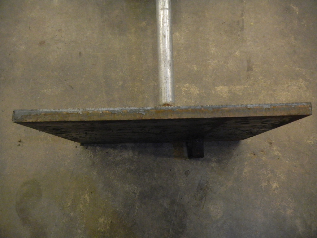

I worked on my torch cutting a little more. I cleaned the tip first. I adjusted the Ox pressure to give me the jet engine sound with the cut lever down. Had to lower the pressure to do that. It cleaned up the slag and got me square corners top and bottom. Still have to work on speed and angle control but I think I have gained some. This is yesterday's with the top and bottom ground smooth and today's w/o a grinder. Not perfect and there is one place I had to restart. I will try some guides next.
Thanks for the suggestions !! Any more are welcome.
gg
#38
Did you use a straight edge?
No, that is what I need to do next. I wanted to try to set it up for the jet engine or ripping noise and by the time I got a feel for that play time was over. Beside lowering the Ox pressure I found making my preheat flame a little softer also helped.
gg
