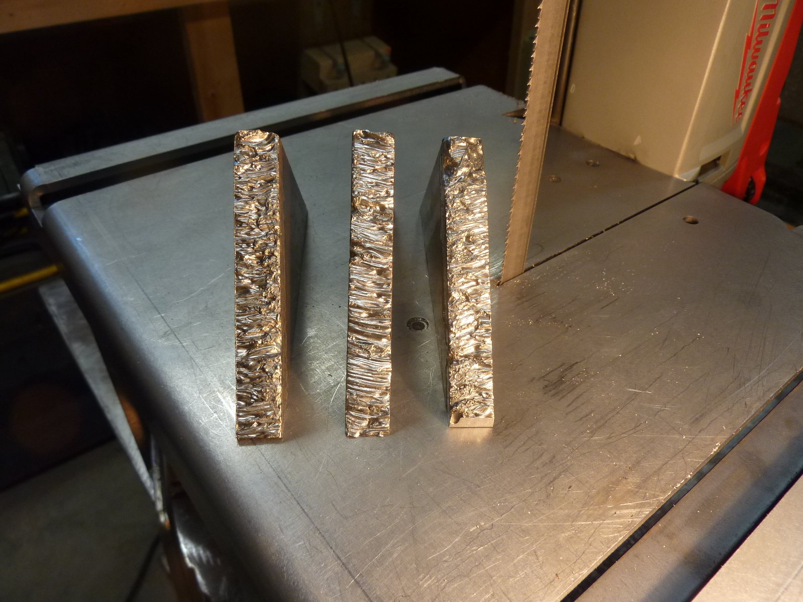

In the past when I make torch cuts I just hack it off and say well there that was easy. But now I would like to make some cleaner cuts like I have seen others do that will be in the root of a weld and places I can't get my grinder. Here are some of my hack cuts I made the other day in 1/2" plate. I would like to experiment to get them better but do not have a clue what to change. I have an old PUROX CW200 torch. Book says 6 psi Acetylene 30-40 psi Ox for 1/2" - I run 35. I have ground the top and bottom of these cuts but anything you can tell me would be good. Thanks

Looks to me like your tip is plugged. Acetylene is dirty, and every time I use my torch I run the tip cleaner through the center hole. Also, if the tip is worn down and angled, might be time for a new one. Sometimes you can file them back flat and extend the life a bit.
Steady hand and even speed is the secret to to good edge quality. There are some decent videos on youtube that will help.

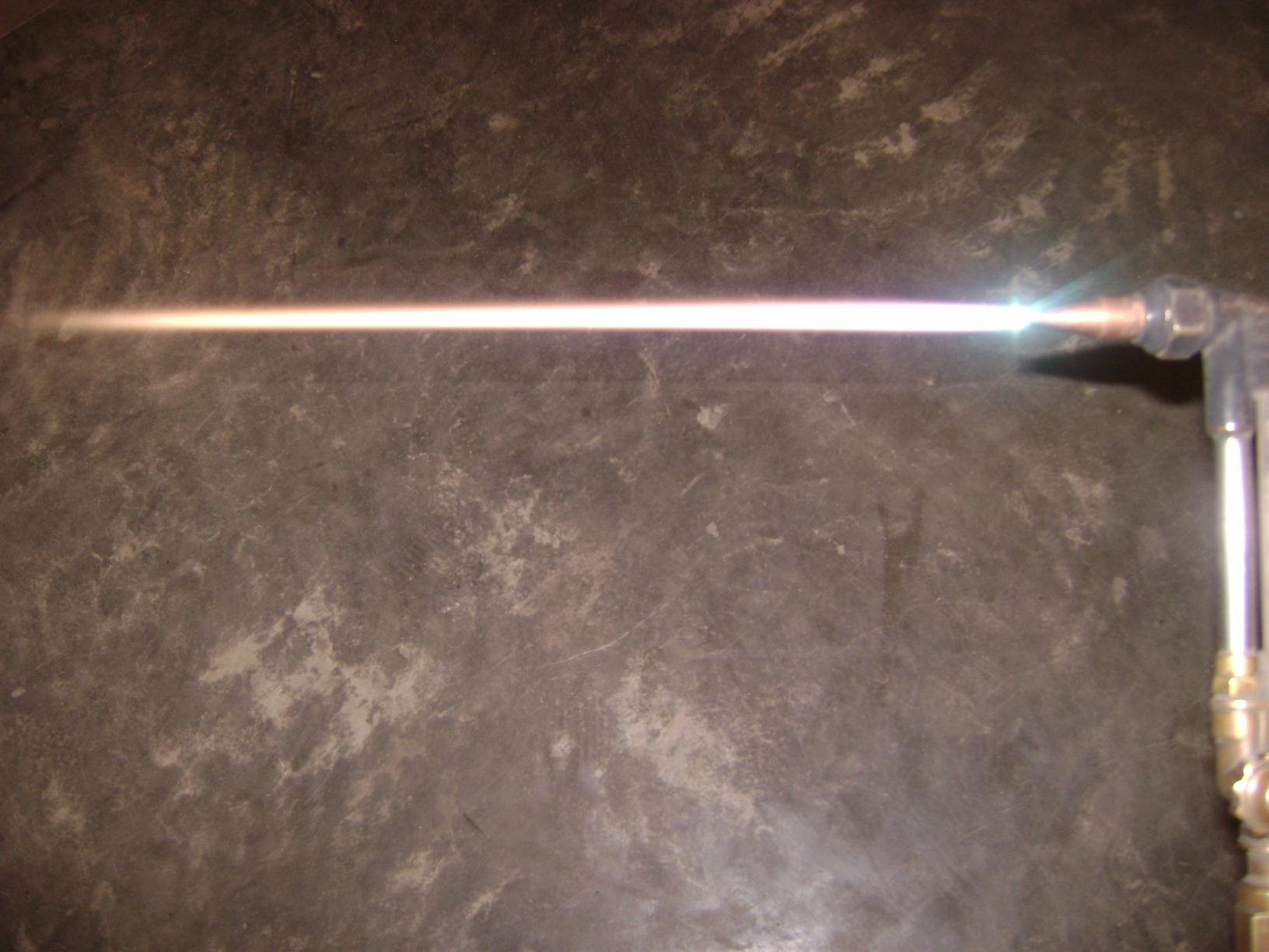

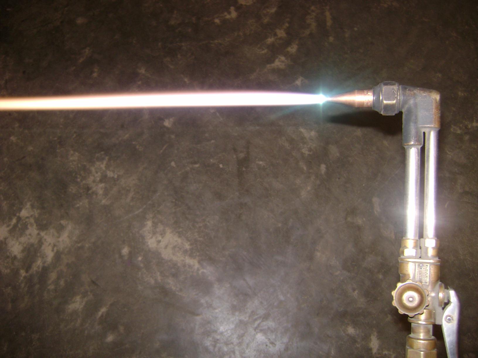

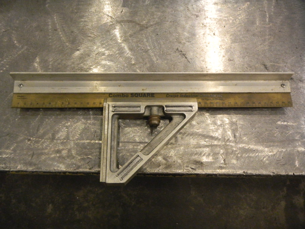

When adjusting the torch, you want a neutral flame. Then slowing press the oxygen lever. Find the spot where the cutting cone goes out from the tip the farthest. Remember that spot! Another big help is a magnetic burning square.

When using my torch and I want a cleaner / straighter edge I clamp a piece of angle on my cut line then run the torch along the angle. Freehand cuts are never straight for me.

Every torch and tip has it's sweet spot. That's why I said slowly push the oxygen lever down, when the cutting cone goes out, and the flame sounds like a jet engine. You found the sweet spot for cutting.
/ Making Nicer Torch Cuts ??? #12
The cut is louder too when everything is perfect too. Make sure you have a nice long straight cutting jet like in Shield Arcs pictures. One thing that wasn't mentioned is what size tip you were using? It's also a good idea to run the torch over the plate to preheat it slightly. This also lets you make sure you're in a comfortable position to do the cut and the hose isn't going to get caught on anything. Sometimes I put the hose over my shoulder and have a short loop so it won't get caught. I'm pretty good with a torch but I forget to breath because I'm concentrating too much on the cut. On steel over 3/16" I prefer an Oxy torch over plasma.
