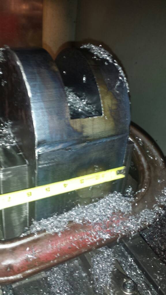

/ Making Nicer Torch Cuts ??? #48
Plasma broke, torch cut.
/ Making Nicer Torch Cuts ??? #49
The preheat flames shouldn't touch the steel and you shouldn't be melting the top edge of the cut. You should have a nice square edge and a smooth cut surface.

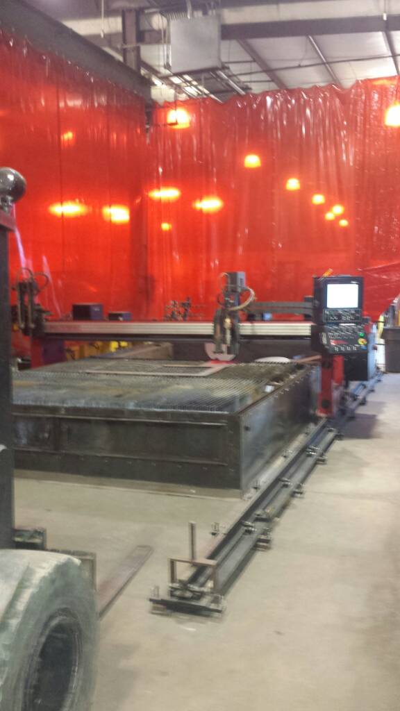

/ Making Nicer Torch Cuts ??? #51
This is the best thing I have built for making better cuts. I should have built it decades before I did.
/ Making Nicer Torch Cuts ??? #53
Very Nice!
#54
Very nice indeed !!!
