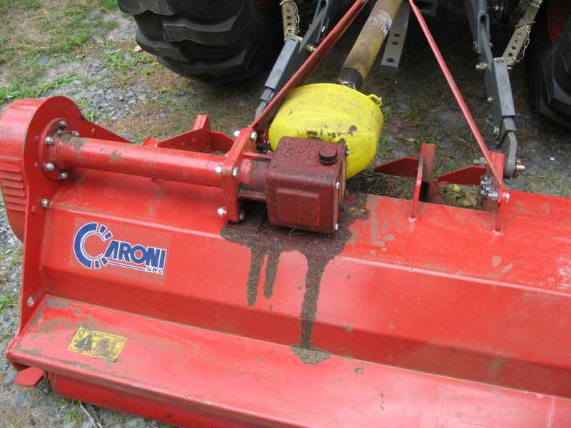

Regarding the sloppy oil problem:
If you want to give the British Metrics extender a try, pm me for the extra one I got (since they come as pairs). I think it cost about 10-12 bucks plus shipping.

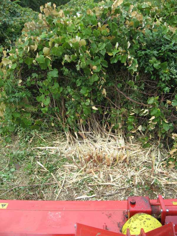

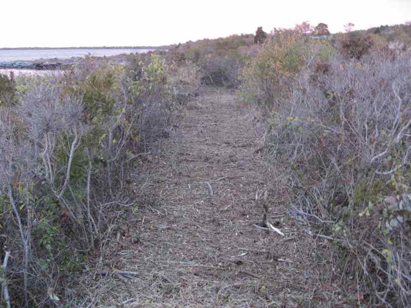

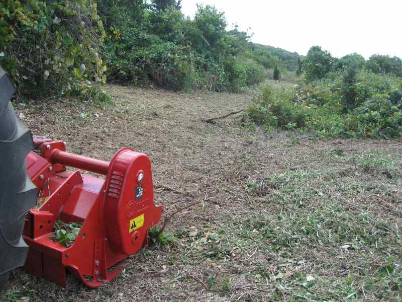

Greetings,
Dont yell to much, but look at Island tractors before and after photos on the farmstead to
see how well his B rotor unit mows and shreds everything.
I think one you see how well it mows you will want to purchase the Caroni with
the B rotor with no question whatsoever.
The flailmower will be a safer mower as far as the 2 and 4 legged rug rats are
concerned as well as the shroud contains anything the side slicers would impact as well.
That is the major reason he owns the caroni for mowing.
You may have to overlap or mow in spiral pattern if the area is big enough but you can also overlap in opposing directions while mowing and the bermuda will pop back up in a day or two with much less injury from mowing as well.
I have a mathews flailmower and there are a very happy bunch of caroni flail mower owners here too and they can offer you their insights as well. DrJay has a huge amount of florida grass and pasture he mows and he could not be happier.
They are pretty vicious with garden hose snakes that have been sleeping in the weeds all winter too HAHA

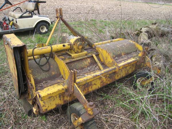

Shoot thought I just struck the jackpot. Ford 917 on the craigslist for $500, but it's only a 5ft. Really want a 6ft mower....
/ Let's talk flail mowers #1,566
And just found a 6 footer of unknown brand and condition a couple hours away for $250. For $250 it could be pretty rough and still worth it.

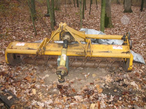

Why are center mount flail mowers so hard to find? Everything i am finding new and used are offset to the right and wont cover tire tracks unless you go huge. I need a 74-82" CENTER MOUNT like this one. Unfortunately this one is 1,600 miles away.
/ Let's talk flail mowers #1,578
And i would REALLY like to find one with Gauge Wheels like this due to our rocky conditions....

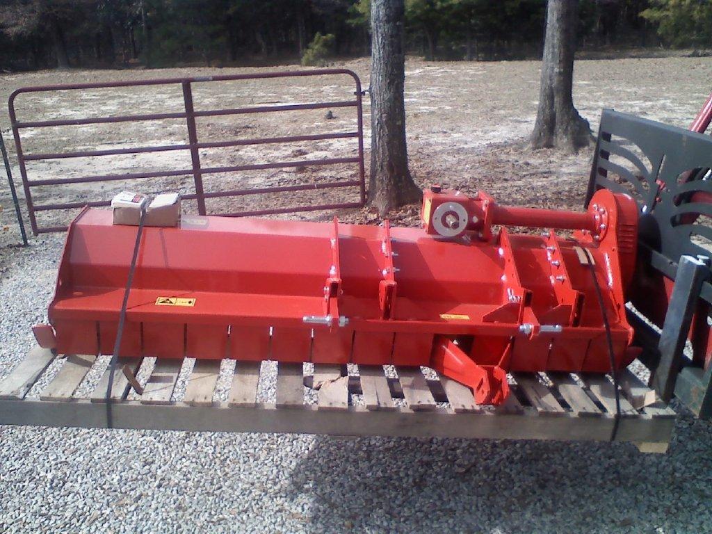

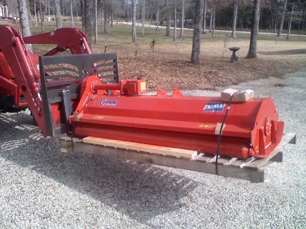

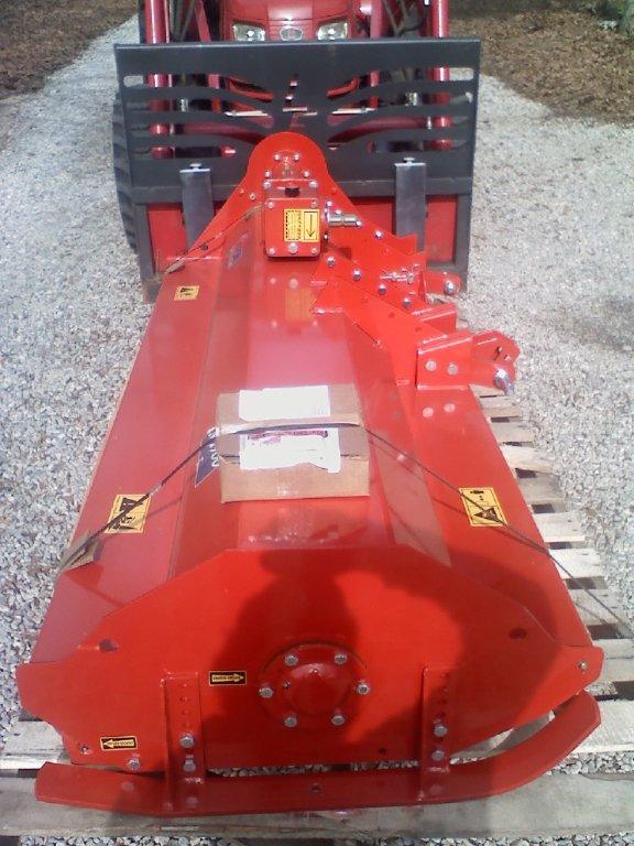

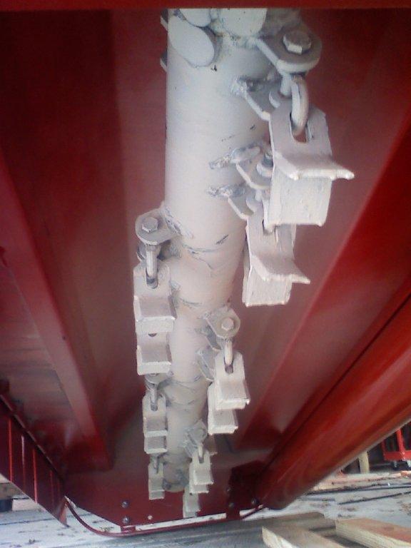

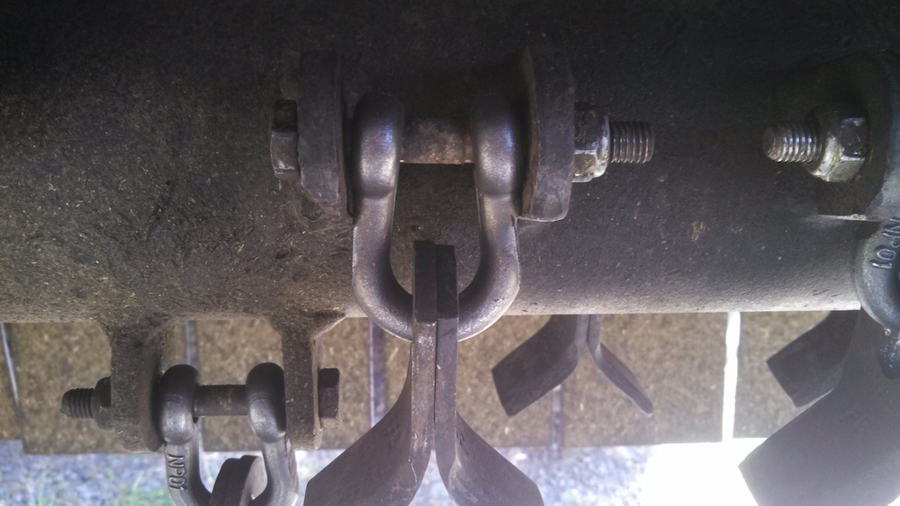

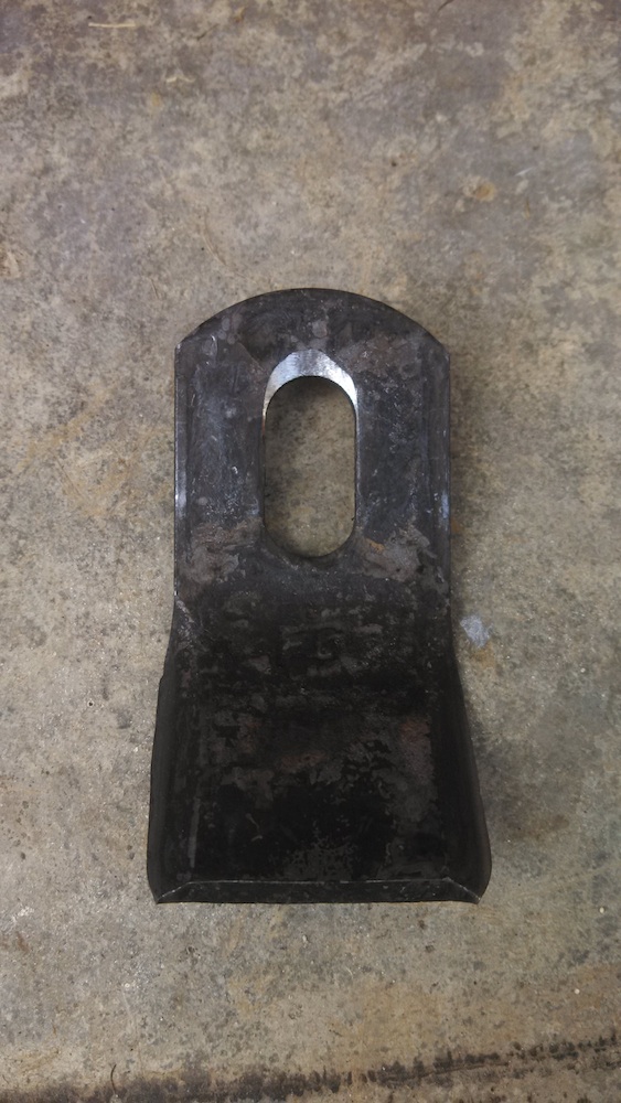

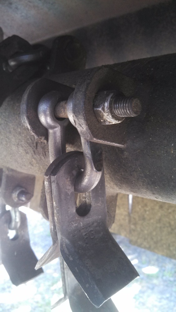

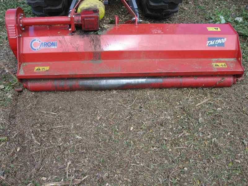

Been a while since I posted the note below, but I just got around to doing a complete conversion to Flailmaster clevises and blades on my Caroni 1900. After busting a few more Caroni clevises mulching up some thicker/rougher stuff, I just wasn't willing to keep spending the ridiculous money on the Agri Supply Caroni parts.
Changes/observations from when I mocked up the parts earlier:
- Grinding is necessary, but relatively little - and even after doing so, the Flailmaster clevis is still more substantial than the Caroni/Agri Supply clevis. I initially didn't think it would be necessary, as the lone clevis I modified swung without interference. Turns out - it's extremely close, and the tabs on the drum are not very uniform. Some of the tabs are slightly narrower than others, so the clevises wouldn't swing completely free on all of them. Taking off 1/6" or so per side made the modified clevises swing freely on all the tabs.
- My neighbor who has years more experience than I with such things suggested another change. He looked at some of the legs that remained from the broken clevises and suggested relieving the blade holes with a conical grinder head. His point being, that the edges of the blade holes are quite sharp and the material is hardened, and he could see where the sharp corners had worked their way through the Caroni clevises. While the Flailmaster clevises are far beefier, I still relieved all the top edges of the blade holes to hopefully reduce this effect.
- Rather than using a bolt/nut to squeeze the Flailmaster clevises together to fit between the drum tabs, a good sized vice did the trick very quickly. Basically, just squeeze the ears together until you can just get a blade to slide over them.
The whole conversion took a couple hours. I've about 2 hours mowing since doing so, all seems fine - works as well as before. I've got a job next week that will have me mowing some heavier brush and will report back on how these hold up.
As an aside...I've got over 20 used original Caroni clevises that are certainly serviceable. If anyone is interested in them, I'll let them go far cheaper than new...:D
Having busted several clevises on my Caroni 1900 recently during an initial lot clearing, I discovered the sticker shock of buying parts from Agri Supply for this implement. Querying here for options resulted in the sad news known to many of you - nobody seems to have found an alternative for the ridiculously priced $7 metric clevis. That didn't sit well with me...:D
I may have found a solution. I say "may", as I've not actually tried it yet - but once I've used up the last of my four spare metric clevises from Agri Supply, I'll give it a try and report back if nobody else has given it a whirl.
I got the idea from Island Tractor's post, wherein he gave the info on cheaper blades from Flailmaster.com. I picked up a bunch of those, and they do indeed work fine. However, he also mentioned an SAE clevis - Flailmaster part #M-100761. This clevis is too wide to fit between the ears of the Caroni drum. However...I was able to easily tweak it to fit. Pic:
I simply took one of the M10x80mm bolts and a nut, and pressed the SAE clevis together. It deformed as I expected, such that the ears are no longer perfectly parallel - but that doesn't seem to matter. The assembly shown above still moves easily on the stock M10x80mm bolt, swinging back and forth with no interference. The clevis modification takes all of a minute or so.
Some caveats:
- You'll likely want to replace all of your metric clevises if you go this route - not just the broken ones. This SAE clevis is indeed beefier than the metric one, and weighs more. I'd be concerned about proper balance mixing them up.
- The entire assembly is just a tad longer than stock - perhaps 1/8".
Here's a breakdown of current pricing from Agri Supply vs. the sources I used for the entire assembly:
Agri Supply
Clevis: 6.99
2 x Blades@ 3.49: 6.98
M10x80mm Bolt: 3.49
M10 Nylock nut: 1.49
Total: $18.95
Elsewhere
Clevis M-100761: $2.80 (flailmaster.com)
2 x M-108381 blades@$1.54: 3.08 (flailmaster.com)
M10x80mm Bolt: 0.46 (nutty.com)
M10 Nylock nut: 0.13 (nutty.com)
Total: $6.47
Yup...almost 1/3 the price. And, based on the sturdier appearance of the SAE clevis - my guess is, the cheaper assembly will hold up to more abuse.
Again - untested, but looks promising.
