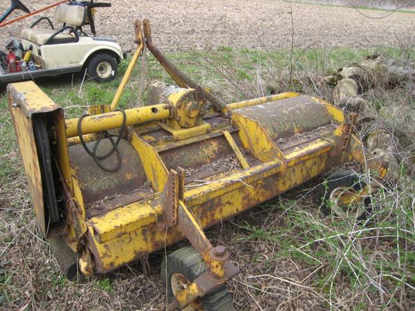

I picked up a old Mott 88 flail mower from a local township today for 232.50. This unit is 88 inches wide and has a slight offset to the right. The township had a extra set of knives for the mower, but the employee was afraid to give them to me as all that was bid out for sale was the mower. { I really am loosing my touch.] I would get a practice piece like this as others have done before ordering a new 2000.00 mower. If any thing bad happens I still have scrap to sell.

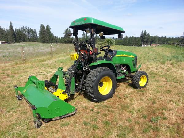

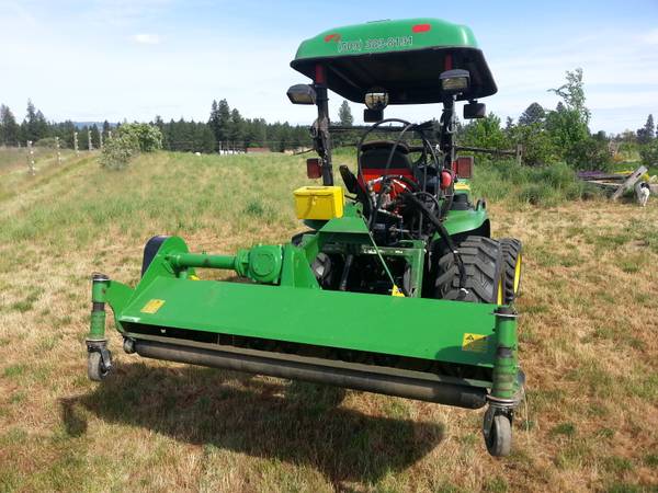

/ Let's talk flail mowers #1,613
I would REALLY like to find something like this with dolly wheels.........
/ Let's talk flail mowers #1,614
The tractor i am upgrading to has 30.5 PTO HP and 36.2 Engine HP on a gear drive. I would NEVER mow with a hydro as they suck too much power. I walk these properties every year but it never fails i miss stuff in the tall grass and contractors leave crap lying all over. Typically i cut at around 4" or maybe a little less. I am worried that the "clockwise" rotation will not pick up the grass that the "Counter-Clockwise" rotation would pick up. My main concern is the $500K homes i am mowing around as well as all the people walking in the public areas. Here is a photo of one of my main jobs which totals 30 acres..........
The clockwise rotation is preferried BECAUSE the flail mower rotor will throw any thing it contacts iforward and impact the flail mower hood and then fall to the ground as I have labored to explain to you.
You can safely mow at two inch height which I explained is the optimum height for mowing
which creates the suction needed to lift and carry the clippings over the flail mower rotor
and back tot he ground SAFELY.
Your tractor upgrade is going to be to low in useable horsepower at the Power Take Off.
If you can afford a 40 horse power hydro unit you should at least consider that as many retailers are offering zero percent financing.
Again the clockwise rotation is fine! The problem is your 4 inch mowing height
which I have labored to explain to you will be the problem.
Unless you purchase a Vrisimo road sider or spend a small fortune on an Alamo flailmower
you will not be able to buy a flail mower with casters.
AS I mentions previously mowing at two inch cutting heightthis will provide with the cut
you need and the safety in mowing while pedestrians are inthe area.
We used a John Deere 25A with a Ford Jubilee so think about that please as a JD 25A will work
well for you mowing at the 2 inch cutting height. You really dont need the casters if you mow
slowly in a spiral pattern as you will overlap avoid braking and backing up wasting fuel and time.

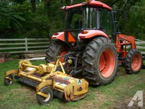

I can fab up casters as long as i have a good solid surface to mount them too.
(you cannot fabricate heavy enough casters for this)
(The casters are there ONLY to allow the flail mower "which is in contact with the ground
surface" to prevent the rear roller and side weldments from gougeing the ground.)
In order to sove this you will need to buy a motorised towed flail mower with front and rear caster wheels OR
Simply purchase a small horsepower Vrisimo flail mower and ask to have front and rear casters installed as an add on item with casters and ask them to install front casters on it as well for you.
Rear casters alone will not solve this issue as the area was not finish graded with dozer apparently.
Either way you are going to have to install a York Rake in the front of this tractor with your mowing conditions.
If you purchase a JD 25A seven foot finish flailmower you will be able to weld the caster weldments to the front box beam BUT
saying that you would have to attach the casters to the side weldements behind the flail mower rotor using steel tubing the thickness of the box beam to mount the casters.
It will be much simpler for you tp purchase Vrsimo flailmower sized for your tractor and have them make a change/add
order to ad front casters to the mower as they have to mount the four casters in the proper location onthe flail mower to prevent interfering with the rear wheels and the lifting arc created by the three point hitch.
Dont expect to be able to mow fast with a low horsepower flailmower its not going to happen.
Again I want you to suceed and not fail. I do not have my hand on your wallet. I am simpy trying to be realistic with you and your operating conditions.
Ask Vrsimo how much a 5 foot flail mowr would cost with front and rear casters and more structural steel to support them.
The flail mower shroud is designed to complement and add strength to the side weldments of a flail mower.
The with shrouds with the mounted casters are thicker steel to increase the structural strength of the shroud and side weldments as the caster add two more points stress to the flail mowers weldments.
I take it this mess is a HMA with fussy owners?Homeowners Management Association?
You need a york rake to help with this period.
