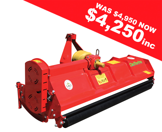

Awesome thread! Haven't read every page, but did search thread for Del Morino brand flail cutters with no results found. I am currently in the process of buying a Mahindra 5035 HST that comes with an unused Del Morino 186 cm Flipper flail cutter. Does anyone have any experiences with this product. Haven't, ever, used a flail cutter, but almost bought one for my Takeuchi CTL. Below is a thumbnail stock photo of this cutter, just click on it to enlarge.
Thanks in advance!

They-Del Morino have been building farm machinery for 120 years.
The European safety standards for all mowers and flailmowers
are much higer than ours here in the united states.
Home page with english translations for all models, YAY!!
Home - Farm lawn and Garden Equipment, home garden tractor equipment, new idea small farm machinery equipment - DEL MORINO s.r.l
You will not make mistake with it as it is a high quality product.
The Del Morinos have added a pair of V belt cooling vents in the V Belt shroud
which is a plus(you still have to clean behind the belt guard and dig out the grease fittings.
When you brong it home let us know so I can officially welcome you as the newest member
of the flail mower nation.
Happy mowing
When you get it home ask more questions as a flailmower is
much easier to use and leaves little to no clippings to worry about.
