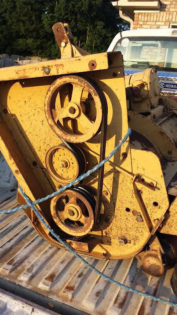

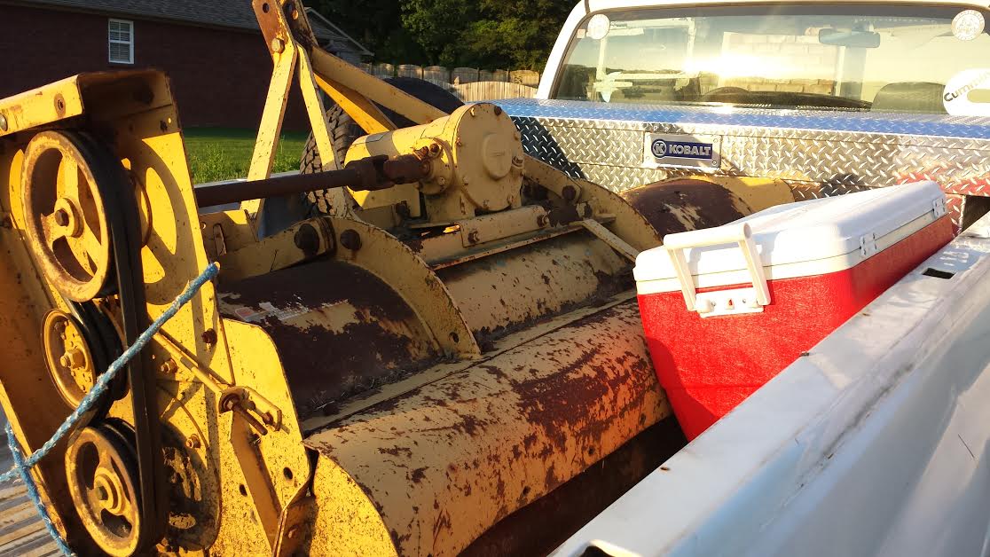

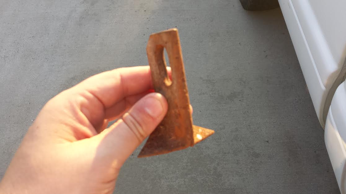

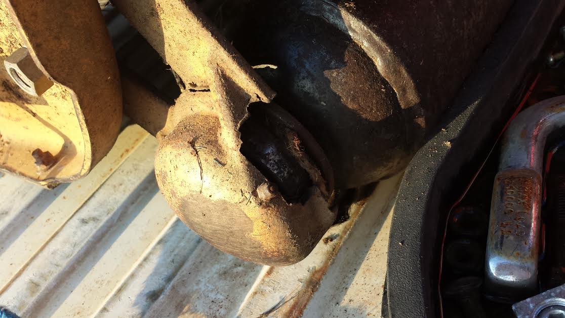

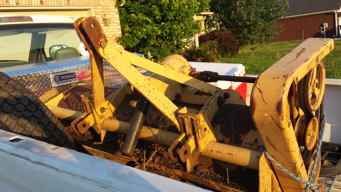

Well here's my new to me ford 917 including a pic of the blades that are on it. Only real mechanical defect I found on it was a previous owner had let bad bearing go on the roller to the point it wore a hole in the housing. Guy I bought it from had replaced the bearing with a sealed unit. If I keep it long enough for the sealed bearing to go out I may take it to the machine shop and let them braze it up and repair it correctly. I also got a bag full of the mounting rings and some spare blades in the deal. The belt guard came with it as well, it's just not on at the moment, guy had taken it off so I could inspect the pulley system.

Well here's my new to me ford 917 including a pic of the blades that are on it. Only real mechanical defect I found on it was a previous owner had let bad bearing go on the roller to the point it wore a hole in the housing. Guy I bought it from had replaced the bearing with a sealed unit. If I keep it long enough for the sealed bearing to go out I may take it to the machine shop and let them braze it up and repair it correctly. I also got a bag full of the mounting rings and some spare blades in the deal. The belt guard came with it as well, it's just not on at the moment, guy had taken it off so I could inspect the pulley system. <img src="http://www.tractorbynet.com/forums/files/attachments/378060-lets-talk-flail-mowers-flail-1-jpg"/> <img src="http://www.tractorbynet.com/forums/files/attachments/378061-lets-talk-flail-mowers-flail-2-jpg"/> <img src="http://www.tractorbynet.com/forums/files/attachments/378062-lets-talk-flail-mowers-flail-3-jpg"/> <img src="http://www.tractorbynet.com/forums/files/attachments/378063-lets-talk-flail-mowers-blade-jpg"/> <img src="http://www.tractorbynet.com/forums/files/attachments/378064-lets-talk-flail-mowers-flail-damage-jpg"/>
That was a deal for $500. Looks beefier than the Caroni and the Caroni is plenty strong.
I thought so. I went fully prepared to haggle and couldn't do it in good concience. Thought it was probably worth a bit more than $500....
I love my 917.
Those knive are what mine has (three rows of 11) work great. They cut lawn grass, clip pastures and even do light bushhog type cutting.
I sharpen mine with a 4.5" angle grinder with a flap wheel.
Great score. :)
