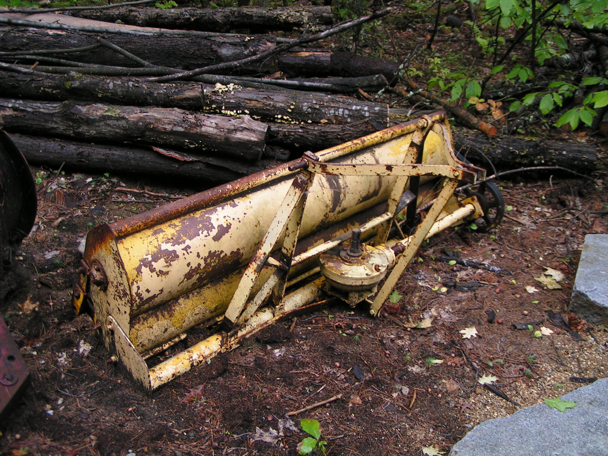

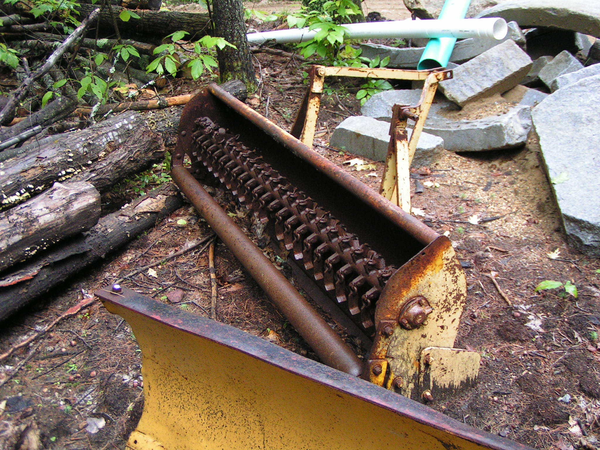

OK I need some help. I just purchased an OLD JD flail mower. I need knives and a belt. It has the cup type knives. The belt is old it may still work for a while but thought I would replace it. It needs some work but I will be useing it for rough cutting and pasture. Where can I find any information on the mower? I cannot find ANY data plate or numbers. maybe I just don't know where to look. I have skimmed through some of this thread but didn't see anything I could use to ID the beast. Thanks for your help.
/ Let's talk flail mowers #1,558
If Leonz doesn't reply, send him a PM. He is our resident flail guru.
