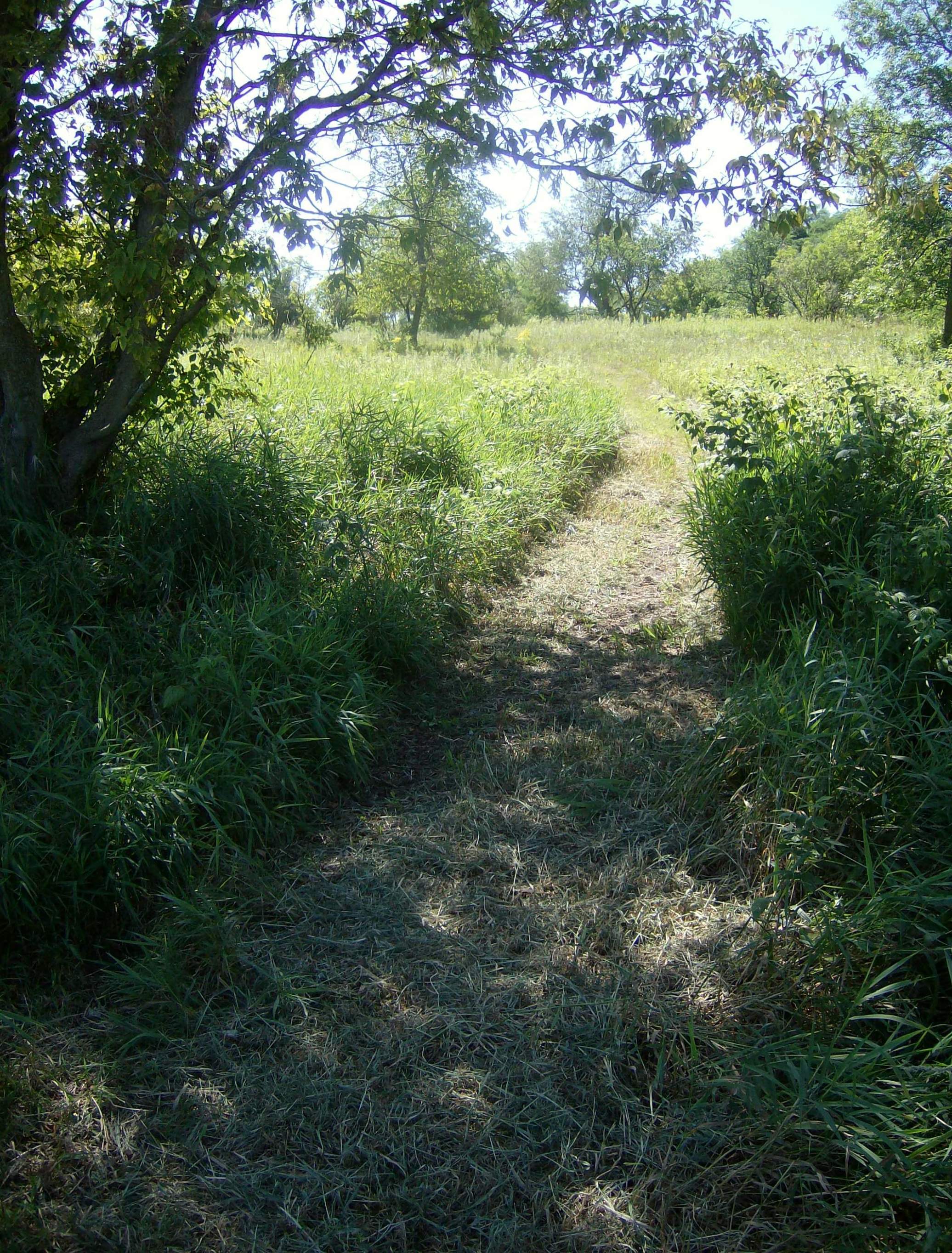

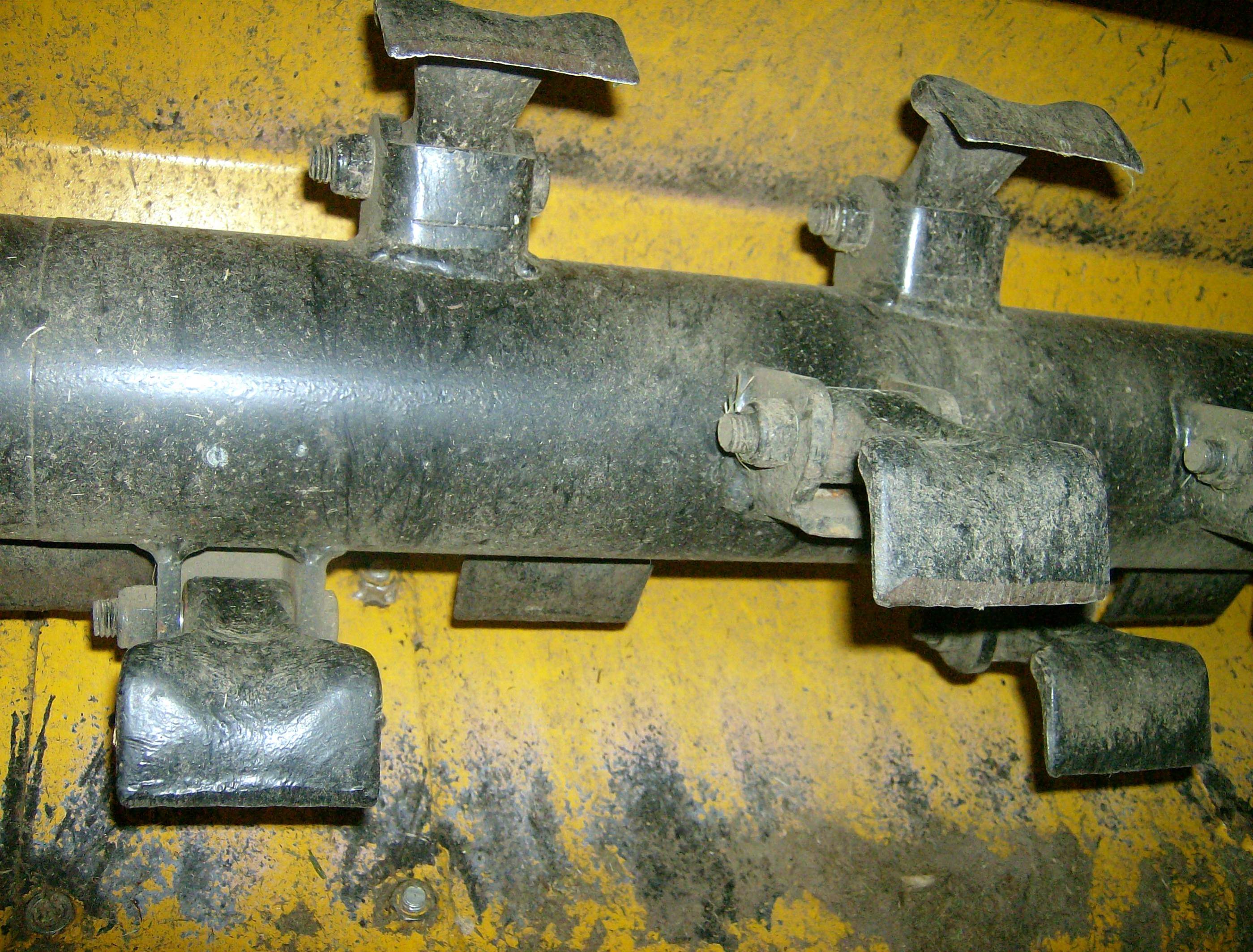

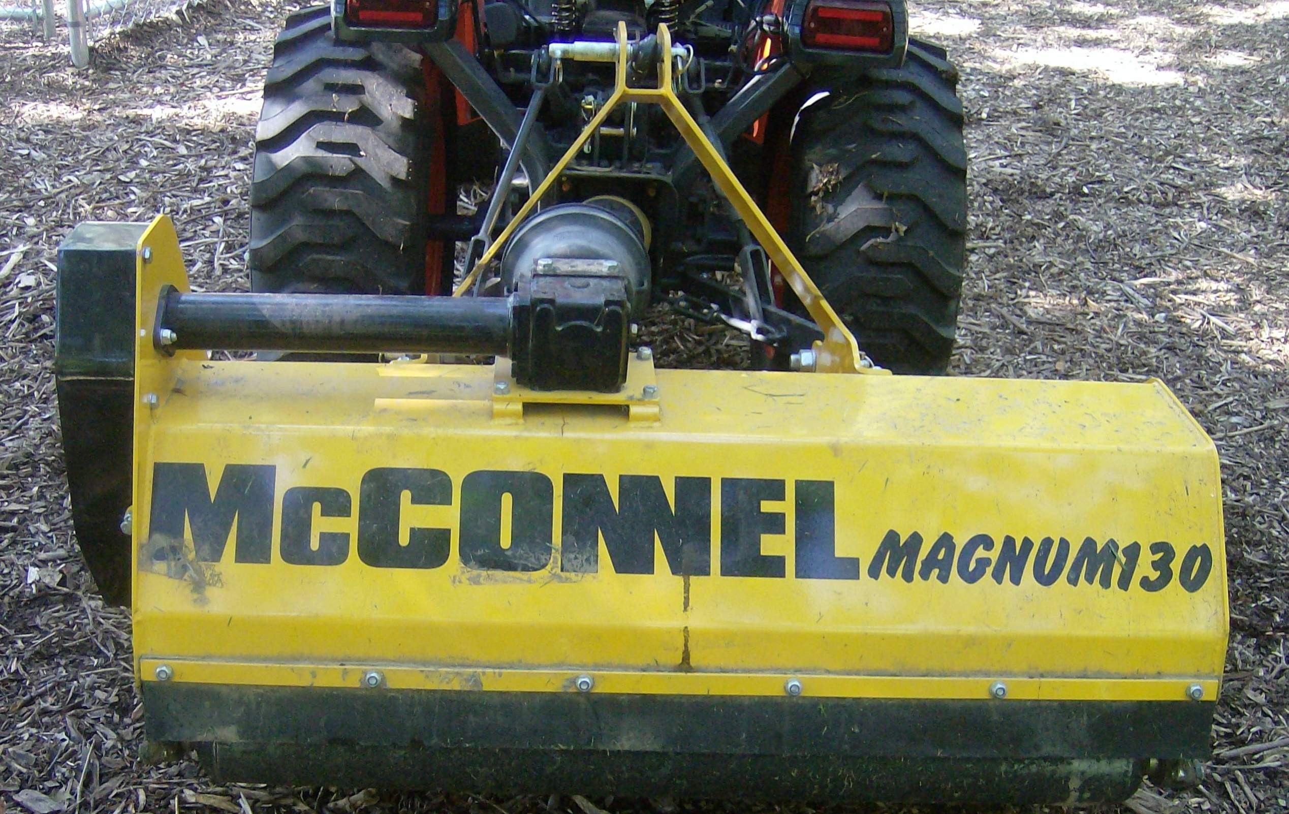

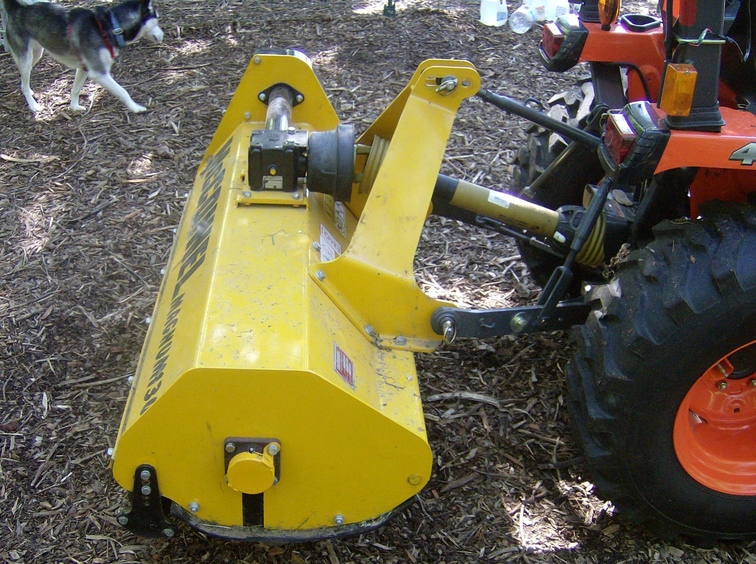

If I recall correctly, the hydraulic kit can be purchased from AgriSupply for ?under 500 bucks. IMO it is only necessary if you need to keep moving the mower while mowing along a fence line. I have the TM1900 and have mine offset semipermanently. As noted, it takes maybe 15-20 minutes to do it. Just unbolting about ?4 or 6 bolts, repositioning the frame and then rebolting. Easy Peezy. I like mine offset to the right even though I don't mow a fence line because I can just run the left tire at the margin of the previously mown strip and I automatically get the widest possible coverage (1.9 meters or about 75 inches). No complaints about the Caroni. A few quirks (oil burps from the gearbox if filled as high as the dipstick says to but there is a workaround for that with a metric extender...just search in this thread) and the factory belts don't last more than a season or two (but everyone seems to have good luck with Gates B43 kevlar belt replacements).
