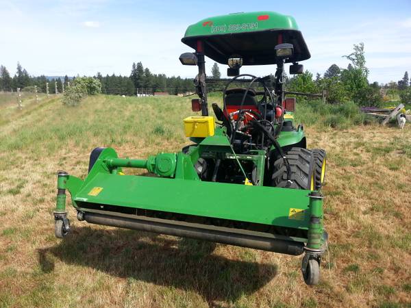

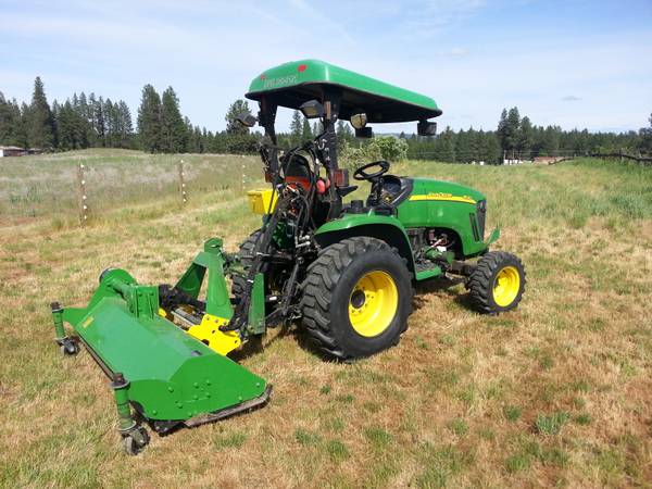

I really like this guys add on wheels. I think i would have used bigger ones but it's a start!
"Don't just mow your field grass or weeds. . ..mulch it with this Liberty 6' Flail Mower with hydraulic offset and custom mounting for John Deere I-Match or Quick Hitch system. Comes complete with grass and weed blades. I've also custom built casters for the mower for smoother operation. ALL flail mowers come with skids for ground contact (reason unknown) which causes the mower to dig into the ground, especially on turns creating tension on the 3 point system. These custom casters remove all the tension and create a much better cut. I'm only selling this mower because I'm moving up to a larger tractor and mower. This is a great unit. Come see it in operation" 6' Flail Mower

There is something fishy about that ad. He calls it a Liberty brand in one place and later calls it a Frontier. He has added casters which is pretty weird and the photos make the mower look new but he says he's moving up to a different mower. Sounds to me like it could be a Chinese mower with a dubious small time dealer. If it actually is a JD Frontier then it's a good deal but I have doubts.

Those casters would just dig grooves, and then you must ask why even have a rear roller? It looks like he did a nice job with the modification, but I can't see how the concept would be helpful. I have seen factory flails with large pneumatic tires in the back instead of the roller, and that works.

I agree although in our hard dry ground here the wheels likely wouldn't groove much if any. If i find what i want i will likely take the roller off as it would just get the crap knocked out of it due to our rocky conditions. I'll fab up some casters and use a solid tire like on a brush hog......

We have no rocks and loamy soil. It sounds like you have a good idea for your conditions. A steel roller would not fair well in rocky conditions.

I mow with a flail in New England. The roller certainly gets dented but it doesn't seem to affect function at all. Removing the roller would allow debris to be ejected out the back at high speed so I would avoid removing it if possible.
