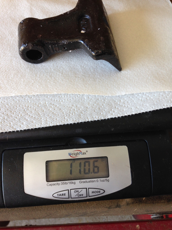

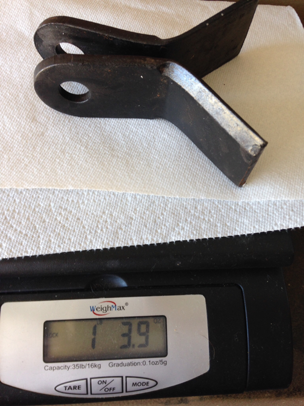

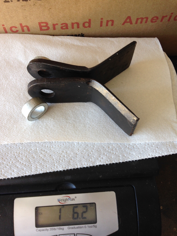

While I see your point, I do wonder. My thinking was that if balanced in opposing directions, the effect would be minimal if any. Is there a significant difference of equal pull in 2 vs 4 directions? Not being an engineer, I wouldn't know how to computer. Maybe Jack from China can get an answer?
So after reading your answer above, I decided to investigate further.
Weight of blades:
1 - Hammer = 26.6 oz
2 - Y w/ spacers = 22.2 oz
2 - Y only = 19.9 oz
That's 4.4oz difference per station, hammer vs Yw/spacers. (4 rows of 7 stations per row)
So if I had a heavier, 6.7 oz spacer they would be equal. I'm thinking I could probably get that weight making a spacer from my old, broken hammers with some trial and error.
Thoughts anyone?
BTW, wife has confirmed she likes the hammer cut better, more uniform.
Scale pics of blades:
David Sent from my iPad Air using TractorByNet

If it is balanced there is a uniform load on the bearings......which would be nil until one of the blades/knives/hammers or the roller strikes something....or departs

Thanks again Leon. Very clear example and I didn't have to send wife away LOL
So thinking again ( I know, I know...)
If I change the Y spacers to total 6.7 oz, then each station would be 26.6 oz, each row 11.64 pounds and each row even ( or nearly so, as I haven't weighed all the blades). I assume (silly me) the throw weight would be at the attachment points and no longer significantly different.
Right again as for the Y blades being on the dull side, hammers aren't any sharper :( .
I think another point, the hammer edges attack the grass horizontally and the 2 Y blades form more of a W. Due to the bolt thru the end attachment I doubt I get the airfoil effect you often write about.

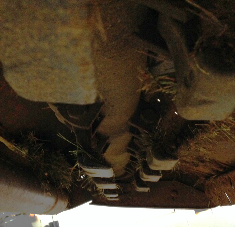

can you post a clear well lit image of the flail mowers rotor for me??
thanks

can you post a clear well lit image of the flail mowers rotor for me?? thanks
Take rotor pic is harder than I thought. If this doesn't do it, let me know.

Hello David,
The image/picture is fine. You will not get much suction due to the hammer knives burt as long as it works for you
I have two rotor wide air paddles on my flail mower and it makes quite a diffierence for a small flail mower.
Just be sure to check the welds on the blade mounts occasionally to make sure they have not developed any cracks.
Are there weights welded to the rotor to balance it????

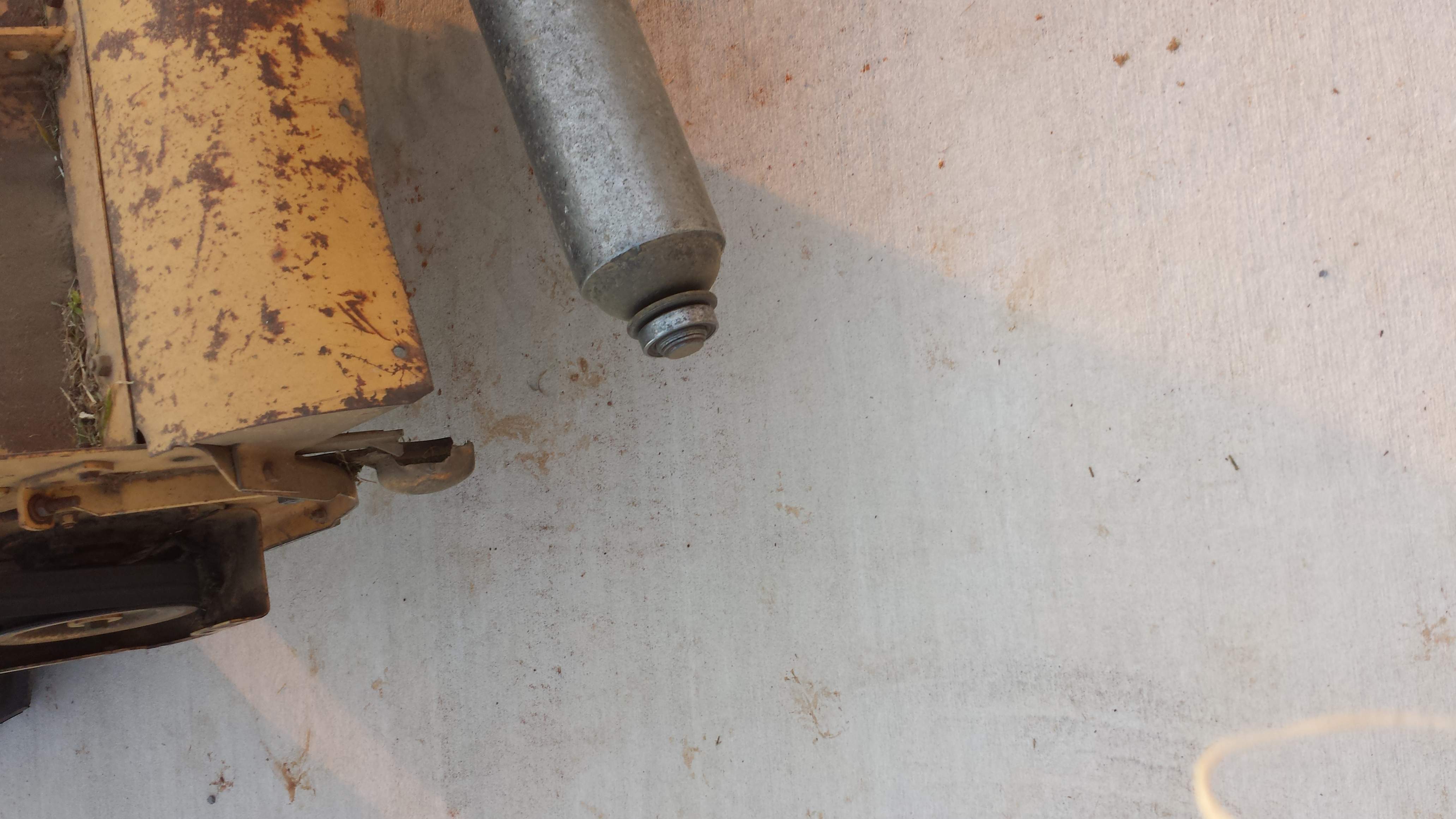

Well I broke it last night. The worn bearing housing gave up the ghost while I was cutting. Looks like the worn through area resulted in a stress concentration that fatigued. Decided to just go ahead and replace both housings and bearings. The RH housing was only $50 but the broken LH housing has been supplanted by a BushHog manufactured part and is double the price. At least I was able to cross reference and track down bearings for $14/each instead of the $50 NH wants.
