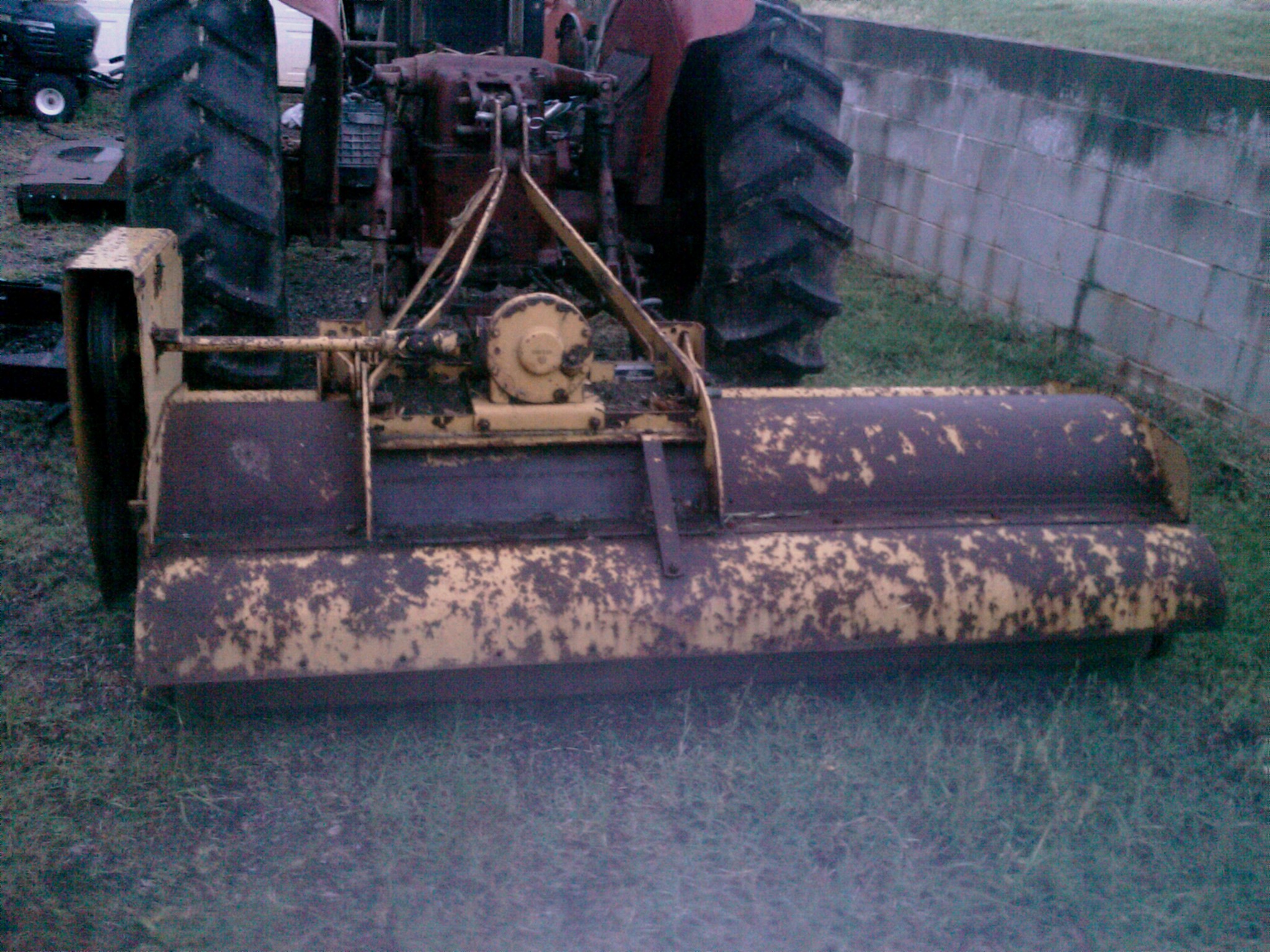

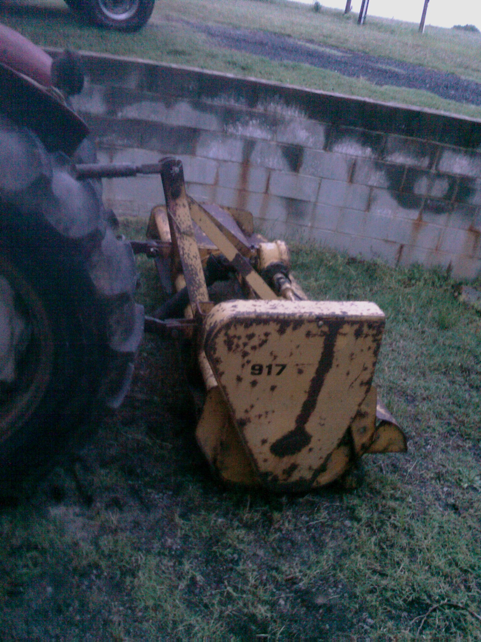

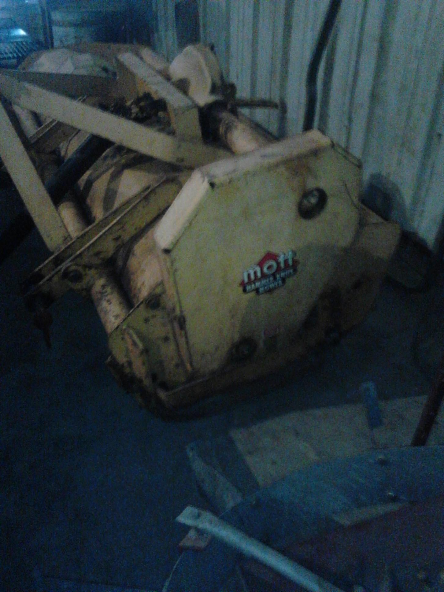

I'm looking at an older Mott flail. Anyone recognize this machine? I'm told it is 6 1/2 feed wide with an offset mount. Thanks!
