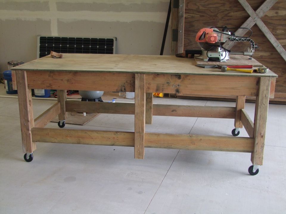

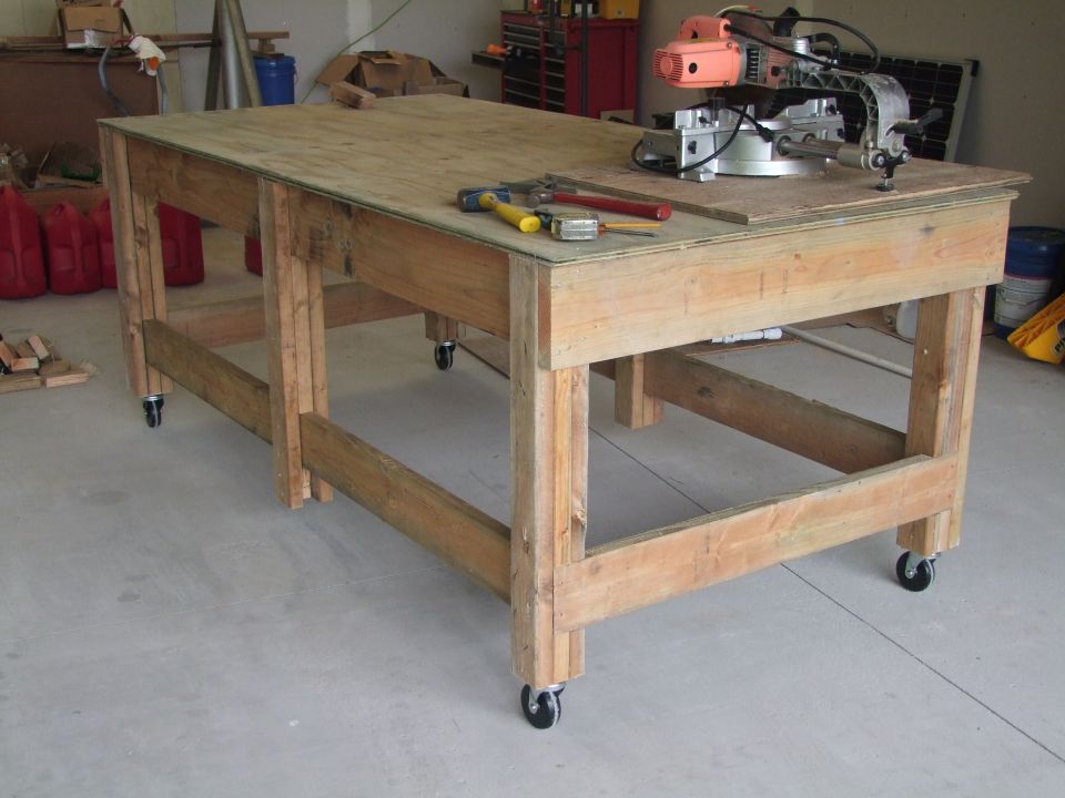

I have a Mott 72 with 92 pair of blades. I replaced all of them in 6 Hours and the pins are held on with carter pins instead of nuts. So 33 pair shouldn't take that long. I do have a heavy duty rolling bench I put the flail on to do the work so I could work standing up.
You wouldn't have a picture of that bench? I've wanted to build some sort of working platform for my Caroni 1900.
Thanks, Nick
/ Let's talk flail mowers #1,652
Here you go. It is built to hold up to 1,200 lbs
