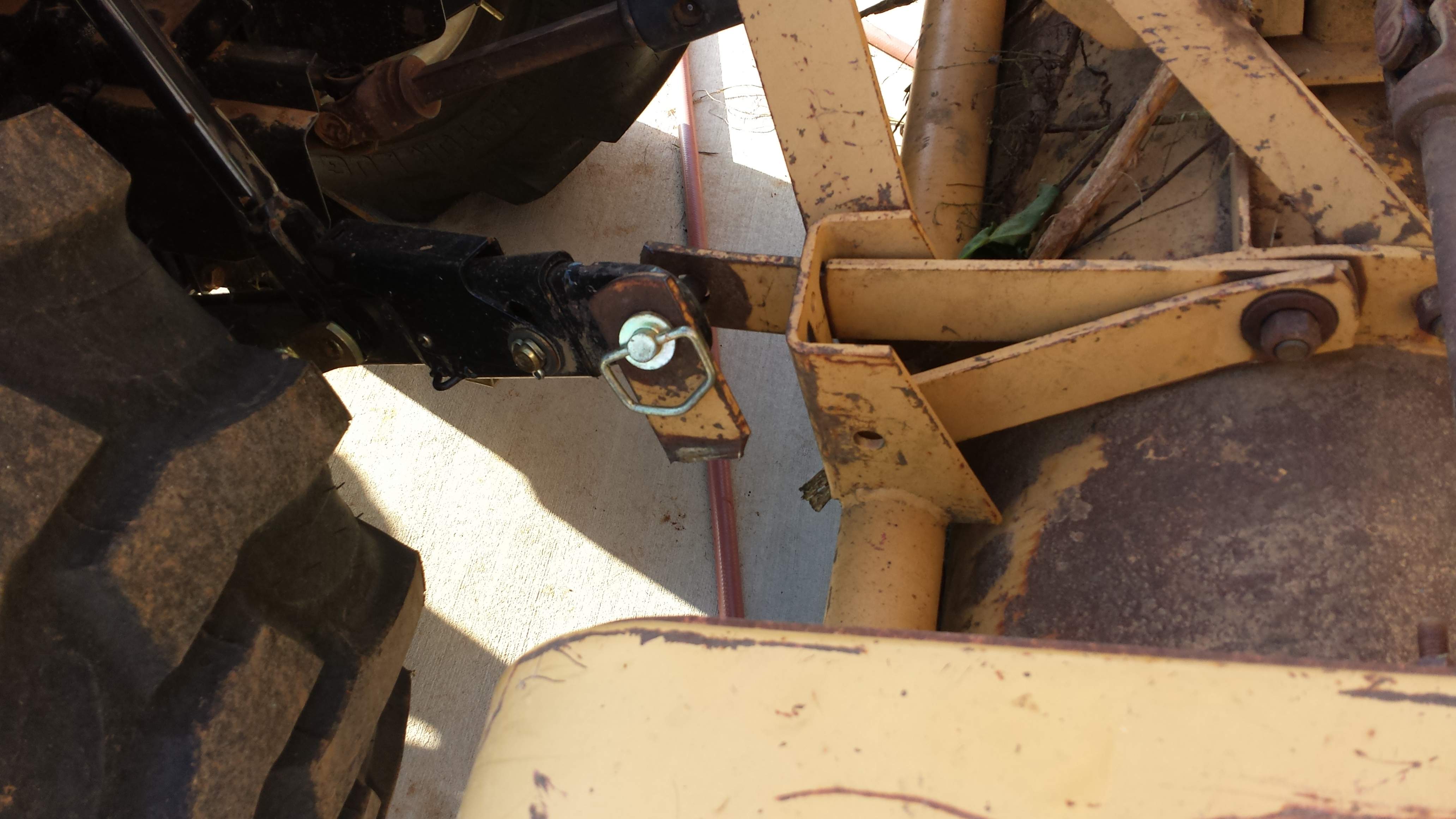

Man, broke the 917 again this past friday. Apparently I'm rough on equipment. Least it failed right at the point I was finishing mowing. Should have a few weeks before it needs it again.
One of the lift links split right where it comes through the frame. Looks like it was welded for the same failure sometime in the distant past. Since the previous weld lasted a good long time, I may try the same rather than dropping $ on a part.
You could weld the link but considering it's just a piece of flat bar with 2 holes in it, why not just make a new piece?
Mainly due to a lack of time. The two outside links have bends in them. Estimating the time to correctly reproduce the part, I just don't think it's worth it to save $60. Time spent in repairs is time I'm not spending with my wife and son or doing productive work so to warrant spend big time on a repair, I've got to save big $.
Considering it's one bolt that holds the thing on, I'm really tempted to not even bother with a weld because at that point it's a 5 minute repair job with a new part...
