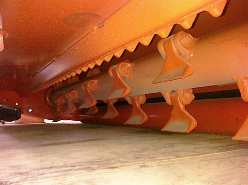

/ Let's talk flail mowers #1,759
Hello! New member here with a question about an Alamo flail mower I recently purchased. I knew absolutely nothing about flail mowers prior to this and I'm still trying to figure out exactly what I have. I do know that it's an Alamo brand 7' flail with a rough cut shaft. I know it's a shd88 and it was previously a commercial unit (maybe road crew?). It's been sitting up a few years but is in decent shape with all components moving freely. It was missing one clevis so I purchased it and the blades from flail-master last week (awesome company). What I'm trying to figure out now is if I have a normal cutter or a reverse rotation cutter. I'm hoping someone can tell from these pics. ThanksView attachment 392286
View attachment 392287View attachment 392288
Easiest way to tell is to simply raise the mower while running at low idle and (carefully) look. Another way is to check the blades. What side are the nicks/gouges on? That is the leading edge and will tell you the direction of rotation.
/ Let's talk flail mowers #1,760
Mower looks to be in good condition. Surprised there seems to be only a single belt running a 7ft mower though. My six foot Caroni has three and still manages to slip/burn up belts every once in a while.
