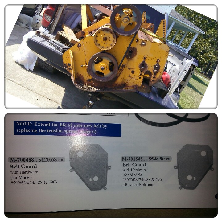

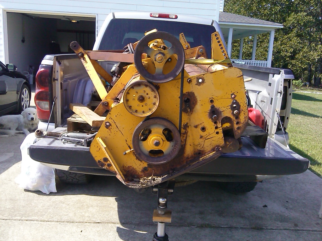

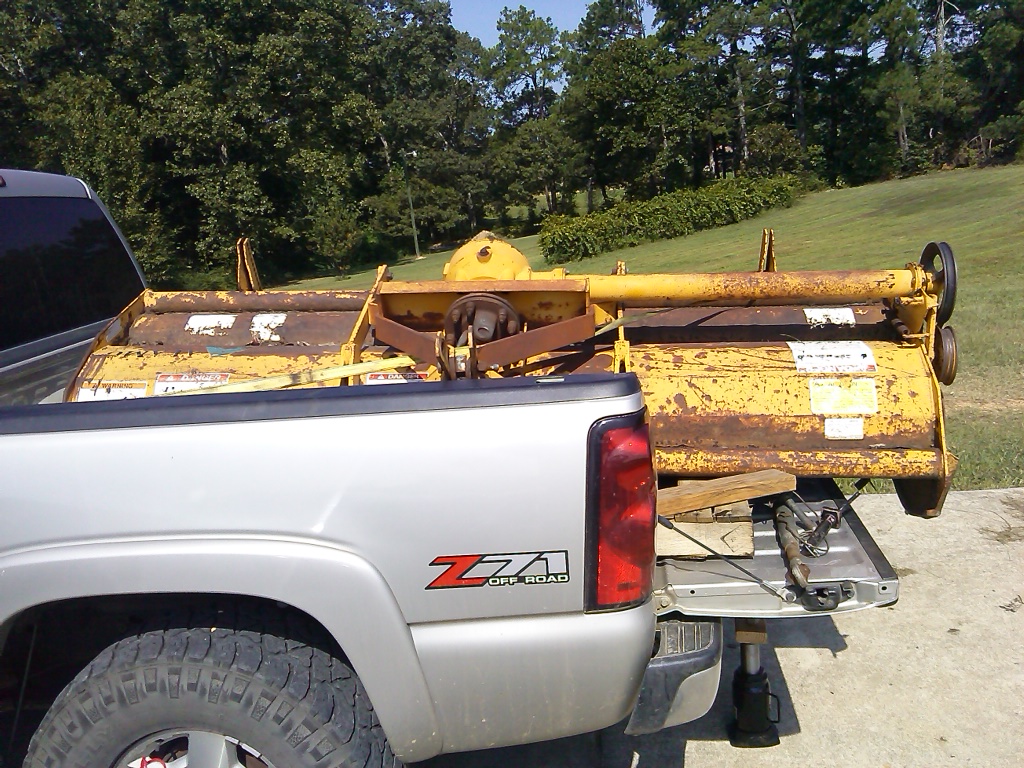

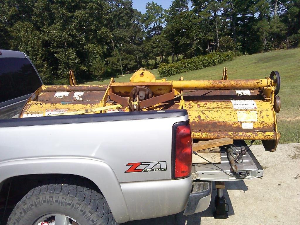

Hello! New member here with a question about an Alamo flail mower I
recently purchased.
I knew absolutely nothing about flail mowers prior to this and I'm still
trying to figure out exactly what I have.
I do know that it's an Alamo brand 7' flail with a rough cut shaft.
I know it's a shd88 and it was previously a commercial unit (maybe road crew?).
It's been sitting up a few years but is in decent shape with all components moving freely.
It was missing one clevis so I purchased it and the blades from flail-master last week (awesome company).
What I'm trying to figure out now is if I have a normal cutter or a reverse rotation cutter.
You have a clockwise rotation(when looking at the left hand side of the flail mower) flail mower rotor.
Forward discharge flail mowers are either mounted in firectly in front of the tractor or side mounted hydraulic units.
I'm hoping someone can tell from these pics. ThanksView attachment 392286
View attachment 392287View attachment 392288
You need a new belt guard and the rear caster wheels. They help support the flailmower to
maintain a level mower to reduce scalping.
You do not have a reversing gearbox to permit it to rotate counterclockwise.

I know it's not a forward discharge but I think it may be a reverse rotation drive. I was looking through flail masters catalog and saw the 2 belt guards available for my mower. One is a standard and one is for the reverse rotation. Looking at the way it would mount, the rust lines from the old guard, and the pulley positioning has me believing its reverse. 20140928_105611-kdcollage.jpg

If it was reverse rotation drive you would have both right angle gearbox and a
reversing gearbox that rotates the rigth angle gearbox.
Flailmaster needs to amend the notation in the catalog as the guard fits the
hydraulic drive units too from what I remember.
No worries just buy the PTO shaft, caster wheels, the belt guard, change the belt and oil
dig out the buried grease fittings do not pump any more than six shots of grease in the flail mower rotor bearings.

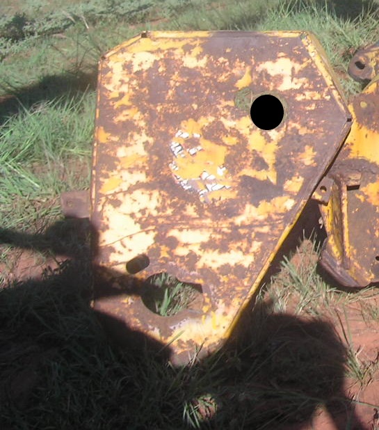

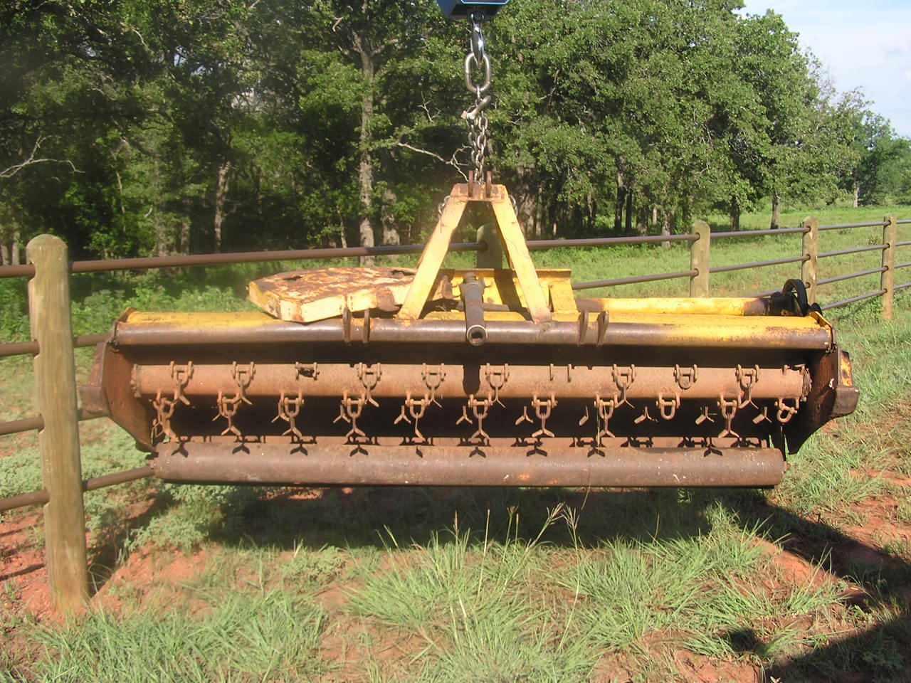

I know it's not a forward discharge but I think it may be a reverse rotation drive. I was looking through flail masters catalog and saw the 2 belt guards available for my mower. One is a standard and one is for the reverse rotation. Looking at the way it would mount, the rust lines from the old guard, and the pulley positioning has me believing its reverse. View attachment 392349

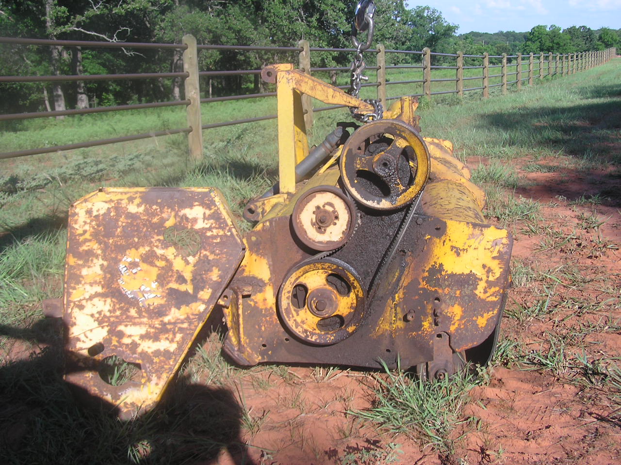

Here are pictures of the Mott that I used to have.
Here is a close up of the cover with the top hole made black to see it better.
It matches the reverse rotation cover that you posted.
Since idler pulleys go on the non pulling side of the belt, it looks like the rotor rotates counterclockwise.

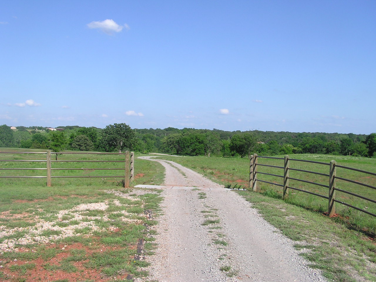

thanks for the pic xfaxman. thats a nice looking fence you got there. you work for a pipe mfg company? lol
/ Let's talk flail mowers #1,773
Your're welcome.
Nope, I am retired, the fence is made by Priefert, called Ponderosa.
