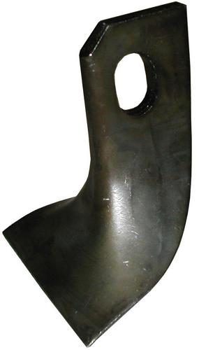

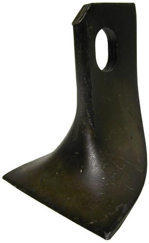

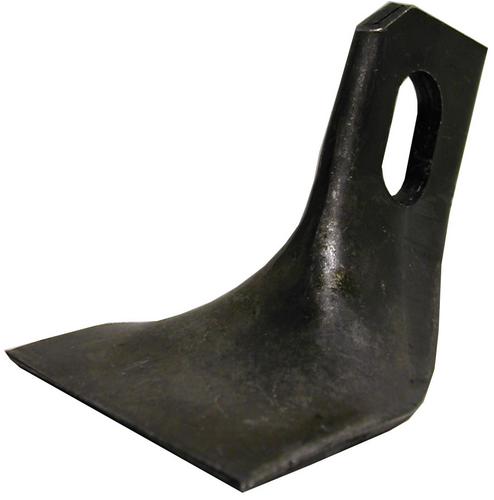

Just got my shipment of new heavy duty "y" knives from flail master. I was expecting them to be sharp like a rotary mower blade, they are not. They have a very small radius edge. Is this the norm or do I need to sharpen them . Fail mowers are new to me, so I would like your advice. Guess the ones already on my used JD 370 are not that dull after all. Just thought new blades would have a sharp edge. For future reference, would flush cut knives be better if mainly cutting grass and pasture land. It is all pretty well rock free. Thanks to all for the info.
/ Let's talk flail mowers #1,786
No need to sharpen them. I use the same Flailmaster knives. I am not sure about finish mowers but the flail blades are definitely sharper than a typical bush hog blade. The flailmaster blades are just as sharp as the factory Caroni blades.
I don't recall the comparative feet per second of blade speed compared to a rotary mower but that certainly is a factor in how well flails cut. Maybe Leonz will enlighten us. I believe he has a direct 800 line to the flail Gods.

2,000 plus revolutions per minute depending on the V Belt pulley size and rotor diameter.
the rotary mower comparison is almost 13,000 feet per minute and that tears the grass and brush.

I'm spinning the scoop knives which were also blunt at the edge when new. In agreement with Island Tractor and leonz there is no requirement or need to sharpen them. My Vrisimo drum turns at 1850 RPM and the blade tip speed is 10212 FPM. I keep up a 5 acre lawn and the cut is near that of a golf coarse. The scoop knives are only rated to 1" saplings but it will do all of that and then some, turning brush into mulch. Although not as aggressive as the Y knives the scoop knives leave a better finish. The only draw back is that with the added lift they tend to stir up more dust in bare ground areas.
Yep, exactly right. I keep 8 acres of park like grass mowed with my Vrisimo 10' flail with scoops. And you are correct about driving over a bare area....it stirs the dust up.

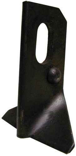

Which type of cutting blade do you have? the side slicer Y blade Pairs or single duck foot/scoop blade.
There are several suppliers/manufacturers of flail mower knives here in the United States.
