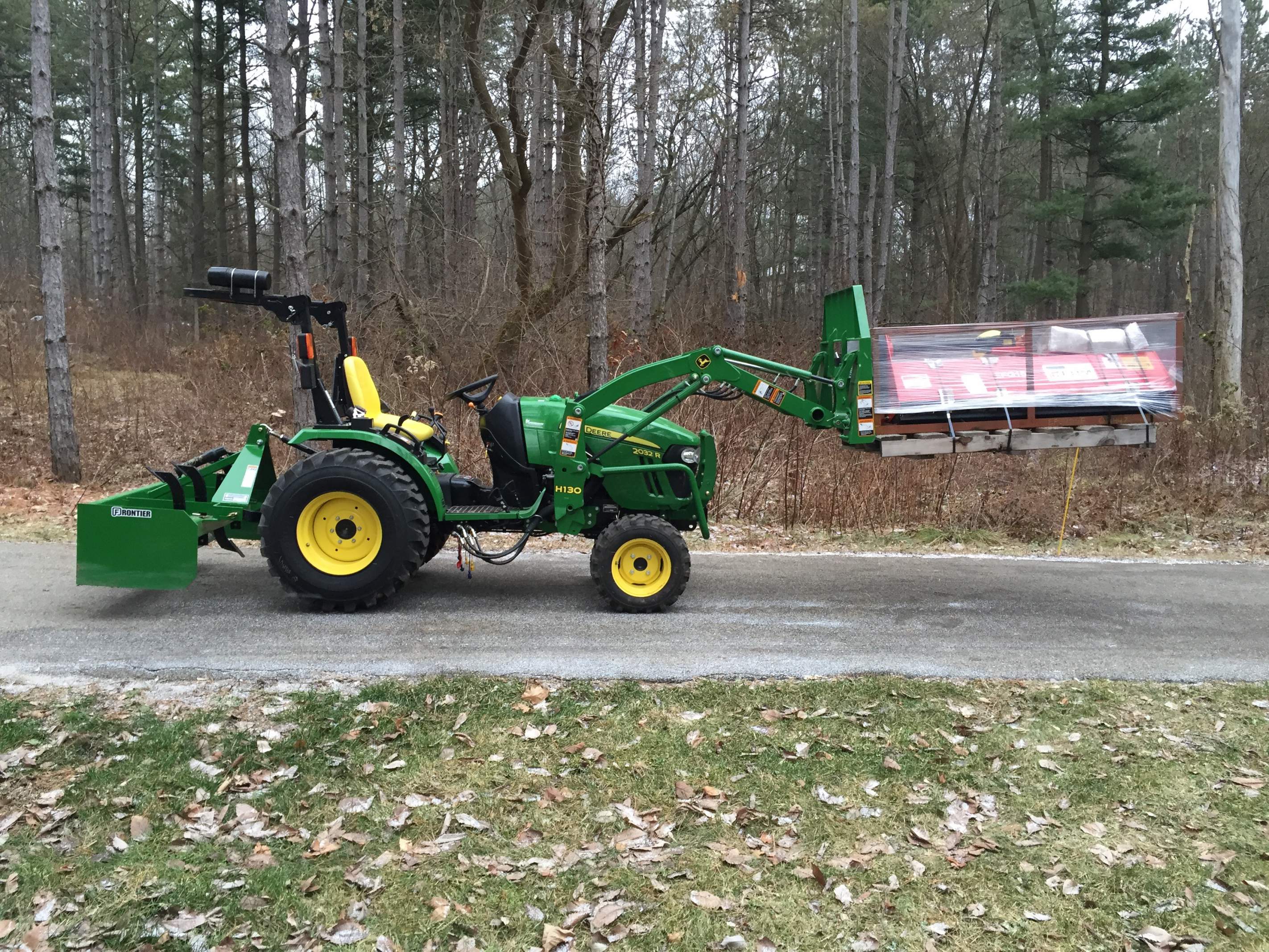

It's here! It's also snowing here, but I will still try to get it together and run it for a little while this weekend.
