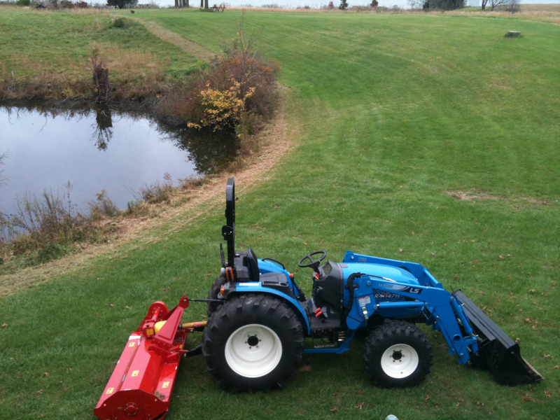

Okay I got my new Caroni fail mower attached to my LS 4047 tractor, but ran into an issue with the 3pt attachemnt. The pins for the lifting arms are attached to the mower with two pins. Problem is I have to pull the front pin in order to get the mower to touch the ground. It looks like this should be fine, but I wanted to see if I am makinga big mistake... Any advice is appreciated
Can you post a picture or two ?
I got the side shift kit with mine and don't have a problem with it on any of my tractors.
I still have all the parts for the non-side shift assembly, so I might be able to understand what you are running into.
I vaguely remember some "opportunities for incorrect assembly" due to slightly ambiguous instructions/diagrams, but please post pictures.

Island tractor, thank you for the picture, and you nailed what I am talking about. I am going to try o elongate my lift rods to see if I can make up the difference. Between and Italian mower and a Korean tractor, these instructions are far from clear... Why do I get this bad feeling that this is only the beginning of my issues with this combo!
I guess I am still wondering why the those tabs (with the two clevis pins) are in a heavy duty housing that looks like it is designed to allow movement.

OK, I now see the 2 clevis pins at each lower arm connection point; forgot it was set up like that. You should definitely not have to remove one of those pins to get the flail to sit right, including lowering it all the way onto the ground.
You need to adjust your tractor's 3 point hitch arms. Look at the back of your tractor where the 3 point hitch arms pivot. Now look out along the arms to where the vertical (or near vertical) rods lift those arms. Somewhere around there on the lift arms should be a way to adjust them, so that the height range your 3 point hitch can travel now can be lowered. After making this adjustment, your 3 point hitch won't go as high, but it will go lower. And if you need to put it back for another implements, you can do so. I had to do this to get an auger to drop all the way down. Before adjustment, the auger would only dig about a 1-foot deep hole, due to the 3 point hitch being adjusted to a higher range position. After adjusting it down, the auger would dig a 3' deep hole, maybe even a little deeper than that. A small adjustment of the 3 point hitch arms can make a big difference in how high or low your 3 point hitch can go.

Don't worry about being alone in having trouble setting things up. I had the topping lift structure mounted backwards for a year before I figured out it was wrong!
I suspect that the clevis pins are used (which makes the tabs free to wiggle just a little) because it allows quicker set up when you choose to offset the mower (note there is a second set of recepticles). However, as the topping lift structure is secured by about a dozen or more bolts, you need a wrench and socket set to move it anyway so I don't understand the benefit of making only the tabs easier to move. I suppose it might be possible to leave the topping lift structure in place and just quickly move the tabs but I've never tried that. I suspect that is what the hydraulic shift kit does (functionally) as I am pretty sure the lift kit doesn't move the whole topping lift structure. But, this begs the question of why there are two settings for the topping lift structure.... Who knows?
In any case, I think the solution to your immediate problem is with the setting of your lower control arms on the tractor. Bebbington is on the right track.

Finally have it up and running... I am having a blast with this mower so far!

you CAN run with only one pin. it is setup like that so the mower can articulate side to side independantly of the tractor. I.E. one rear tire drops in a hole and with it pinned rigid the mower will either dip too or lift the other side up. with one pin it can "float" indepandantly of the tractor.

We got some snow, but it was only an inch or so. I didn't have many spots where I even had wheel tracks. I have the mower shifted so I can get out over the edge of the ponds, and it's fun to watch it turn into nothing. I did notice that when I was mowing my normal grass that I was getting groves from the flail, like stripes. I guess I need to lower the side skids to prevent this. The good news is I don't have to worry about dethatching now!
