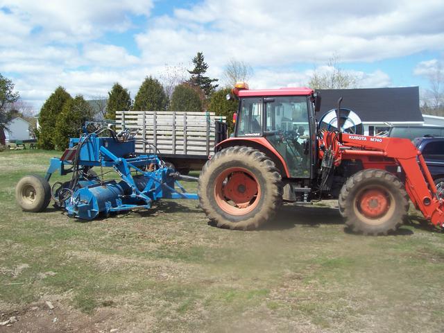

The EFGC model number is the same used by Value Leader (Betsco) who sells on ebay. I have one of their smaller 48" (EFGC125) and find it to be very heavy duty. I've used mine a few times for clearing brush and am very happy with it. These are Chinese made flail, but appear to be well made.
This is a picture of my son (he does have ear plugs on) going through some brush on our property. The cleaned up foreground was as thick as what to see behind the tractor. Good luck
