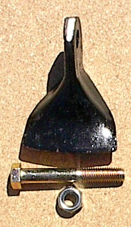

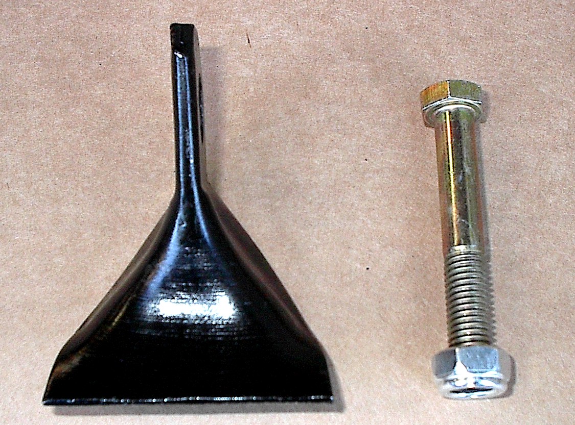

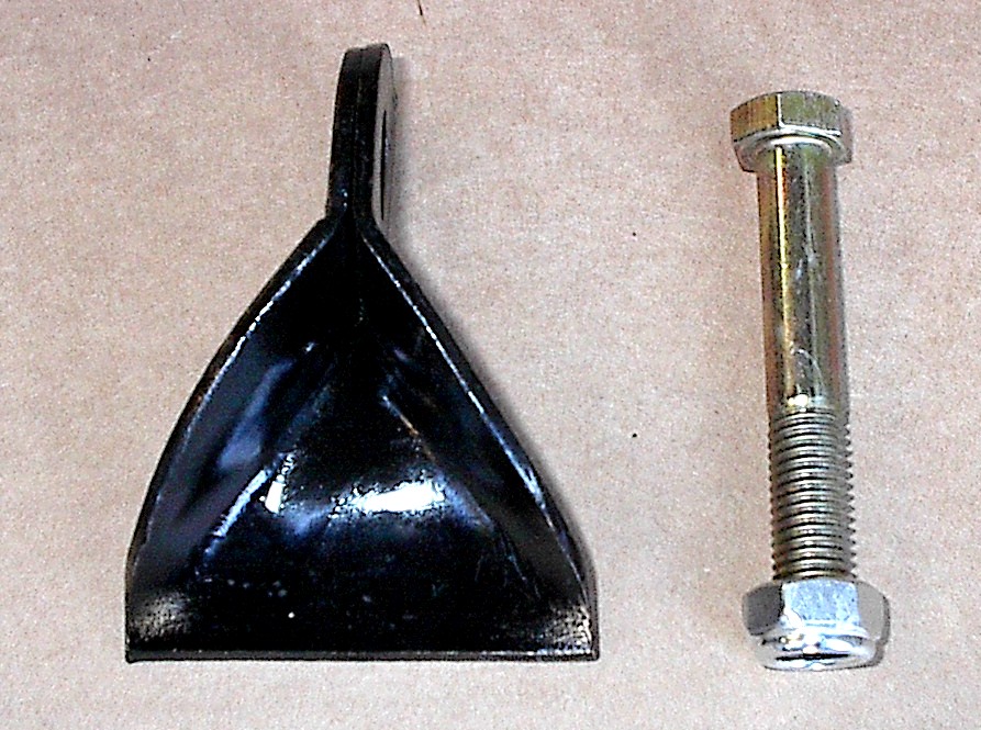

OK I'm getting closer with specs for the flail mower I'm going to build.
Now the big question, Y knives or hammer type blades, from what I have read it seems that the Y knives may use a little less power and I only have about 20hp at the hydraulic motor. Of course it's easier to fabricate the shaft with fewer blades so that's also a plus for the hammer blades.
The other knife related question is layout on the shaft, seems that some have a spiral arrangement and some have opposing blades seemingly at right angles to each other or at 12, 3, 6, and 9 o'clock. If anyone could describe what they have I'd really appreciate it.
Some of the companies quote percentage overlap of blades and that can go as high as 45%, I'm much more concerned with brush and paddock cutting rather than finished lawn so my priority is efficient power use and a pretty robust setup rather than perfect finish.
Any wisdom gladly accepted, thanks all.
