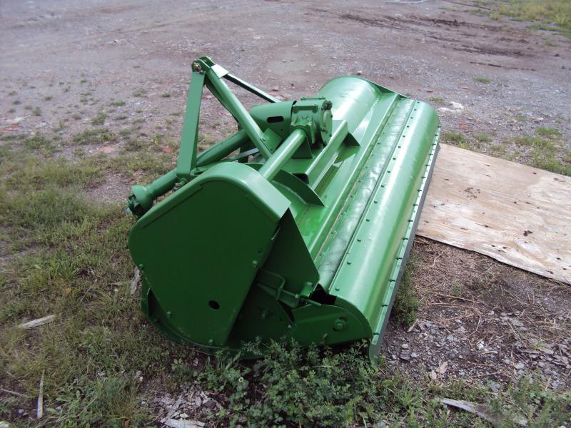

After I've read most of the posts in the section I decided that a flail mower is a must have item.
I've been looking at used ones and the one below is a possibility. My question is are the knives that are on it are smooth cut right? I mostly need the machine to mow a 25 acre field once a year to keep the brush down. I have a bush hog for the thick stuff, but I can I switch the knives over to rough cut? (one time only of course) I called flailmaster.com and talked to them and their reply, from the lady that I talked to, was "probably". Is the 25a rotor balanced for both sets? And what would happen to the knives if I used them for heavy cutting? I have a JD 990; think 35 pto hp.
Thanks
-Aaron

Looks like a nice mower. I'd suggest using the existing knives if you are mowing at least once per year. Should do fine even though those are technically fine cut blades.

Hello aaron14011,
The flail mower you are
examining has what is
referred to as a scoop knive.
The scoop knives are stamped
bent and formed to create
their scoop shape and the folded
end which is mounted on the
D ring using a U plate to secure
the D ring in some models
Another example using the scoop
knive is the Caroni Flail Mower
using the P rotor wherein the
scoop knive is secure using a
hardened steel shackle and
secured with a bolt and nut.
The unit you are examining
apparently uses a D ring that
is bent into the weldment to
secure the scoop knive to the
rotor.
The scoop shape with the wide
base slicing edge permits the
flail mower to have fewer knives
mounted on the rotor and also create
a full width of cut/slice using a rotor
with overlapping knive edges creating
a nice finish turf.
The rotor is balanced for the scoop knives.
You can use a hardened scoop knive also as long it
is the proper scoop knive and the hardened scoop
knives are used to replace the entire existing number of
scoop knives on the flail mower rotor if desired.
If you use the existing knives on the flail mower
for the mowing you should plan on having identical
spares to replace the ones that become damaged
to maintain a balanced rotor
You need to have spare D rings and U plates as
well as nylock nuts and hardened bolts for the
U plates.
As Island tractor has said there is no reason you
cannot use the mower once a year for mowing.
My father used a newer JD25A with a 7 foot cut using
the Y blade grass slicers and I wish he had not sold
it as it was a perfect turf mower.
