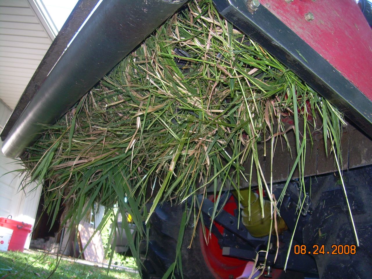

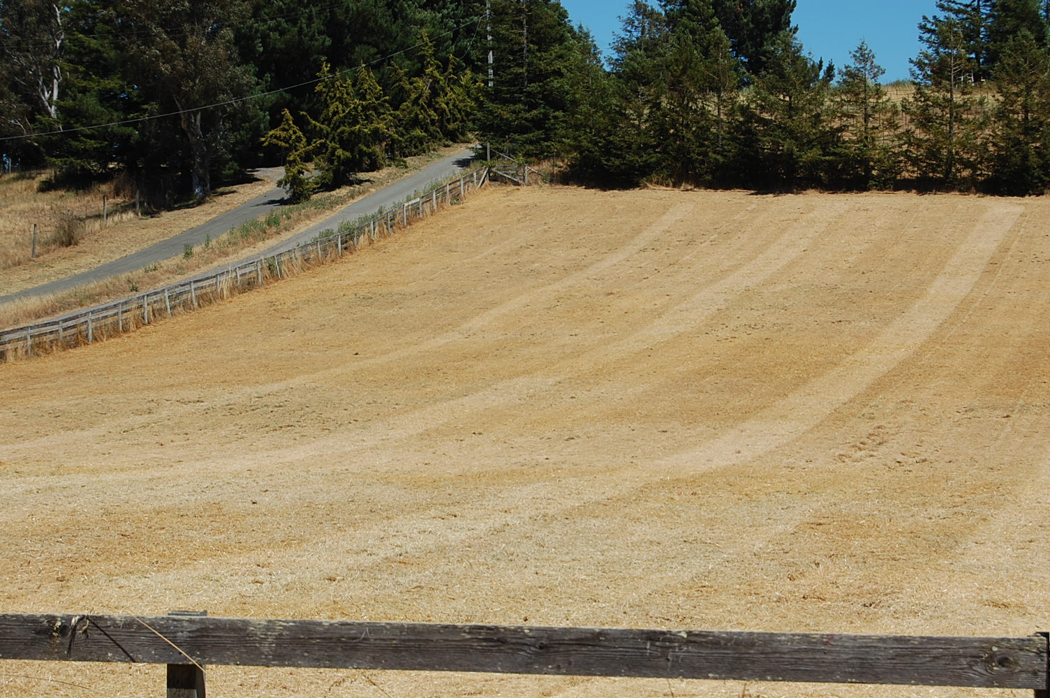

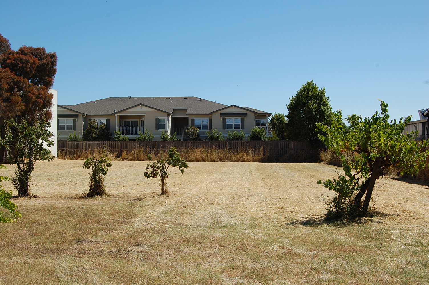

I own and use two Caronis for the past 6-7 years now, 1600"F" and a 1600 "B". My main "money maker" is the "B" rotor which is more universal (48 blades) and gives a great finished look and I constantly cut thick tall vegatation up to 7' to a finished cut of 2". The "F" rotor, with 96 blades total, I use for second/third mowings or on land that has sparse or thin grass/weeds. I've tried using it on tall/thick stuff but with so many blades to recut the grass/weeds it tends to jamb up the rotor which leads to belt burning BUT if you go at very slow pace it could be used.
I've included a few pics as to what the "B" will achive.

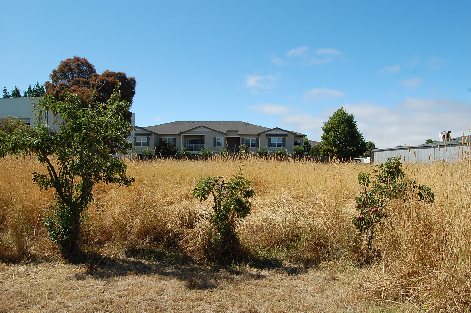

What are your opinions on a TM1900 BSC behind a New Holland TC25D? I called Agri Supply about a TM1600 BSC, they called Italy to get a price/timing and came back with a 6 month delivery time. I can wait a month and maybe stretch it to two, but no way I can go beyond a two month wait.
I know my tractor has a small motor at 25 HP, but it has a 22 HP PTO. The motor to PTO ratio is really good on this tractor by comparison to other tractors. I know some of the Mahindra 28 HP tractors only have 21.7 PTO HP. I wish Caroni didn't rate by motor HP because that just muddies the water because of the variety of transmissions.
I have 14 extremely overgrown acres of rolling pasture (most spots are 7 feet tall; you can actually lose you pickup if you aren't careful) to maintain. After the first cut, I will be cutting it monthly thereafter during growing seasons. The field is mostly alfalfa, clover, tall fescue (K31), and the tall stuff is some kind of grain, maybe rye (I'm not sure, just that its a grain). It has been a hayfield since before I was born, but now its going to be site to my new home and personal playground.
So could my little tractor handle the TM1900BSC if I slow cut this first time and then cut monthly thereafter (probably nothing taller than a foot then)? Or am I just asking for lots of trouble with this line of thought?
