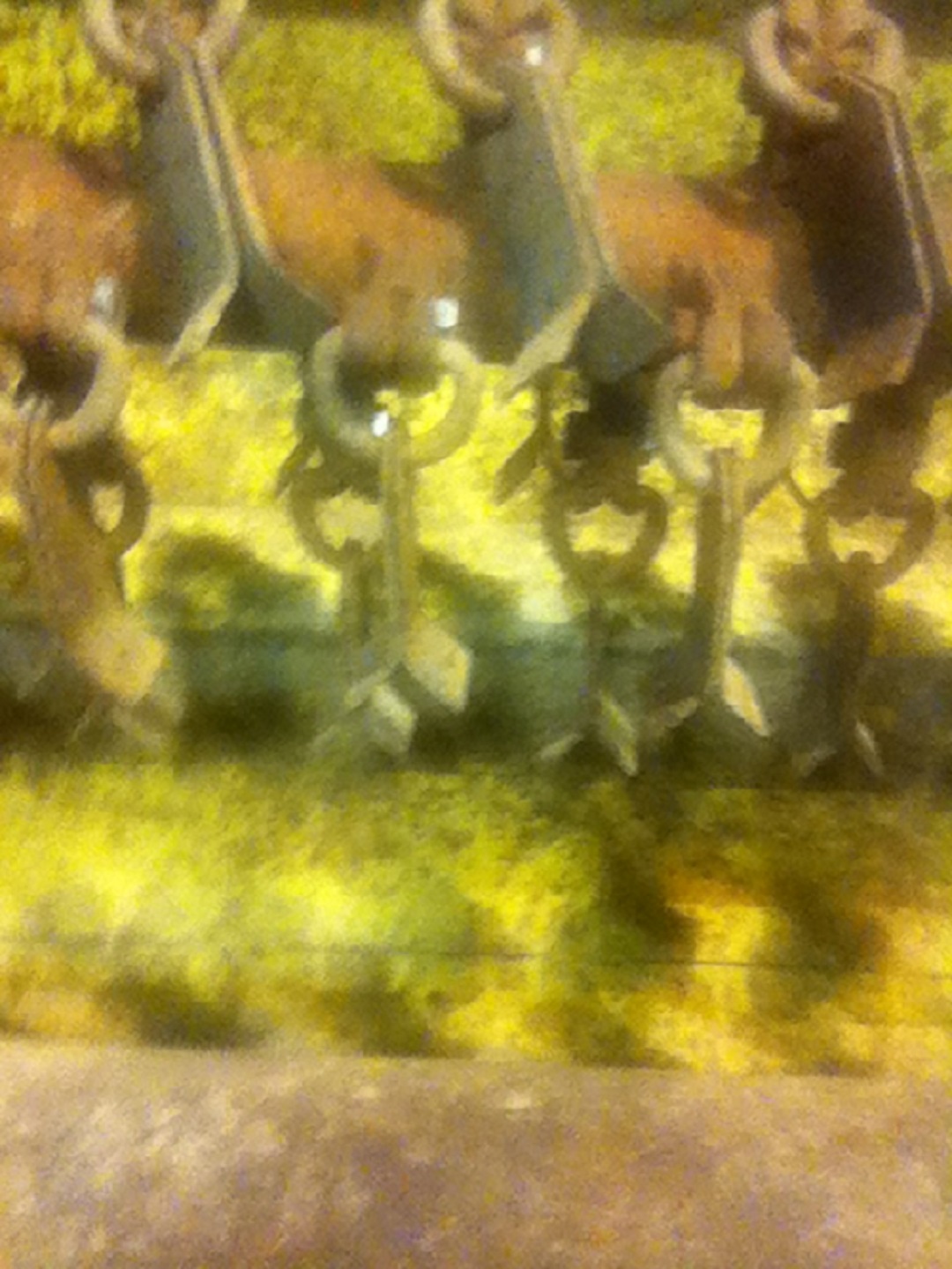

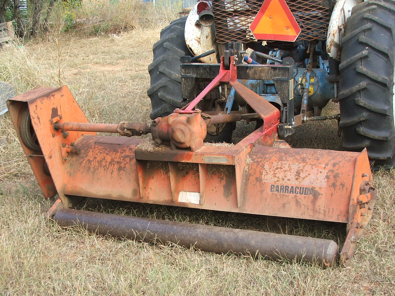

My flail uses the spoon type on a D-ring. It will throw one or two occasionally on stuff that shouldn't be in the grass/weeds--Like rebar or pieces of cinder block. If I hear it and find them, I'll sharpen them and put them back on before the next cut. I can feel a little vibration if I loose more than about two.
I've rolled up about 100' of barb wire and a few fence posts before. That was a lot more nerve racking that throwing a cutter. :oops:
Mine is an old Giant Barracuda I picked up at an auction for $35. I got it cheap because no one knew what it was. :giggle: It will get a make over after I finish the tractor and a couple of other implements.

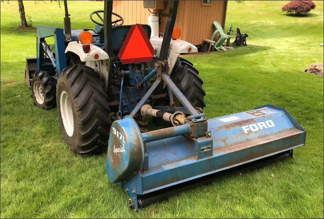

I bought this Ford 917L last year for few hundred bucks and after set on new flails + bolts, rebuilt belt idler pulley, new PTO drive shaft, new gearbox shaft seal, new belts and new roller bearings it is working very good!
Al together perhaps $350 worth of new parts but at least the labor was free.
It is the perfect match with my Ford 1310 tractor and the exact model I wanted so I did not mind doing the repairs.

That's one ugly looking mower but, it looks like it is indestructible. Paint it blue!
Better than my $100 917. Mine had paint but lots of dents on the hood & other obvious issues.

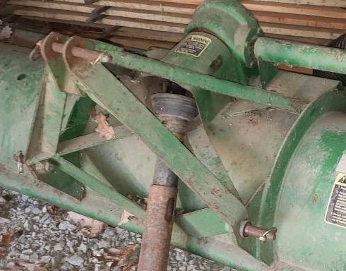

That pic is from Deere site.
Here's the one I'm looking at

If it won't fit fab it up and make it fit. I've had to modify all of my implements to fit mine except my bush hog.
/ Let's talk flail mowers #7,058
doesn't look like your top hook will slide under the top pin but the yoke adapter mentioned above would work. doesn't look like it would be too hard to extend the pin hole out a little so the top hook clears that bracket under the pin hole, If you can weld.

This pic looks like the top pin has already been modified once with a blue wrench. And the rear stays appear to be tubes. Definitely different than my 25A.

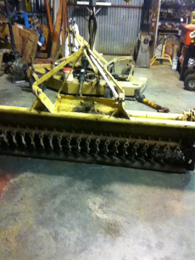

Heres a pic of mine. The front uprights on your pic are made from angle, mine are a wide flat plate. On mine, the QH top hook can get under the pin if it is all the way forward
