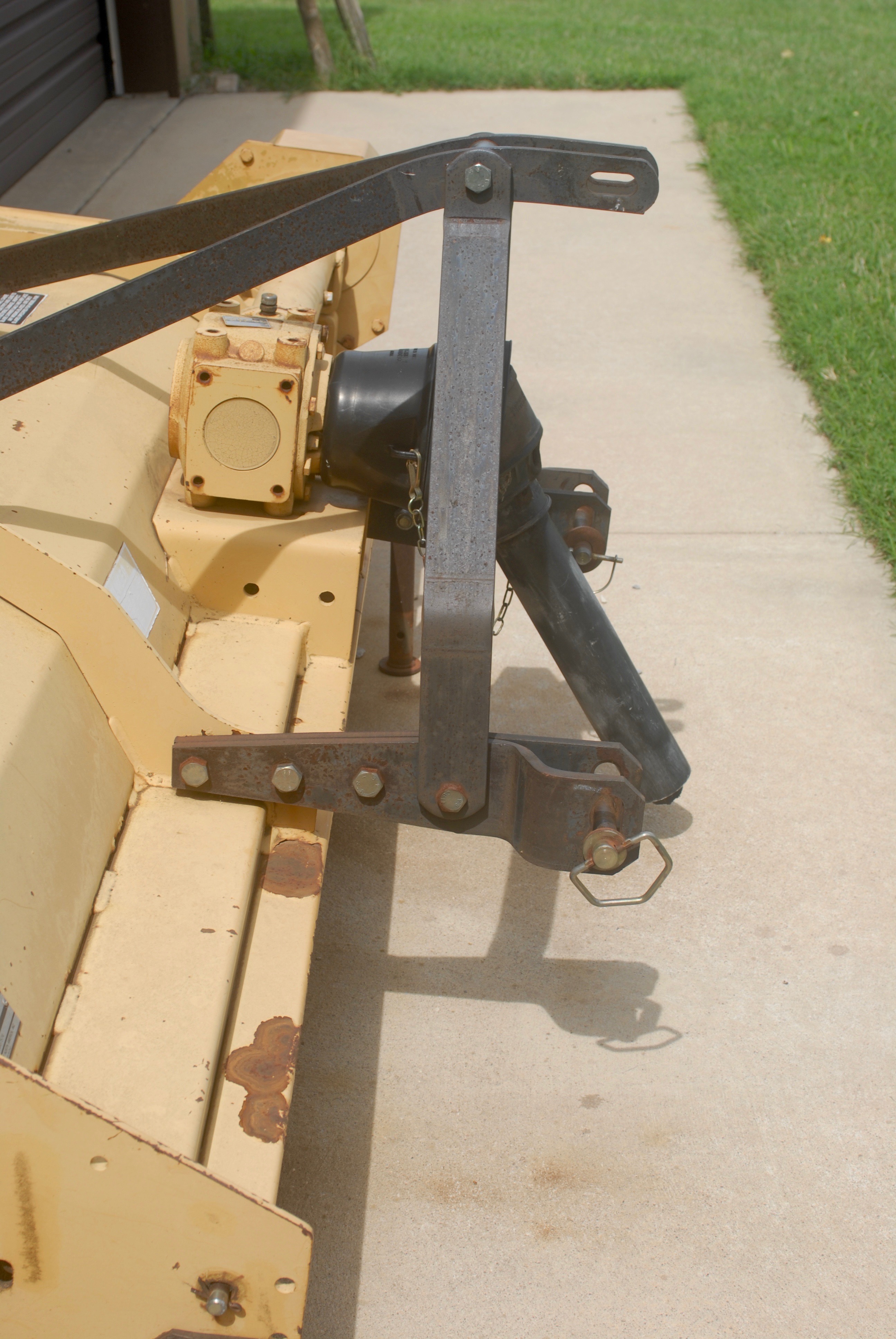

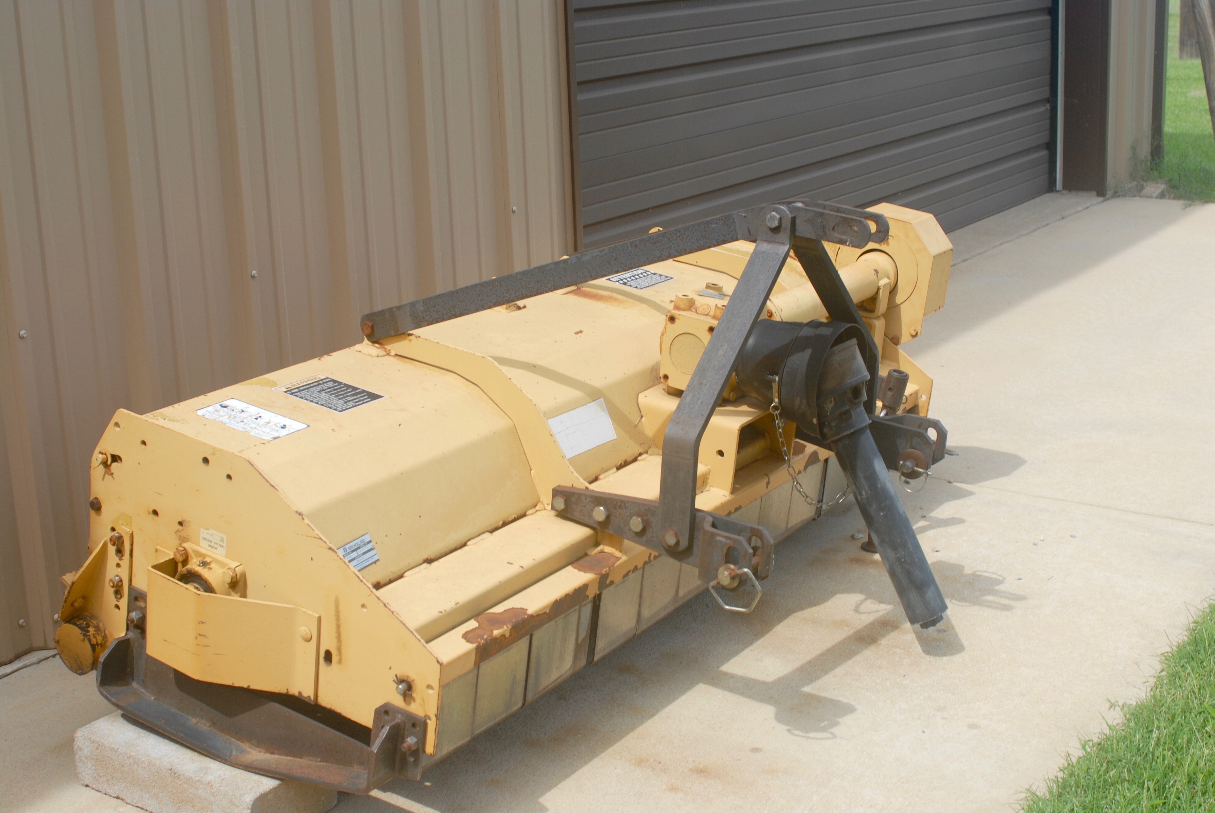

I found a ford 907 flail 6' wide for 150 bucks. Seller says it needs a bearing and the belt is a little worn. Looks to be complete except for one of the knife assemblies. Its rusty so would need a good cleaning and paint job or minor restoration. Worth picking up? Its been for sale for a long time so I think i could snag it for under a hundred.
/ Let's talk flail mowers #7,037
If you have the time and tools to work on it you will be fine with a great flail mower.
I believe you can still obtain parts and manuals from messicks for it.
/ Let's talk flail mowers #7,038
That's a good price, even if it does need bearings. Make sure the rotor isn't bent and the roller is somewhat straight.
