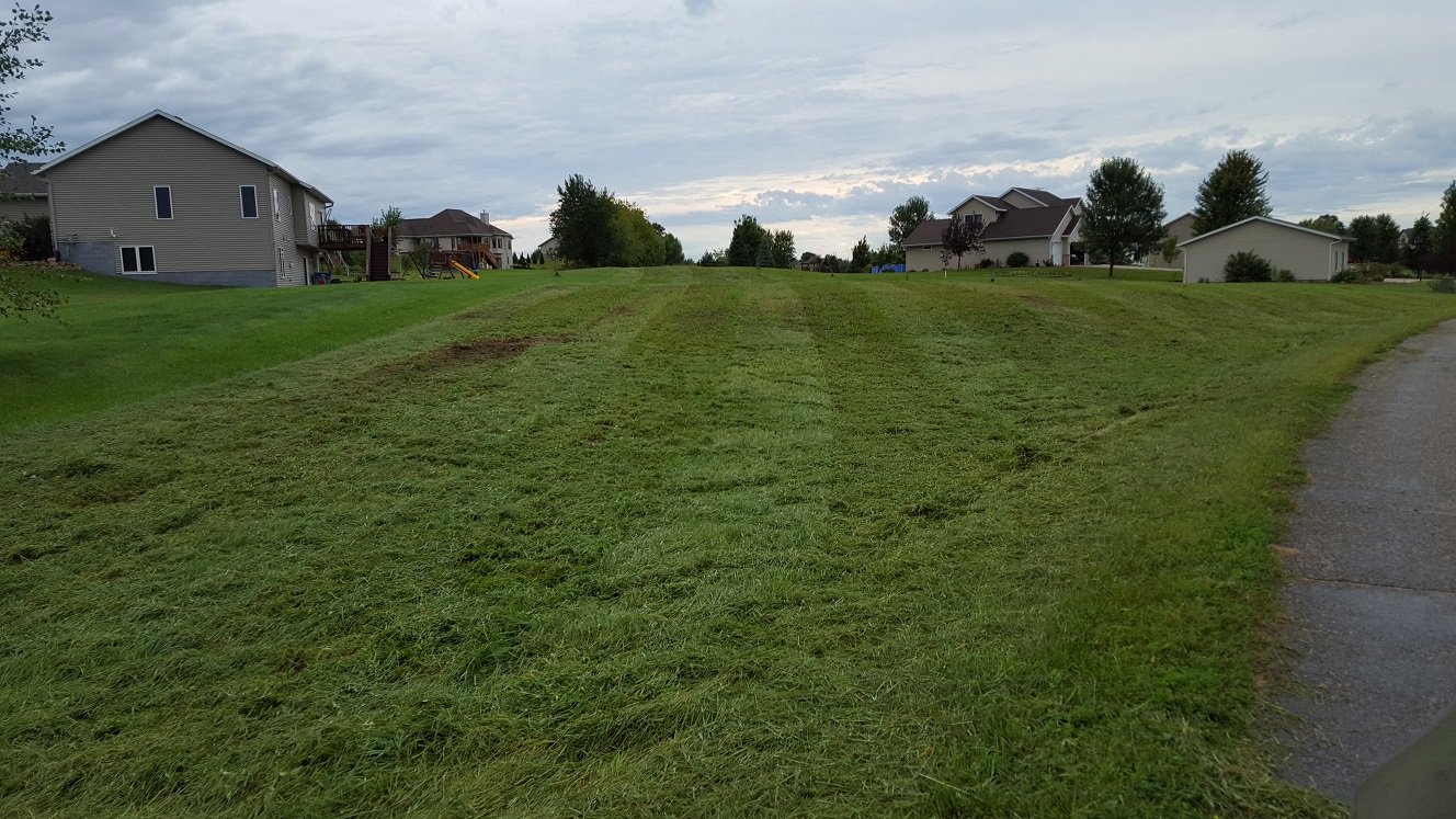

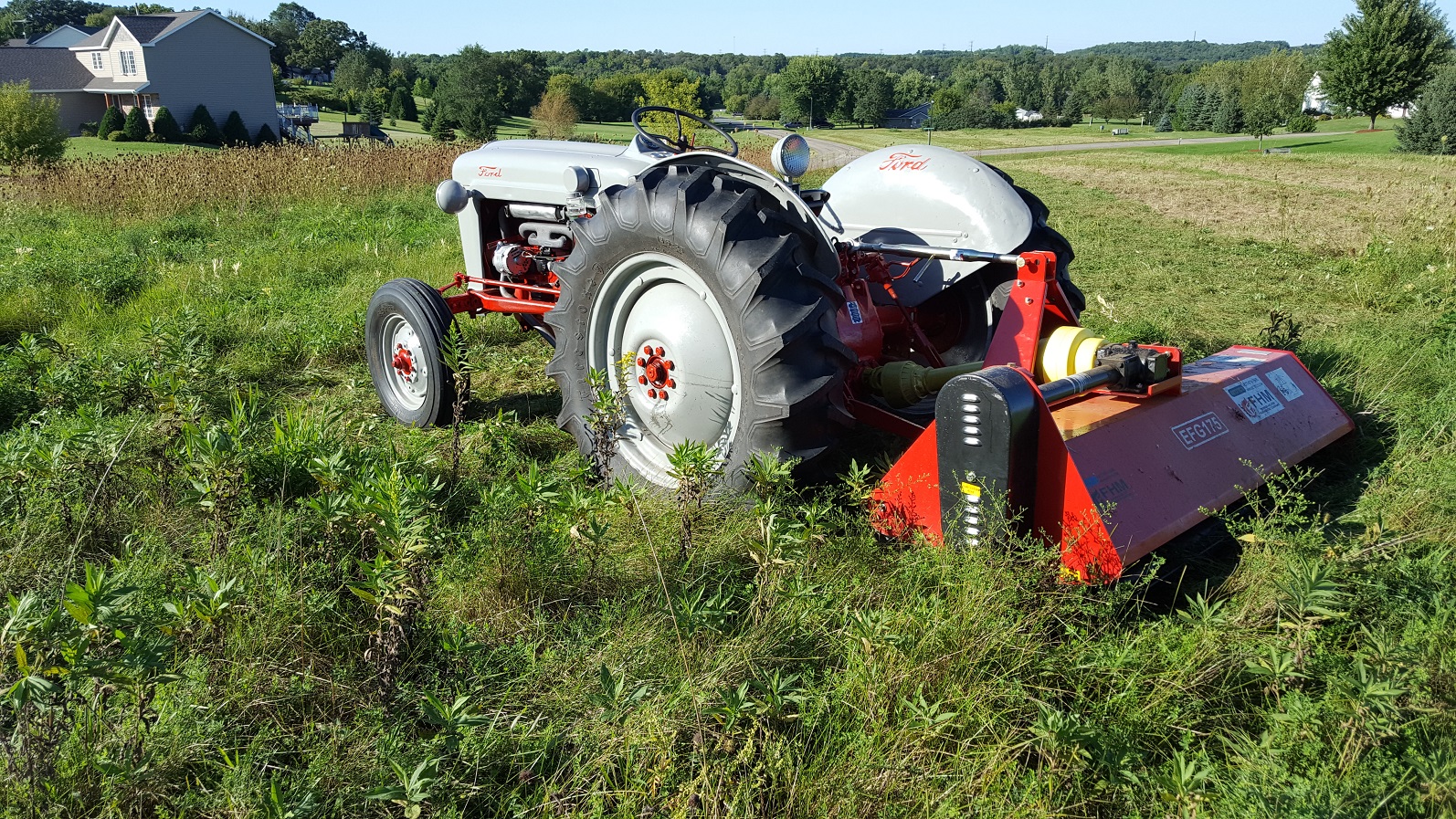

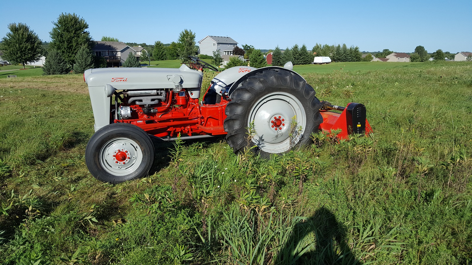

Thank you flail nation. It's been, overall a positive season for my ole ford 917 6' unit.
Yes, I had a couple bumps in the "learning curve" but, they were far from overwhelming. As of right now I can comfortably say that it's value is worth every penny I spent on it and every mile driven to go get it.
Today I was able to mow both front & big backyard in just about 2 hrs. That's my best time ever.this is a 2.5 acre plot so, square foot-wise, I mowed almost 2 acres in mostly mid 3 & 2nd gears and used a bungie cord as throttle lock at basically 2000rpms

That is great! Glad you are liking your flail.
Out of curiosity, why do you have to bungie cord the throttle? I think it should stay where you set it until you pull it back to idle.
I'll 2nd that. All tractors I know of should have a throttle that stays fixed when you aren't moving it. You may need to tighten something a hair.

The throttle arm just under the steering wheel is "loose" behind the control panel. The friction assembly isn't holding it "steady" currently. So when I do the fluid changes.... I'll have enough disassembled to discover what needs fixed. PLUS, I'll also be able to fix/lube the foot throttle pedal when doing this too. Foot is "stuck" in the up position hardcore.

I see. Hopefully you are able to lower the throttle before clutching. Clutching under a load will cause premature failure. That was my only concern with the way you have to do it now.
