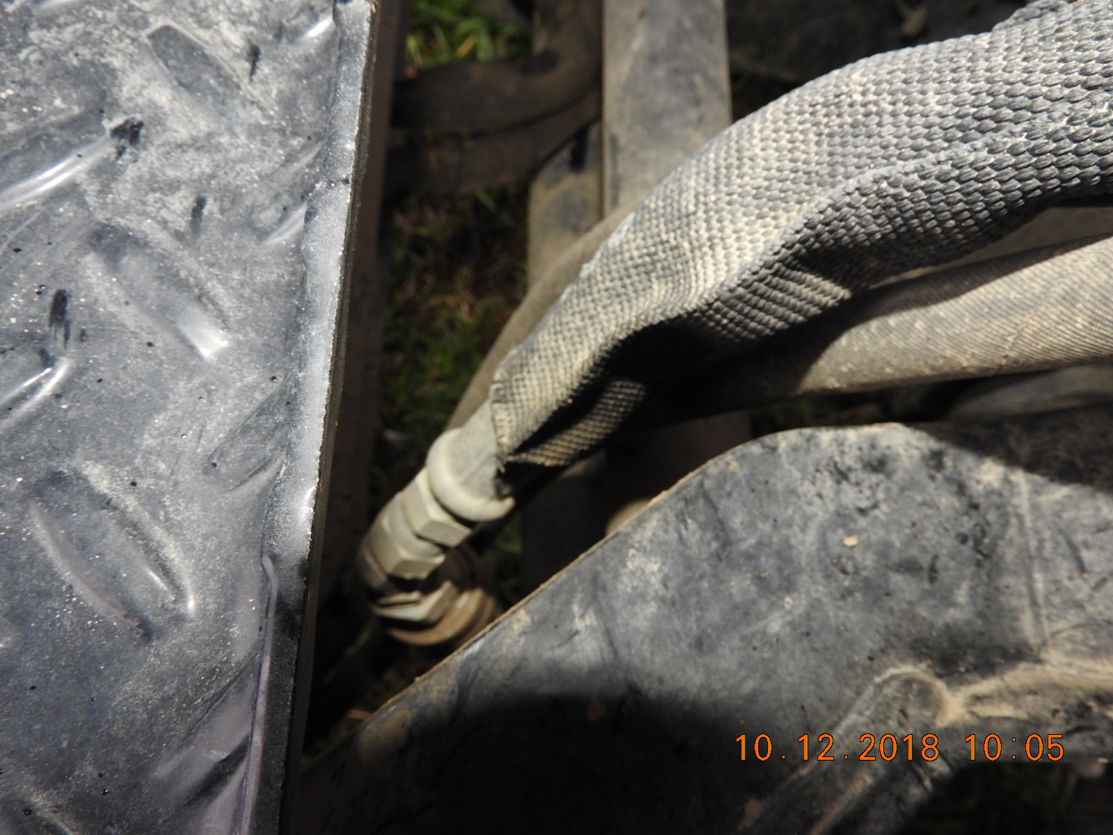

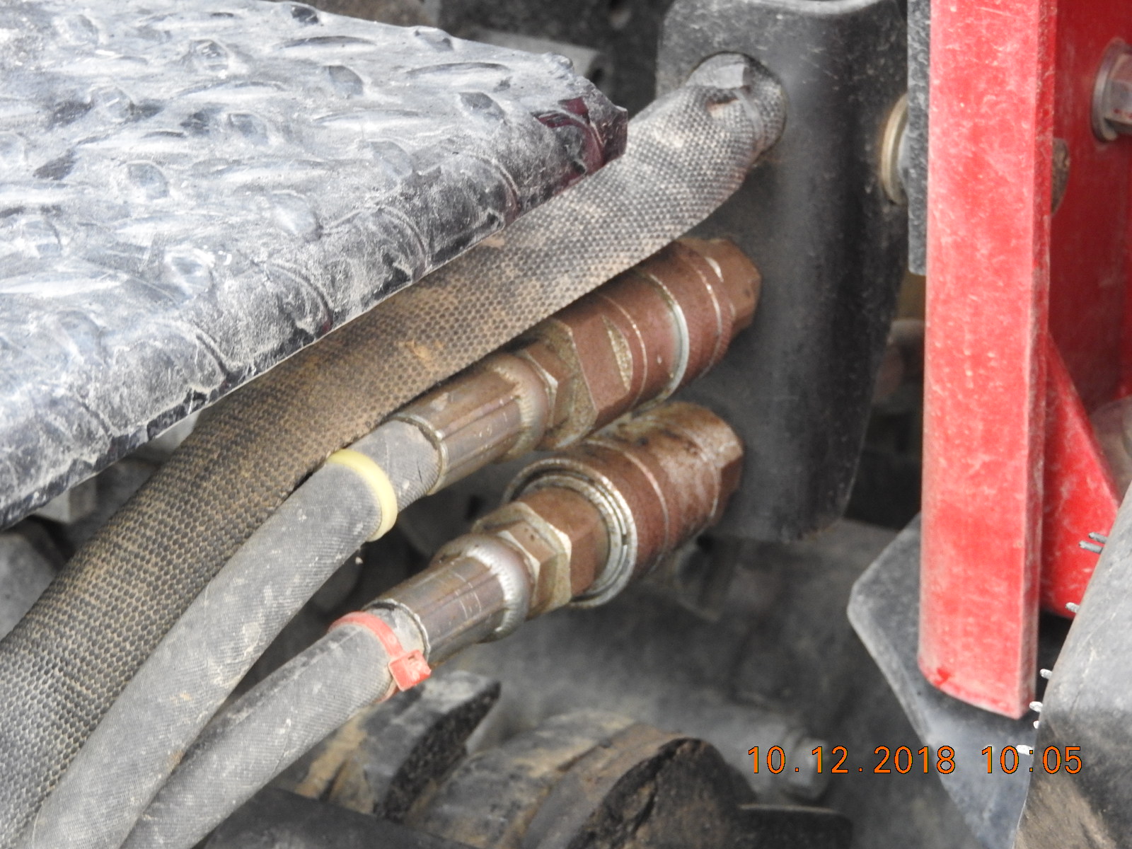

Thanks Aaron.
There are 3 hoses. The manual says that the female hose connecter must be put into the male connector (lower in the picture) when the BH is removed to "keep the tractor from going over the main pressure relief". The female is on a hose that comes out past the fixed connectors on the back of the tractor and goes down under the BH footwell DSCN1322.JPGDSCN1323.JPG
Of course there is then the question of where to put the spool valve. Starting to wonder if it isn't easier to just steal the loader dump function. 2 hoses about 5' -6' long each.
