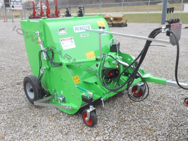

The image of the Peruzzo pick up mower that I have attached to this response shows a pair of caster wheels in the front of the flail pick up mower to prevent scalping and knife damage. If the manufacturers of these things offered front caster wheels as standard equipment in their flail mower builds they would sell many more flail mowers as they would mow better and as a result create better turf as the caster wheels act as an additional aid in maintaining the mowers cutting height along with the rear roller.
The Wessex towed motorized flail mower in the second image can be towed by an ATV/quad bike or an SUV to mow and it has front and rear gauge wheels and does not use a rear roller as it is designed to mow in heavy deep brush.
The Vrisimo flail mowers made in California can be purchased with front and rear casters as an option in just one instance.
The older mott flail mowers had rear casters as an option to aid in protecting the flail mower from suddenly dropping into a depression by nose diving into it if the mower was left in the float position and then causing scalping and knife damage.

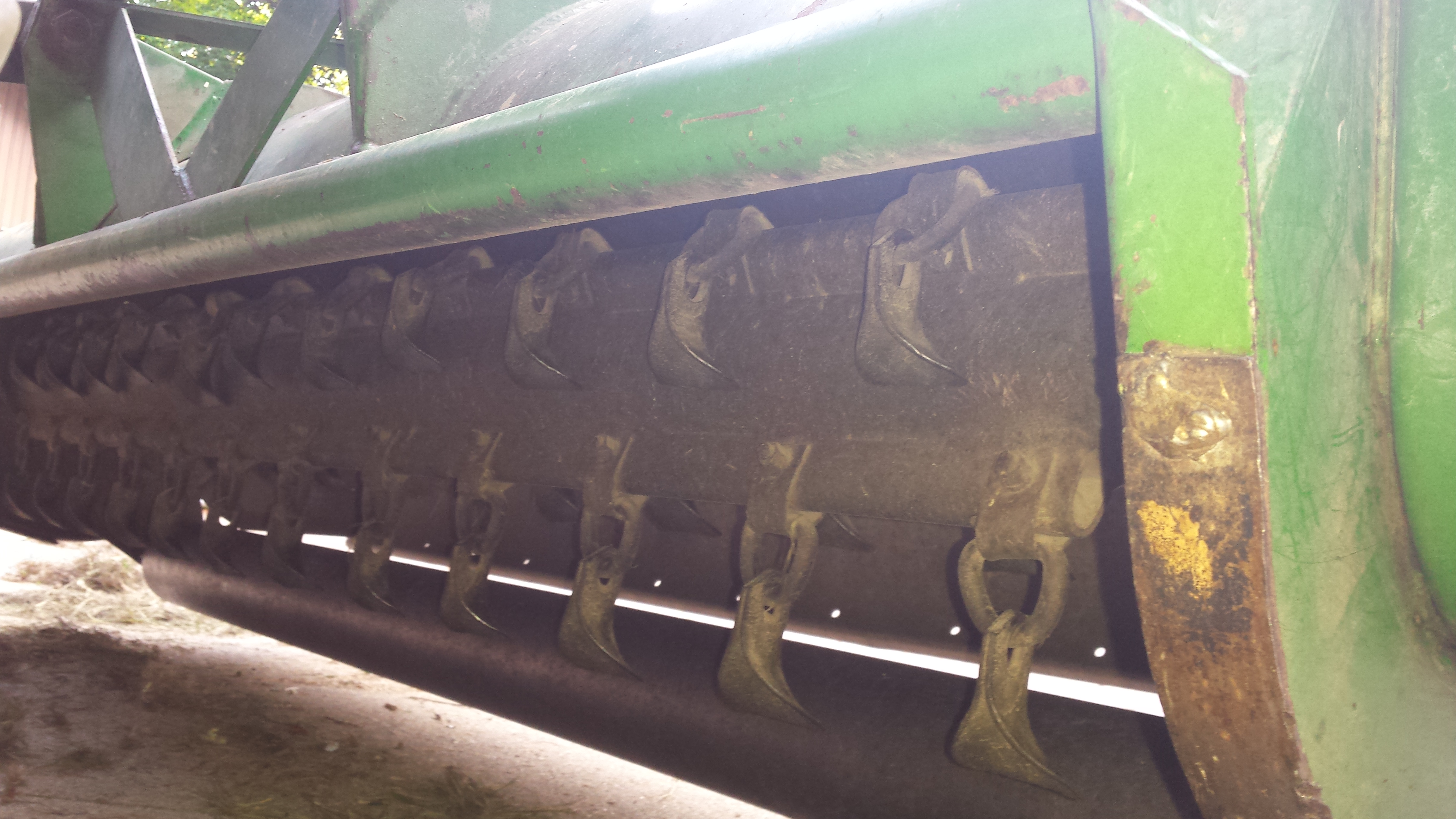

I would have to respectfully disagree with this. The scoops (and Ford's airplane wings) have much better design to create a suction to lift. Their design is much like a furnace blower (in reverse actually). The scoops are angled so that when the blade is at bottom dead center there is an angle along the blade facing upwards creating high pressure on the top side and low pressure on the bottom side creating a lift. The side slicers when at bottom dead center are parallel with the ground creating no lift. There is "wind" created by them simple by displacement of air, but no "lift". I noticed that with my Ford 917 that when I switch from airplane wings to side slicers my tire tracks are not being cut as well as before. This would reaffirm the lift the wings and scoops create vs side slicers.
The hammers may or may not have lift depending on their design and the way they spin on the rotor.
Every flail is created differently. To say otherwise is like saying that all tractors are created the same and operate the same regardless of who manufactures it. My Ford 917 is designed to take different knives for different jobs including switching between rough and finish mowing blades. Some mowers you need to change the rotor to do so, and some don't even offer the option to go to finish mowing. Some mowers rotate the same as the tires, some opposite. It's all in how the manufacturer designed it and I would follow what the manufacturer says on how to set it up and use it. They designed it to operate a specific way and to do otherwise is counter productive.
One must also have sharp cutting edges to mow well so that must be a priority.
"The current design of many flail mower rotors that have narrow knife mounting stations that do not allow the knife sets to become aerodynamic and allow the knives to become wings".
When a D ring or tool less knife mounting station is used the side slicer knives are typically mounted with its loop mounting hole where they can quickly become airborne and the knife edges become level to permit them to clip the grass and brush at the same height where the narrow knife mounting stations will create a sawtooth pattern on the cut of grass blades on good sod if it is mowed closely.
The scoop knives cannot recut material a second time unless it is brittle and has little weight.
This is why flail crop shredders made by Mathews and others use a cast and machined wide scoop knife to clear the crop residue in peanut trash, potato vines, cotton vines, sugar cane stubble, sugar beet toppers, and pineapple root stubble along with mowing down alfalfa and clover crop growth at the end of the growing season to help prevent damage to the grass crops from leaving the growth over winter which makes the grass crop more prone to freeze damage through the growing grass left after the second or third cutting making it more suseptable to winter kill which will affect the following seasons hay crops.

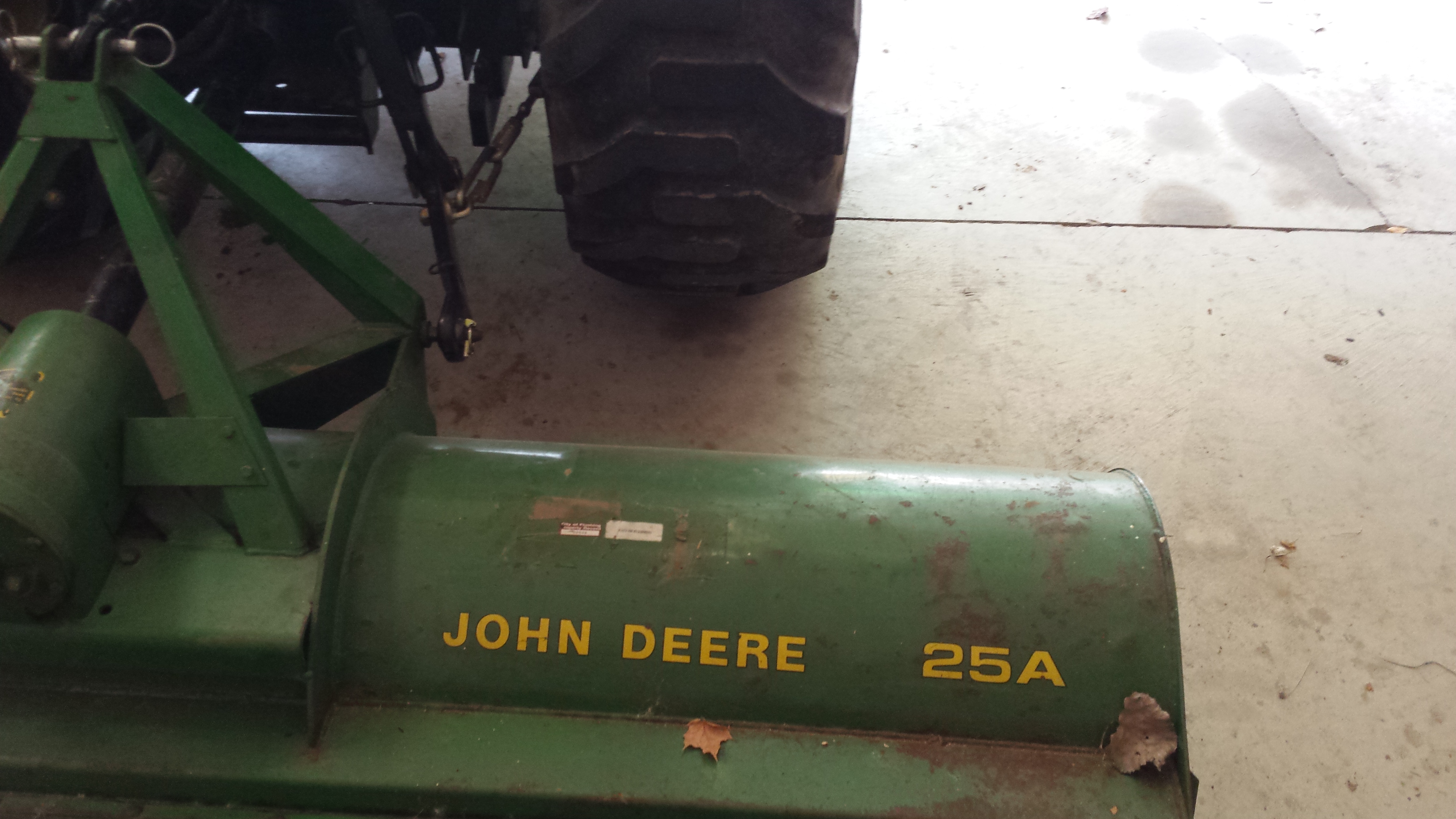

Start looking at tractor house, auction time and iron planet for a used JD25A, 290 or 390 flailmower(8 foot cut). you should also check with the JD dealers in a wide radius as they may have used 290's in as trades(7 foot cut) or they know where some used ones are as the dealers also have a network for used JD machinery and JD implements.
