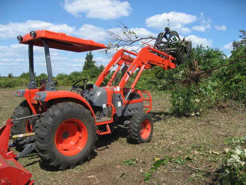

Anything more than some casual weeds, this 90" mower slows this 41HP tractor to a crawl,,,
I think the reason this tractor can not pull the flail better is that it is a very small displacement engine.
The engine is only 1.5 liters,, I think they get the HP way up with the turbo.
Once the engine RPM's start to fall,, the torque goes away quickly,,,

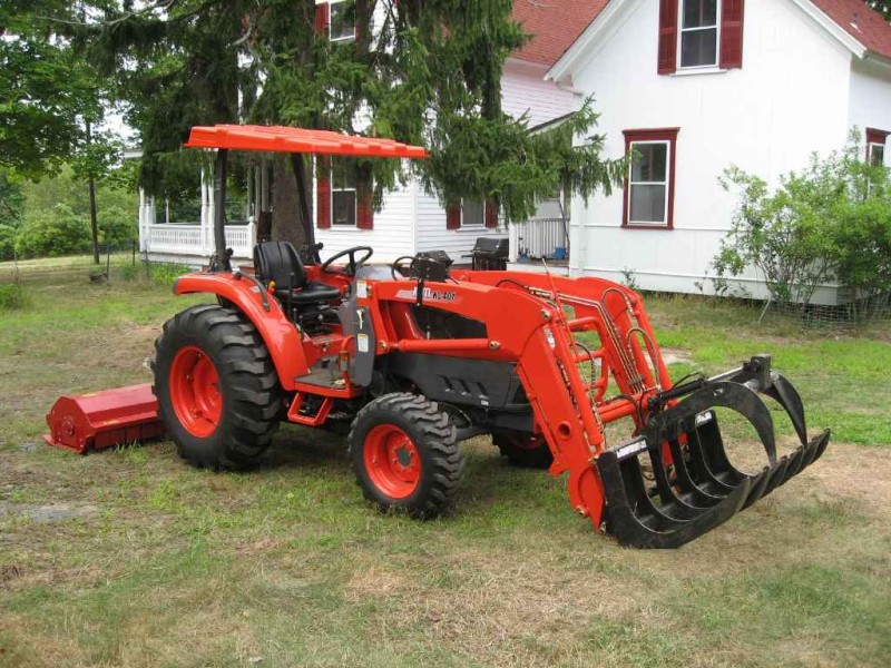

This tractor is 3.4 liters, no turbo, 60HP,, it can thrash the daylights out of the same flail,,,
The red tractor never looses RPM,,,:thumbsup:

There's no replacement for displacement. (or we could blame the greene paint... :confused2: )
You're also looking at a 50% power increase. (and, of course, red paint... :dance1: )
90" is also a lot of flail. Even with now having 45HP I doubt I would go over 6 foot wide mower. If I had a lot of land to clear, I could go 7 foot and just keep on top of it. But, I like seat time (and don't have permission to buy another mower...), so 5 foot it is!
