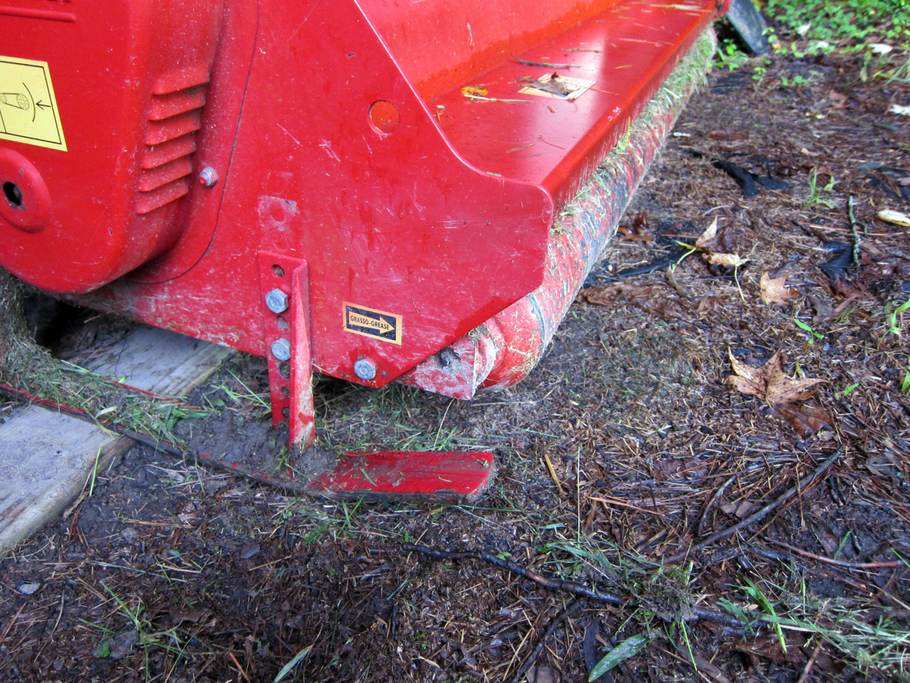

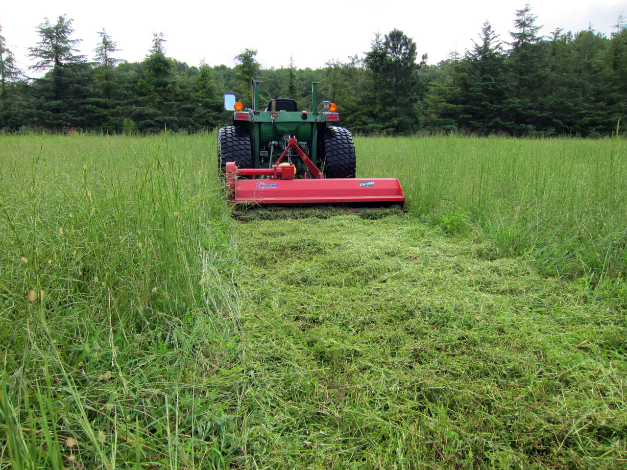

Cessnadriver... My 40hp J-D runs my Caroni mower pretty well. Before this tractor, I had a Ferguson 40, and I am pretty confident the J-D has more muscle. Both had H/L trans. I usually run the Caroni in 2L. If the weeds are waist high, 1L.
I did something stoopid from the beginning; I thought the Caroni was set at a fixed level and I ran it for almost two seasons waaay too low, for my needs. I jacked up the skids and tilted it back to attempt to raise it. I finally found 蛯*y looking underneath it was adjustable! I also got new belts. I'll plan on keeping a better eye on them. I still love this mower. That J-D mower CAD has sure looks nice, but too large for me.
Jim
