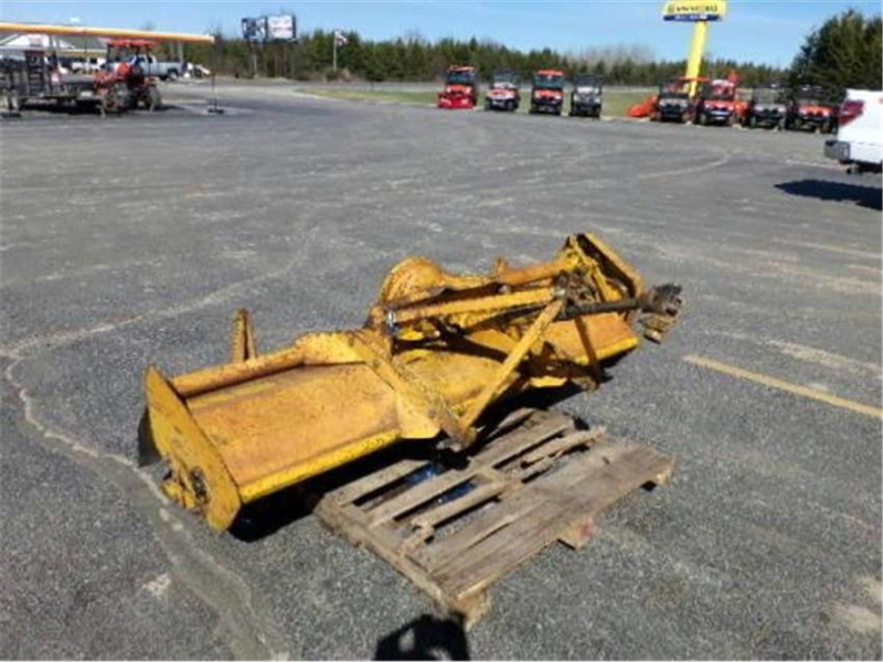

New member here with a dilemma. I recently acquired a John Deere 25A. It needs blades, rings, hangers. No big deal. Just call Flailmaster. Here's my problem. With everything removed from the rotor, it is not balanced. It has a heavy side. I removed the belt and spun it with a drill and it vibrated a lot. I don't think it's bent . Just not balanced. Is this normal?

Well, the Mott gearbox appears to be toast. Leonz looked at some pics and confirmed. Both the larger ring and smaller pinion are severely worn, and the new gear oil we put in just 5 hours ago was already silver-ish.
Unfortunately it also appears to be the older gearbox where the pinion alone is $1000. Flailmaster recommends replacing with the updated gearbox. Best price on that is $1400.
I have looked all over for a comer box, but this one must be proprietary to Alamo. Cant find one with input side larger mounting holes and correct spline and increasing gear ratios (looks to be about 1:4).
Options are limited beyond finding a salvage unit, buying a new box, or buying a used complete mower to rob the gearbox.
Any thoughts?

The wear on the teeth doesn't look too bad but hard to tell with a photo. It looks like they are just a little frosted and not yet spalling. Is there a noticeable step in between the worn and not worn area of the loaded side of the teeth.
Try running ATF in it for a few hours. At this point you have not much too lose. I had a brand new gearbox in a snow blower making metal and he told me his buddies running commercial snowblowers (huge ones for road sides) run nothing but ATF in those gearboxes and they stopped having metal problems in them. They also run ATF (dexron mercron) in their snowmobile chain cases and those have stopped making metal too.
I run it in my blower gearbox and the metal particles stopped. All though I realize the ambient temperatures of the applications are different. I suggest doing a test for a few hours.
maybe with any luck it is a bearing that is going instead of the expensve gears.

Ware is to be expected and no used gear box will be without ware marks. I see no broken cogs and the ware seems to be even. Put it back together and check the SLOP in the gears. i.e. - see how much wiggle is at the output sheave. That gear box could have another 5-10 years or more of use depending on how much you plan to use it. I suspect the oil was never or seldom changed. Clean the housing to remove any old metal shavings. Then use 140 gear oil and change it a couple of times after 5 or 10 hours of use and see if it clears up.
Just trying to save you some expense. The worse that can happen is you will need replace the gear box ... but that is what you were already planning to do.

ATF or O or 140 all seem like reasonable options. This thing is making a ton of racket and it seems most consistent with a gear whine under load. Doesnt seem to happen if the gearbox is coasting or slowing down. It would seem to be unlikely to be a bearing based on that, but hard to tell. Would not want to start dumping money into bearings only to find that I need gearset after all!
Have about $1000 invested in it so far with purchase, all major bearings, blades, belt, etc. it is a grass flail and really does a beautiful job

Update, used a fine wire brush wheel to buff off the frost and rough edges of the gears. Bearings for the pinion are not wobbly and are smooth rolling. Bearing for the rear ring gear probably with the most wear, but only noticeable by a bit more cage float when put together without the small bearing thruster door in place. All bearings cleaned and greased.
Filled with a quart of valvoline synthetic ATF and there is an improvement in gear noise, maybe about 40% improvement. Gonna try it for a few hours this weekend, keep you updated. Thanks for all the ideas, guys!
