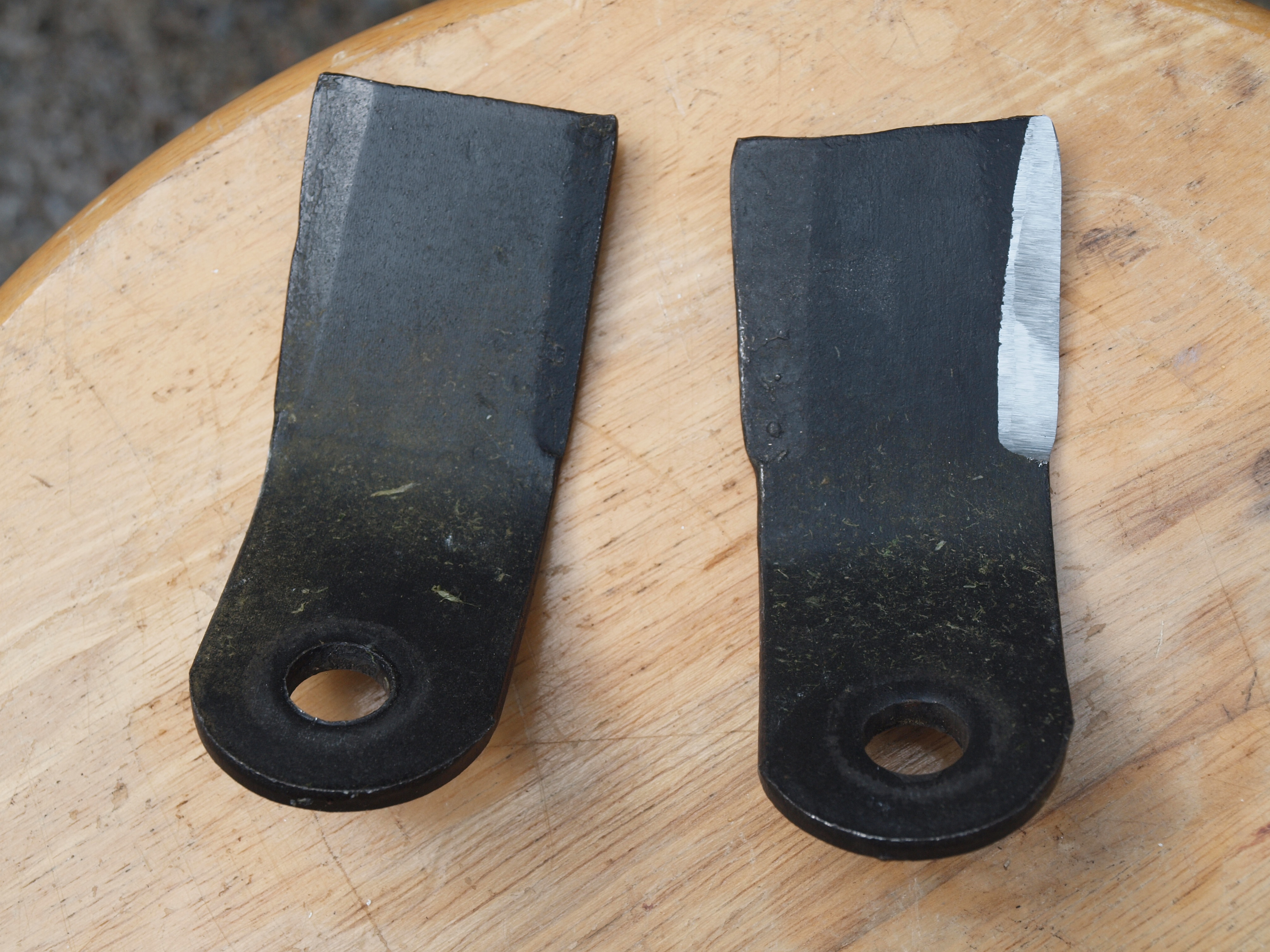

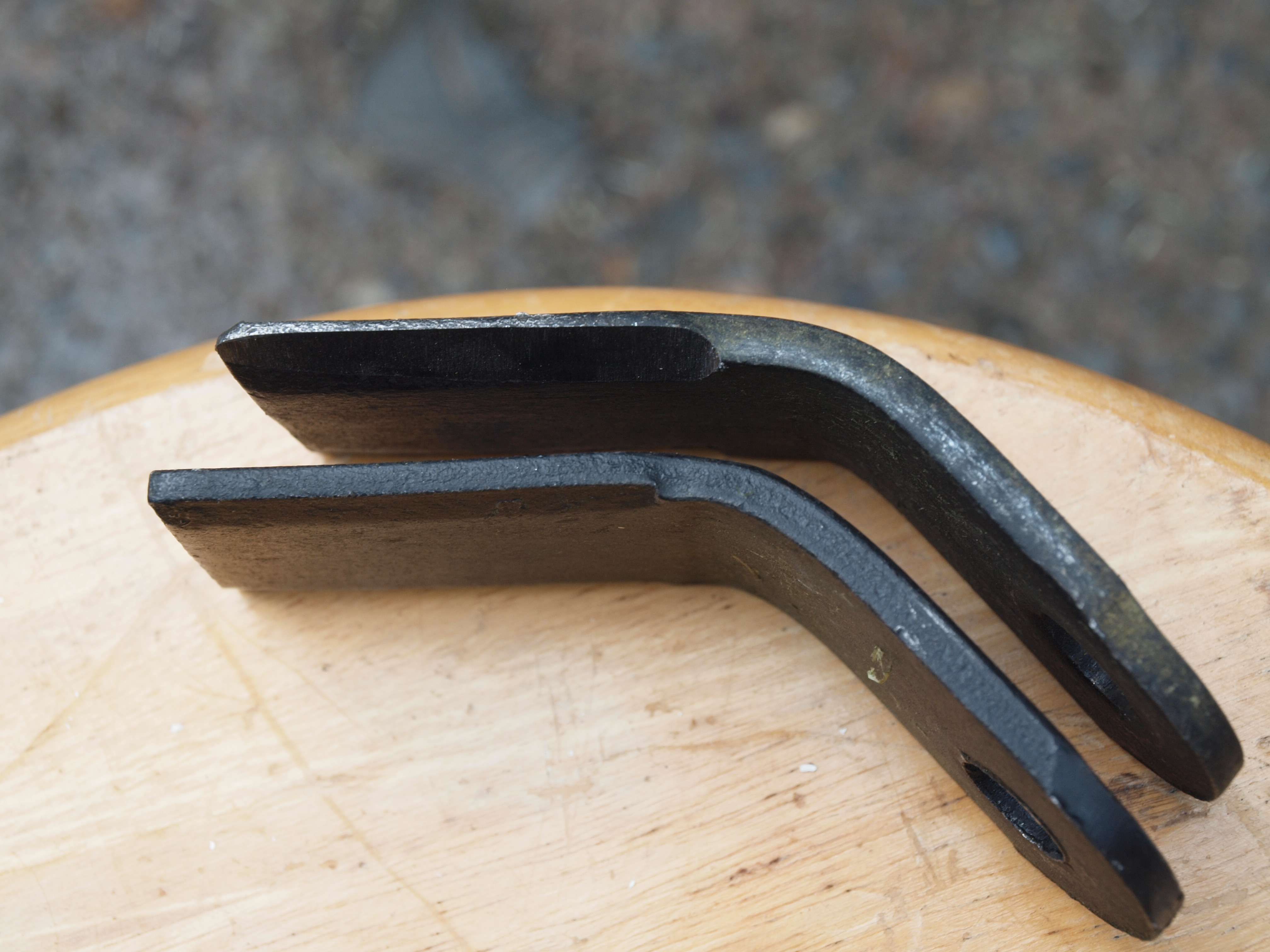

def38, any links or more info on those forged duck foot flails? That makes sense if they have more mass/weight to them to smash/cut up thicker brush. I'll definitely look in to that.

Leonz is the flail expert. I would consult him. My Chinese flail mower came with forged duck foot flails so, I am of no help...sorry.

Hello wims8899,
You will not be able to make use of a cast hammer flail knife on your JD25A as the mounts are a completely different style and flail mower rotor.
The heat treated side slicer knives and the micro mark wet well grinder and angle setter from wood craft will enable you to have sharp side slicers for many years.
Don't forget that the side slicer knives have two cutting edges and they stay sharp for a long time as long as you take the time to mow at a slow pace with heavy brush and by mowing in a spiral pattern to save on fuel and brake wear.
