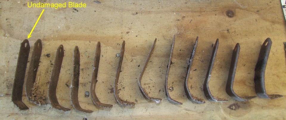

Ok, I am the new owner of a Mott 72 Fine cut flail mower. It definitely needs new blades and a belt but is otherwise very nice.
It currently has the 4-1/2 inch opposed Y blades hung from clevis pins, 92 stations, 184 blades.
In Flailmaster's catalog two types of replacement blades are shown. A clip/D-ring short blade held on with a bolt; and what the mower currently has (4-1/2 inch blades hung from clevis pins).
Both types of blades are only .087" thick. Replacing all the blades with the D ring style will be a little over twice the cost of the double long style.
Am I missing something here. Why would I go with the D ring style. Sure they "give" a little more with hitting rocks, but you could have two plus complete sets of long blades for the cost of one D ring set.
Also the long blades seem like they have more cutting surface (albeit not sharpened) to shred cut material.
Has anyone ever changed out a set on a Mott Fine cut Hammer Knife mower?
/ Let's talk flail mowers #5,611
You are correct in your thinking and modifying the Mott 72 for "D" hangars will cause you no end of grief. The old Mott was NOT meant to use "D" hangars.
If you put the mower up on a bench the whole process of changing out knives will take about 3 hours and a couple of band-aids.

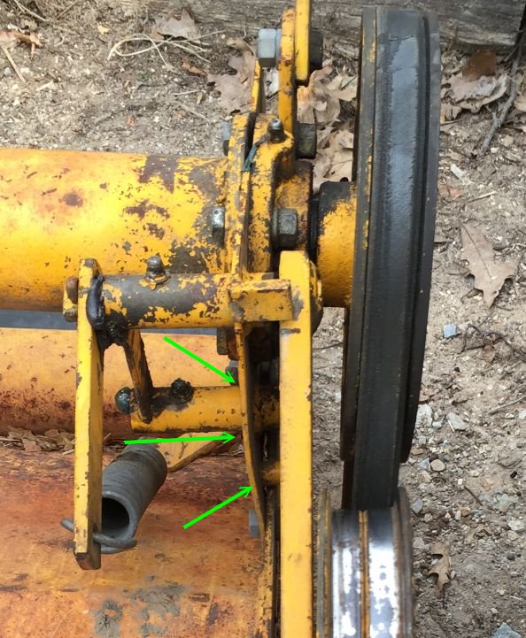

I've read about forward and reverse rotation on this thread....
Does anyone that has or has used a Mott fine cut flail have any input if reversing the rotation makes any difference in cut quality. The Chinese Flails for sale online advertise that they run reverse rotation for a better cut.
Apparently you can reverse the cut of the Mott 72 by changing the drive belt to the right side of the mower. This must have been engineered into the design of this mower for some reason or use.

The Mott 72 cuts great as is. When you reverse the rotation it will fling the clippings forward toward the driver's seat.
/ Let's talk flail mowers #5,619
I’m trying to figure out why Mott would bother making it reversible. I know the smaller ones were reversible because they were intended for some of the smaller import tractors that had a counter-rotating PTO shaft, and others were made for 1000 PTO as some of the older Kubota had dual speed PTOs.
/ Let's talk flail mowers #5,620
Hello retiredfarmer,
You may want to back the tractor and mower out and back it in as your going to be working on it for a while and I don't think you want the tractor held captive by the mower.
They reversed for roadside mowing; they did not want any possible objects being ejected and thrown at an incoming car if the mower was elevated/riding over low spots that had debris sticking up in the mower path.
The use a front mounted flail mower in Europe to cut silage crops while using outboard rear mounted wing mowers as well.
This one still has the ball hitch mount for towing 2 or 4 of the motorized Motts with trailing hitches.
