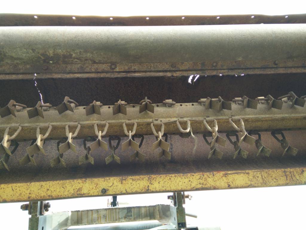

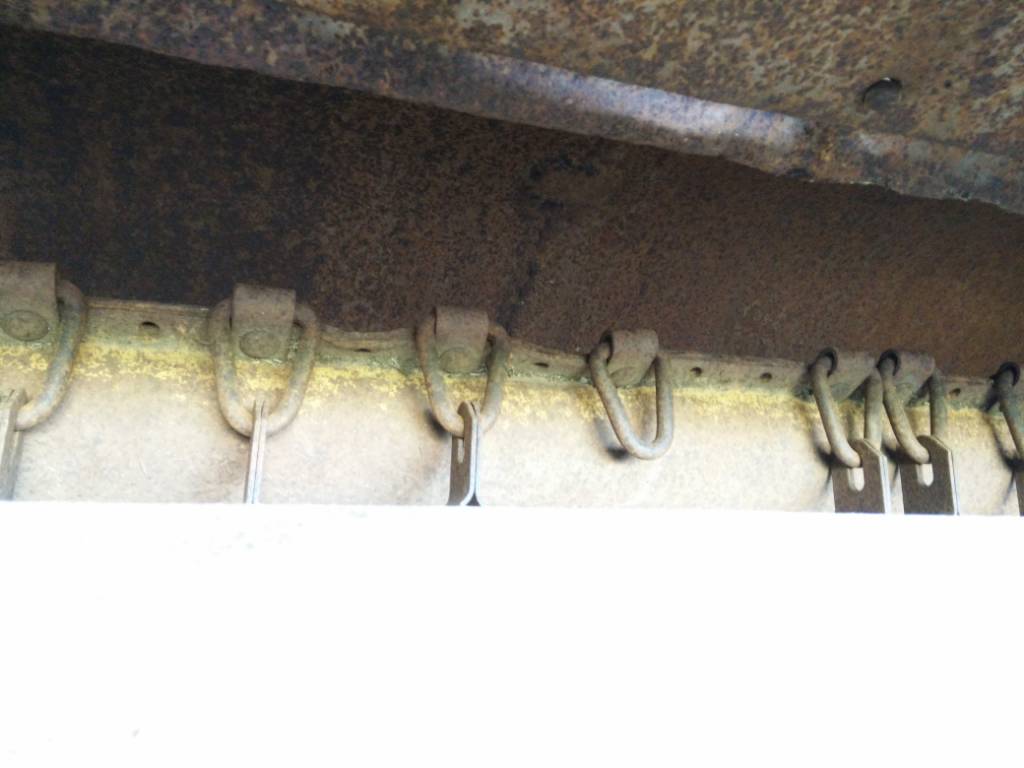

Looking at a Ford 917 Flail mower that is set up for fine cut. Are the blade drums the same for the 917's with the fine and coarse cuts? Can this be converted over to a coarse cut by just installing new coarse cut blades?
Thank you.
Yes, the rotors are the same. You will only use 1/3 of the stations. I believe there is also a difference in balance weights bolted to the rotor (there is a page from the manual someone posted somewhere in this thread to show that). You can go with the airplane wing blades or you can go with the side slicers. When I got my 917 I went with the "extreme service" side slicers from flailmaster (M-105319M), but also considered the "heavy duty" side slicers (FM-7). I am turning 20 years worth of CRP land back to usable land so I wanted something stronger than the airplane wings. I may order a set of the wings when I need to mow areas that need to look good. The airplane wings do leave a better finish than the side slicers.
/ Let's talk flail mowers #5,642
I've mangled around half a dozen of my side slicers on my 917... well head, football sized rocks... They cut well up to around finger sized brush. Much beyond that & they just gnaw off the bark unless the material is soft or brittle.

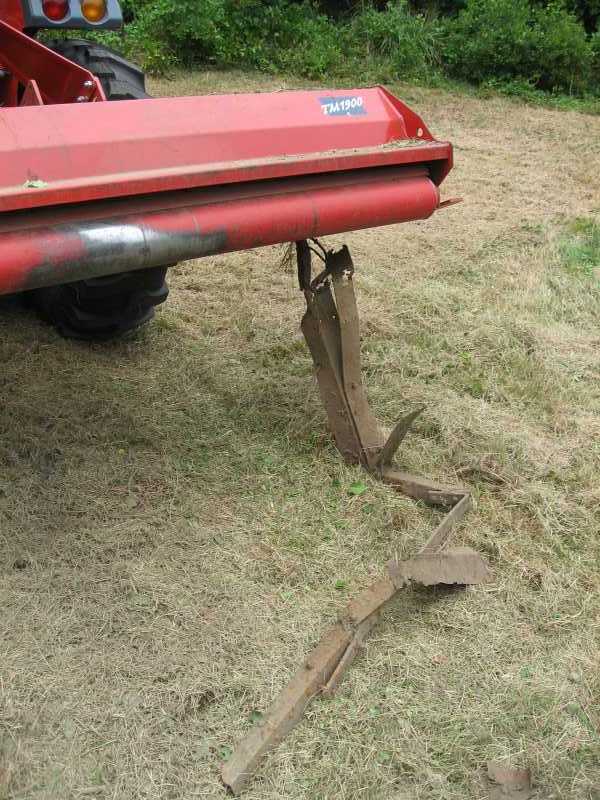

My old 917 hood looks like popcorn almost. Probably helps you figure out how I only paid $100 for it. But it worked just fine. I'll agree & disagree on the rotor. Ya, walk away from a bent rotor. I'll let you figure out how straight the mounting bars on the rotor are... There was a little vibration with a proper set of knives installed, but not enough for it to run fine for about 4 years. More noise & vibration came from that crack in the hook (no that's not bad pixies on the photo) I never bothered to weld up.
My new Peruzzo Brush Bull has a way thicker hood. I assume the Alamo would be similar while the Woodmaxx, Chinese & cheap Italians would be similar to the Ford's hood thickness. While lighter duty the Ford is still hanging in there after being well used for 20-30 years. A few dents wouldn't phase me at all. A lot wouldn't either if the price were right.View attachment 587224View attachment 587225
Fallon or Others,
Do you think the duckfoot (single piece knife) see picture in the below link, these could be run with the same spacing as your "Y" cut (two piece knives)?
https://www.tractorbynet.com/forums...wers-170357d1278268119-lets-talk-flail-mowers
