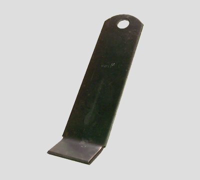

Fallon or Others,
Do you think the duckfoot (single piece knife) see picture in the below link, these could be run with the same spacing as your "Y" cut (two piece knives)?
https://www.tractorbynet.com/forums...wers-170357d1278268119-lets-talk-flail-mowers
Those are actually the original style blade that came on the 917 course cut mowers. So, yes, they will work in the course cut setting. I believe it's every 3rd hole you use and staggered each row for course cut. Mine had those, but I switched to the side slicers for a few reasons. One being price. The other being strength against woody materials to knock down after 20 years of growth.
I have course cut delta wing knives currently, but I’m wondering if I can get more of to get a better cut.
My 917 came with a partial set of side slicers & I replaced them with almost a full set (miscounted so had to reuse a few of the old ones that were in good shape). I can't say I ever thought about swapping really. The side slicers give a great cut quality for fields. They work on brush up to finger size but much beyond that they dont have the weight to do much more than gnaw the bark off. The scoop knives may give a better cut, but you'd need a lawn as opposed to pasture or field to be able to tell.
You could probably go every other hole and increase the number of blades. not sure how much better of a cut you'd get as these should overlap a little bit and they're flat on the bottom (as opposed to they "Y" shaped side slicers). You could change it over to fine cut blades and use all the holes if you want a good lawn quality cut. The 917 is versatile like that. You would need all new hangers and links to switch.

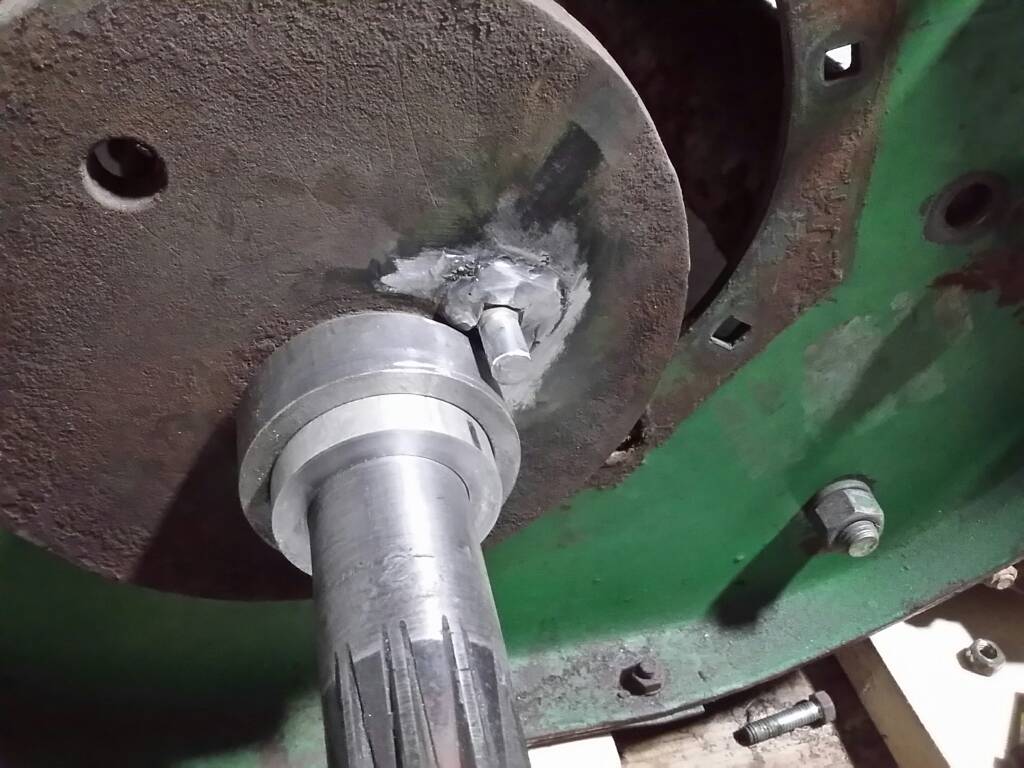

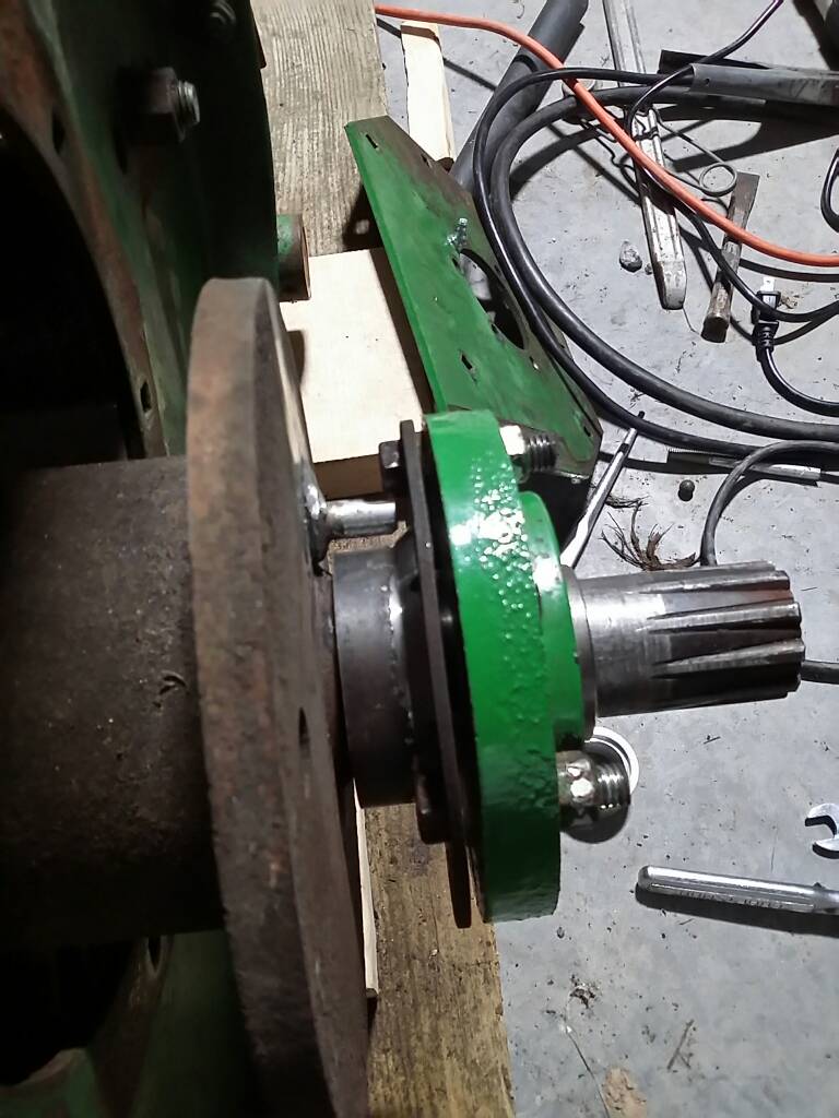

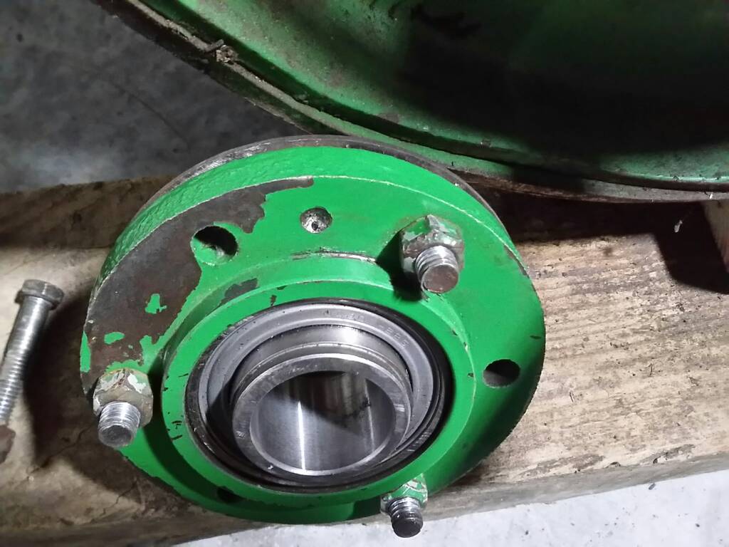

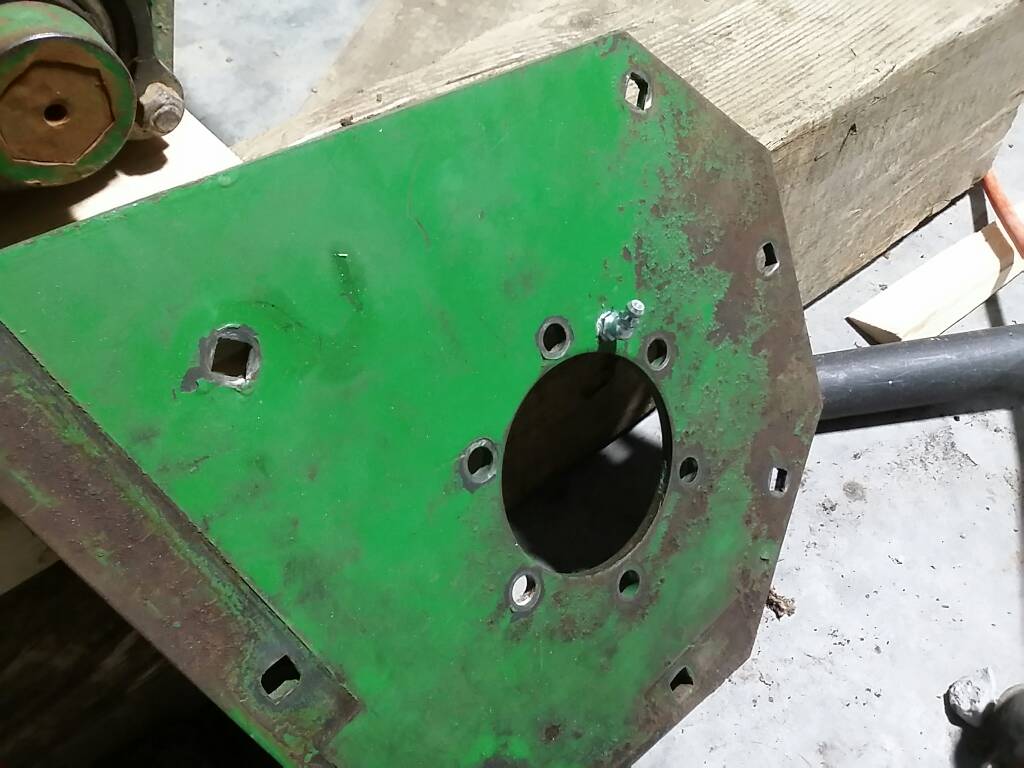

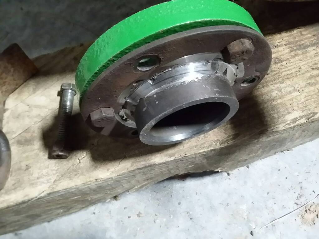

Getting my JD 25A ready for Spring. The anti-wrap is going to work well. I welded a thick walled piece of DOM tube concentric to center of the bolt shim. I then welded a piece of 5/16" rod to the end of the rotor. The stub has 1/16" radial clearance to the DOM collar. Axial clearance to the rotor will be 3/16". I also added grease fittings to both bearing housings. I had to get creative on the drive end and placed the zerts in the steel plate cover with a matching hole in the bearing housing.
I'm having trouble loading photos directly from my tablet.
/ Let's talk flail mowers #5,667
I need to see photos of your work so I can do the same.
BTW, it is Zerk, the name of the inventor of the grease fittings we find on our tractors and implements.

Here are the pics. Worked tonight. 20190127_180506.jpeg20190127_181725.jpeg20190127_181828.jpeg20190127_181817.jpeg20190127_181756.jpeg
/ Let's talk flail mowers #5,674
Aluminum sleeve is used to center the collar to the shaft to set clearance to the stub. Collar is welded to the original 6 bolt flange plate. I used thick washer spacers to ensure the collar assembly doesn't allow water into the bearing. Clearance between collar and stub is about 3/32". I wound up welding the bolt heads to the 6 bolt flange as well. I also had to grind the stub a little for clearance to the bolt head.
Can't see it in the pics, but I fabricated a couple jack stands that have iron swivel casters. The rotor is on the stands so I can move it around to weld or pull out from housing. I used similar casters to make a set of tractor jacks for splitting my JD 4300 to repair a broken HST control rod.

Here are the pics. Worked tonight.View attachment 589373
Thanks for those photos. I had thought of doing the same for both the rotor and roller on my Chinese fail. I have tangled with fence wire hiding in the field on several occasions. It takes some doing to free wire from a flail mower.
Your Zerk location looks a bit hazardous without a guard of some sort.

That zerk is inside the belt cover in the drive end. The other end is set directly into the thick side of the cast housing.
