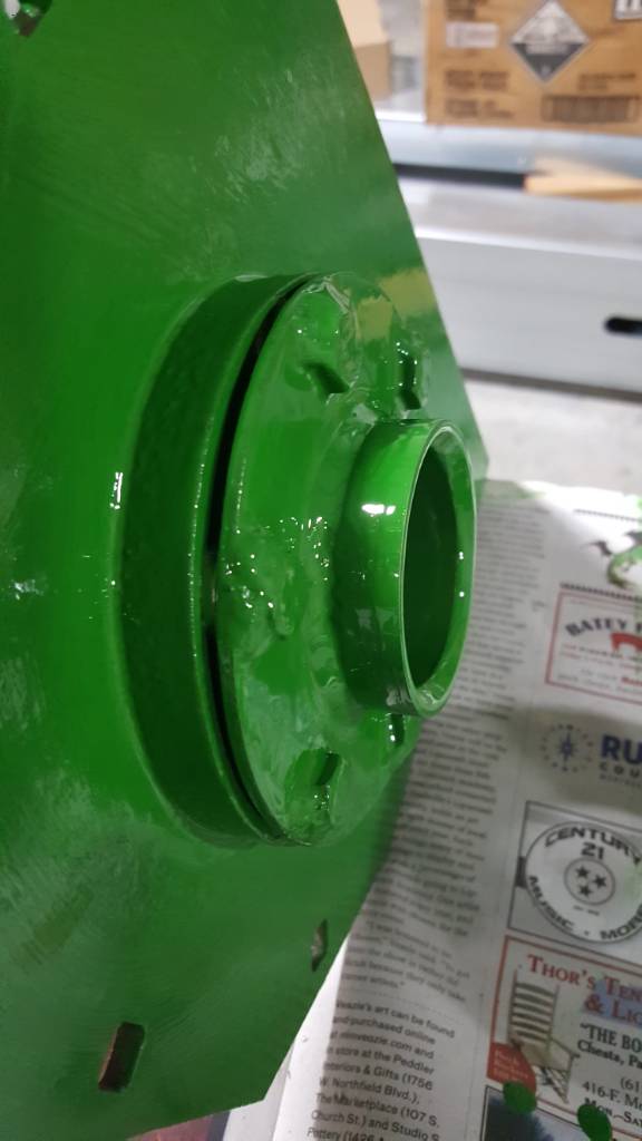

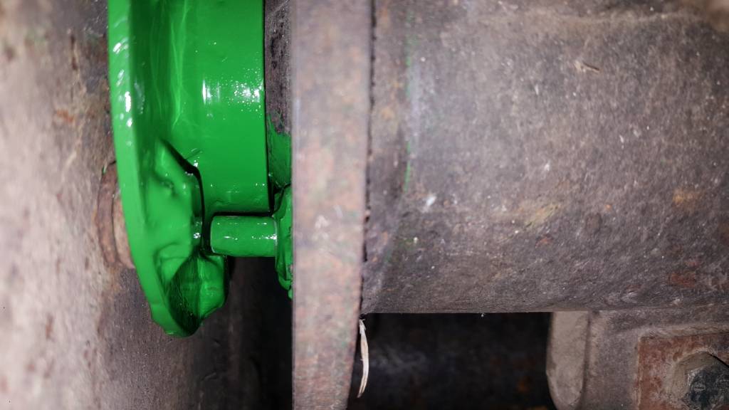

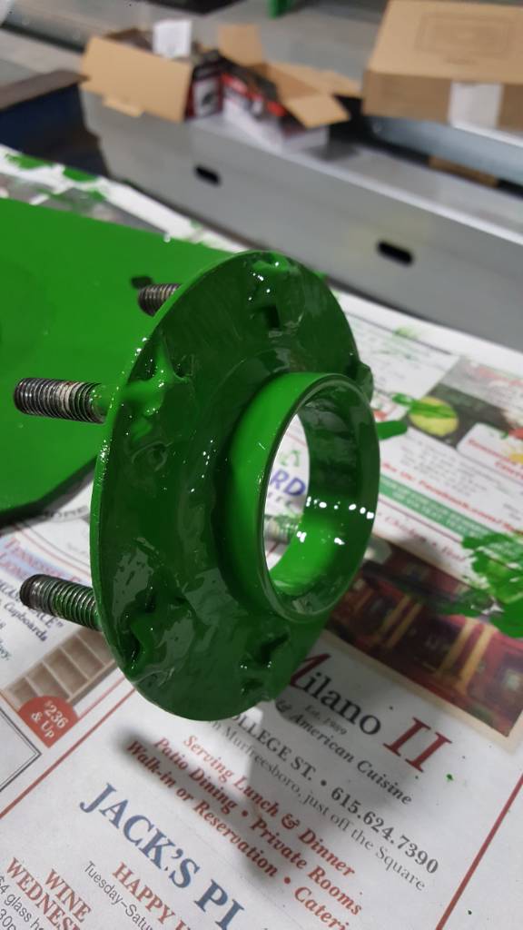

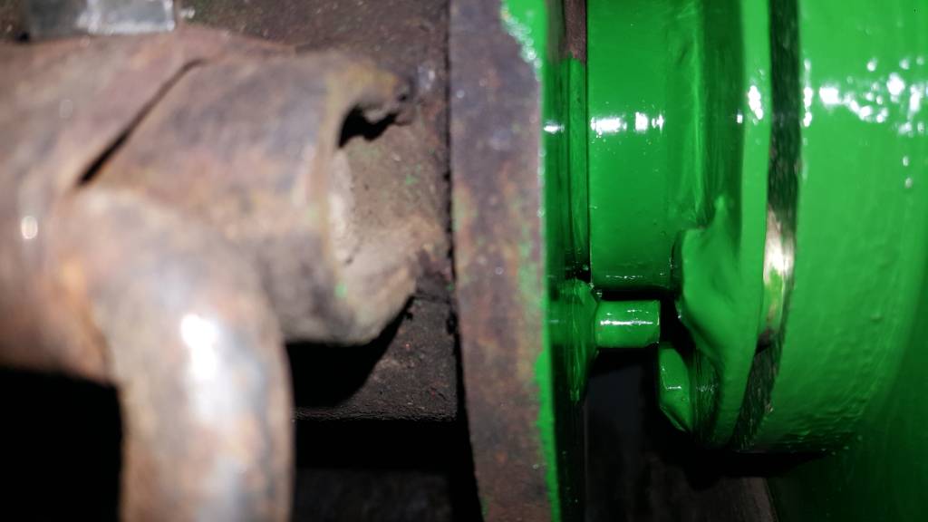

Finally got the anti-wrap modification on my JD 25A complete. Rotor spins great. Welded the original bolts to the washer plate to make a stud plate with collar. Rotor has about 1/8" axial and radial clearance. The design is similar to what is on my JD390. Just need to add some paint to the drive end plate and covers and it will be ready to mow.

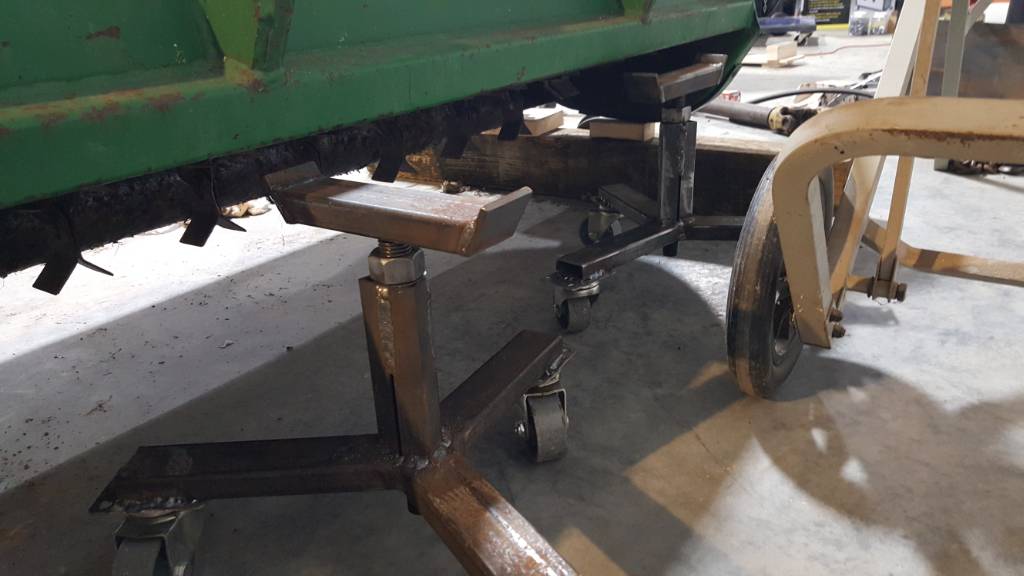

I included a pic of the jack stands on casters that I made to allow me to support and move the rotor when replacing the bearings or pulling the rotor. The stands work great and can extend from 12" to about 21" tall. They will be put to use again when i add the grease zerks to the rotor bearings on my JD 390 Flail. 20190226_200920.jpeg20190226_200859.jpeg20190228_055648.jpeg20190228_055912.jpeg20190228_055842.jpeg

I love it when a plan comes together, happy mowing Jthibodeau89.

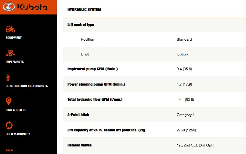

You have 2 pumps on your L4060HST. One for your Power steering and one for your Implements.The manufacturer adds them together to give you give you "Total Hydraulic Flow" of 14.1 GPM. Considerably less than the 21 GPM you mentioned. In addition, you are only going to get the flow from the Implements pump of 9.4 GPM. See attached from the Kabota site:
https://kubota.ca/en/products/power-equipment/tractors/l60/l4060hstcc:

I definitely know that. Never bothered to look to see if it's a 2 chamber pump or a 1 chamber with a flow divider, but the effect is the same.
I was just pointing out what HP would be transferred to that flail based on common pressures & the stated GPM range.
I run a hydraulic SSQA on the L4060 & it has about half the HP (seat of the pants, a bit more calculated) that the PTO PHD on my old L3200. Other factors make it better over all (downpressure & ease of hookup), but it has way less power. Most CUTs can put out under 15hp at best via hydraulics.
