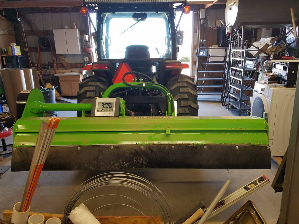

Flail Mower Vibration:
So, I bought a couple of 79" state used flail mowers as winter project machines. One had some vibration. Through a process of ratchet strapping steel weights, running the mower and welding them to the rotor as the vibration improved, I have one running smoothly.
The other has more severe vibration and the process of systematically attaching weights yields no improvement whatsoever. This mower did have a bearing seize on the idler side of the rotor (not the belt drive side).
My question is; where is this vibration coming from? All the blades are off the rotor. The rotor is 79 inches wide, 17 inches in circumference, and has a 45mm bearing axle on either end. One bearing was just replaced (SKF), the other bearing had no perceptible play. These are self aligning bearings. There are 21 stations to which hammer flails attach.
I'm having a hard time believing that this rotor is bent. It is very heavy.
Now that I am writing this though, it occurs to me that I do need to put a dial indicator on the drive and driven sheaves to see if perhaps the sheaves are the cause of this vibration.
Anyone else have any ideas?

/ Let's talk flail mowers #5,729
Is the PTO shaft straight?
/ Let's talk flail mowers #5,730
3L,
I will check this.
It is the same shaft I used to balance the other mower. I suppose I could have simply balanced the other rotor to offset a bent PTO. Hmmm... I need to look at that.
I was reading on another TBN flail post that the bearing could seem good but the rollers could all bunch up under load. Seems like the bearing would have some play in it.
Thx,
RF

Automotive driveshaft services can straighten, balance and likely repair any flail rotor or rear roller.
Years ago, I had a driveshaft repaired on a motorhome. The guy told me mine was out of balance and said, if he didn't fix my vibration, he would refund my money. Cost me $40.00 back then. He also taught me about u-joint phasing.That repair allowed me to increase my highway cruise speed without any driveline vibration. He had all kinds of shafts off a variety of equipment that he was repairing, balancing and installing new bearings and crosses in.
As Darvish discovered, don't overlook a driveshaft repair shop for flail mower shaft work.
/ Let's talk flail mowers #5,733
Def38,
Thank you!
RF
/ Let's talk flail mowers #5,734
I think I am going to take the belts off and run the PTO Gearbox and Drive Pulley to see if the problem might be topside.
RF
