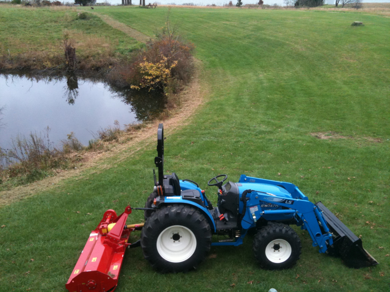

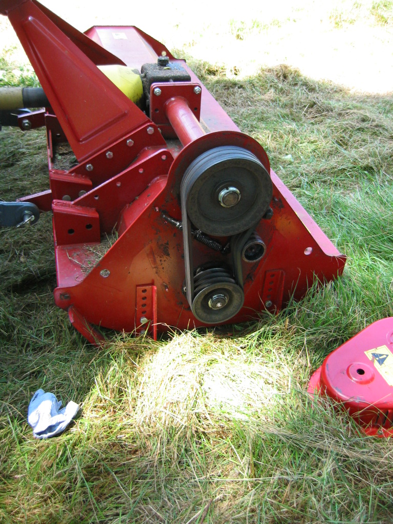

Yes it was at 540pto. It's just odd on how it really didn't cut anything. I think the height is set at about 4 inches. It's one hole from the highest, which I believe is 5 inches. Take a look at these pics. The 2ft tall Johnson grass was only pushed over. I'm going to have to get all new bolts and blades. All the bolts and nuts are rusted on and for the most part stripped. It was hard to tell even what size socket to use. I'm probably going to have to grind or torch them all off. I tried for almost 30 minutes to get just one off so I knew what size and length to replace them with and after fighting the fire ants from the grass from being on my back I decided to give up. I need to go ahead and order some blades so maybe I can cut this weekend. One of the bearings had a little resistance, but it wasn't grinding or anything and I can easily turn it by hand, but i'll probably go ahead and replace both the roller and shaft bearings as time allows. I just wanted to make sure the cutting shaft wasn't warped or bent before I put a bunch of money in this thing.
On another note, what is the overload point on flail mowers, meaning I'm used to seeing a shear pin or slip clutch. I assume it's just belt slippage maybe and a burnt up belt. I know the blades will just pivot back if a rock is hit, but I guess there is no break point between the tractor and gearbox.

Your flail mowers cutting height is set too high which is part
if not all of the problem.
The safety valve for your flail is the flail mowers V-belts.
If your burn up a set of belts you have protected your flail mower.
Just keep in mind that you know own an excellent PTO powered implement
that would cost you almost $10,000.00 today and once you have it repaired
it will outlast your current mule and fit on the next one if you increase to
a larger horsepower mule.

Too high? I mow my yard at around 4-5" (tall fescue)!! What does everyone normally set their flail at? Lower than that scares me due to dulling blades from uneven terrain and also rocks and stuff hiding in the pasture. I should have tried it lower just to see, but I would have thought that it still would have cut. But I do know what you mean about having a mower set too high in tall grass and not cutting good, but it would have cut fine if the grass was shorter due to the "laying down effect" and maybe that's what happened here as you said. This would definitely be a problem when mowing over tire tracks that have already bent the grass over..
Any idea what size bolts I need? I'd rather ask someone with experience than guess. I should have measured it yesterday, but I was worn out, hot, and the ants did a number on me.

Your mower also has the tapered side slicer knives,(I skipped a heartbeat there).
The back side of the knives which is the unused side will last you a couple of
seasons if not more.
The previous owner used that mower a lot at the higher mower setting judging by the
worn knife edges.
I do not remember the bolt size but a quick call to a John Deere dealer or Flail Master will tell you what you need. just be mindfull of the torch as you can also damage the hanger straps.
flipping the mower over and renting an air chisel would be less work for you.

I saw no smoke or anything on the belt, but with all the grease and oil I was using, that could be a possibility. The tension was good and the belt looked decent considering everything else. After looking on clean cutter's site, couldn't I just cut the shackles and leave the bolts alone and replace the shackle with the clevis/shackle along with a mott pin and cotter? That seems easier than fooling around with nuts and bolts.

Maybe I missed it but how fast were you driving when cutting?
/ Let's talk flail mowers #2,210
around 3mph.

The majority of us use 2 inches in cutting height which is the first hole.
You need to use the john deere mounting straps and hangers otherwise
your going to have problems as this flail mower rotor is designed to
use the mounting straps for the knife hanger D rings.
I want you to succeed not fail my friend.
You are a member of the flailmower nation and
an owner with the best type of all purpose grass
and brush mower in the world.
All you need to do for now put down a good tarp, drain the gearbox, flip the mower over,
use an air chisel to break the nuts and flip the knives over to the opposite side and then
replace the nuts and bolts after you flip the knive pairs over to the good edge.
I am not trying to spend your hard earned money.
If you use a smoke wrench you will need to replace the mounting straps
as the heat will weaken them.
Saying that, having all new hardware and a new knife set will last many many years.

Yes, you can use the other side of the side slicer knife.
All the side slicer knives stamped and ground today can be
flipped over to use the other edge.

So, if you were to cut the clevis, or the bolt.. couldn't you just use a set of bolt cutters? I would think this would be the easy way to do it.As long as you intended to replace clevis'/bolts anyway.
/ Let's talk flail mowers #2,215
I don't think I can get to the bolt with cutters, but if I were going to cut the clevis, that would definitely be the preferred method. From what Leonz said, I should keep the factory clevis and replace the bolts in order for it to work as intended.
/ Let's talk flail mowers #2,216
Hello mgraham112,
The clevis(knife hanger) is actually a D ring that rides inside the strap for the knife hanger.
if you can break the nuts and bolts off with the chisel.
Saying that, it may be less aggravating to use a nut splitter or 2 of them with 1/2" drive
hand ratchets if you have bait like pizza and beer for a helper.
The reason I suggested rolling it over after you emptied gear box is to eliminate issues
with rust particles in the eyes(been there done that).

Well depending on the height of grass and how wet it was, that could be too fast. When I cut taller stuff I don't go faster than 2-2.5mph. That's tall weeds.
If it is thick grass that has any height to it. 8"+ then slower speeds have to be taken.
