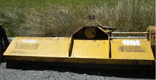

Does someone here know what model Vrisimo flail this is that showed up on my local CL? It's listed as an "8 foot" cutter, though that may be its overall width. It looks to be a precursor to the current Super Series. The most distinctive feature is what appears to be a completely rounded belt housing top with vents. Would parts be available for it? I'm trying to decide if it's worth the 3 hour round trip to scope it out. Thanks.
It should be a 3 row finish flail mower and well worth the trip.
Parts are still available as the majority of them are generic-i.e,,
The V belts are metric, the bearings are metric and the knives are
available from several sources,the manufacturer is in California
and still in business.
It will only need a new PTO shaft, a new set of kevlar belts, and few new knives,
but still worth the trip as you are looking at almost 5 figures with tax if new in that size mower frame.
Check to see if the ID plate is either on the box weldment, bottom of the mower shroud or under the V belt guard to find the serial number.

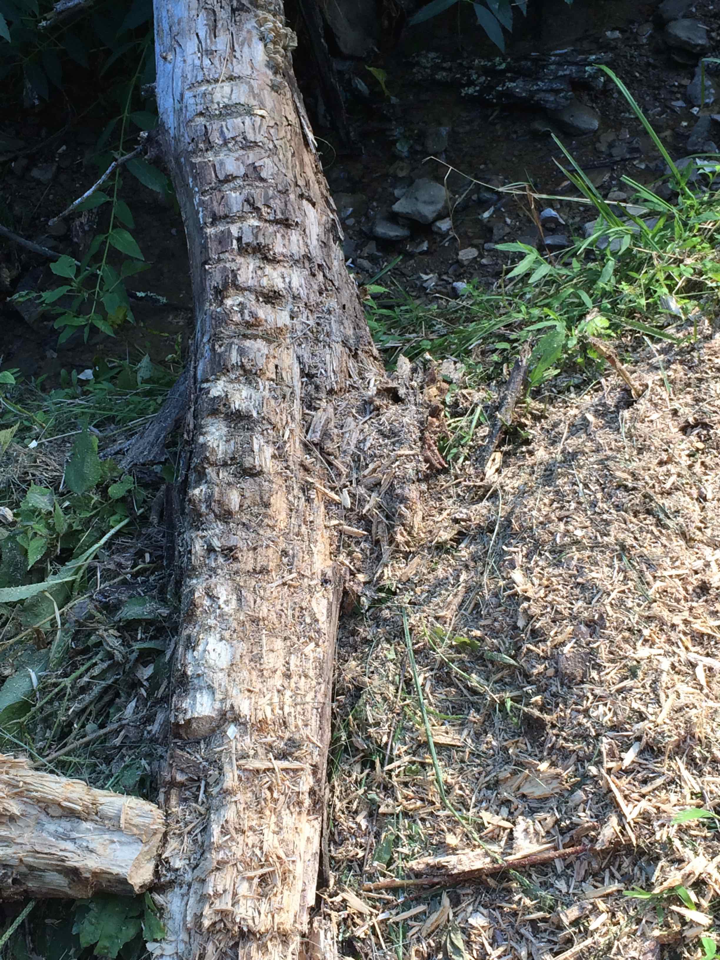

Noticed the state road guys were cutting near the house today and seen where they "mowed" a log (Had an Alamo flail on the tractor with the Y blade knives)
Thought it was interesting to see how it "cut" the log (about an 8" log so not really brush in most peoples eyes) and thought others maybe interested in...
