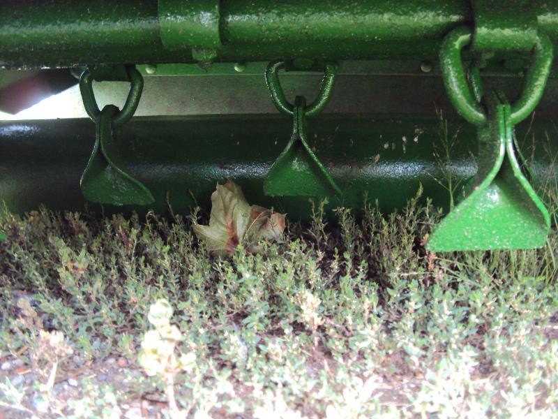

Theory is interesting, but when somebody puts their flail over the top of a feather, and it can't lift it, the theory doesn't matter much.

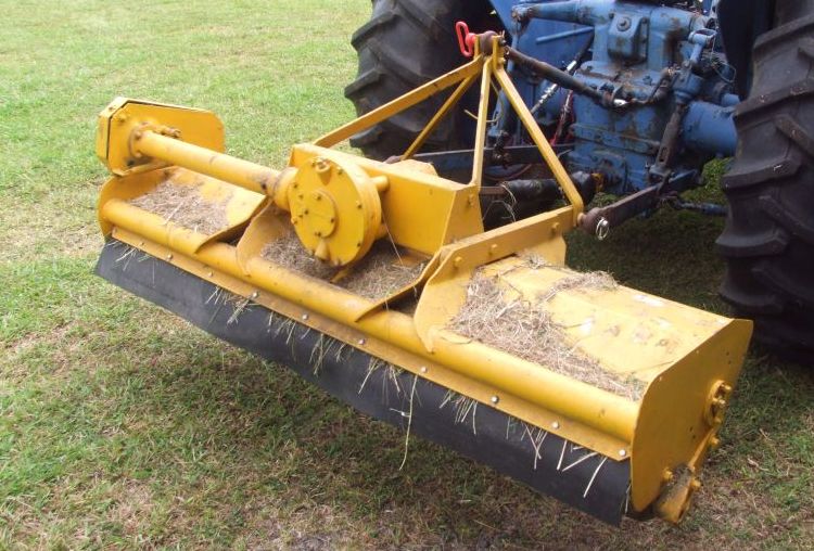

So, I guess the upshot is I should fashion a rear debris shield for my Mott SHD88 flail? Right now it's open, just as I bought it a couple years ago well used. It does produce (and spread all over) lots of fine clippings, and cuts grass very well as is. The rear is open about 8-10" so I guess it doesn't develop much of a gradient, if its supposed to.
It would be great not to emerge from mowing with inches of clippings on the mower, drawbar, PTO shield, etc.
This is one section not cleaned off yet, after one hour cutting 16" grasses.

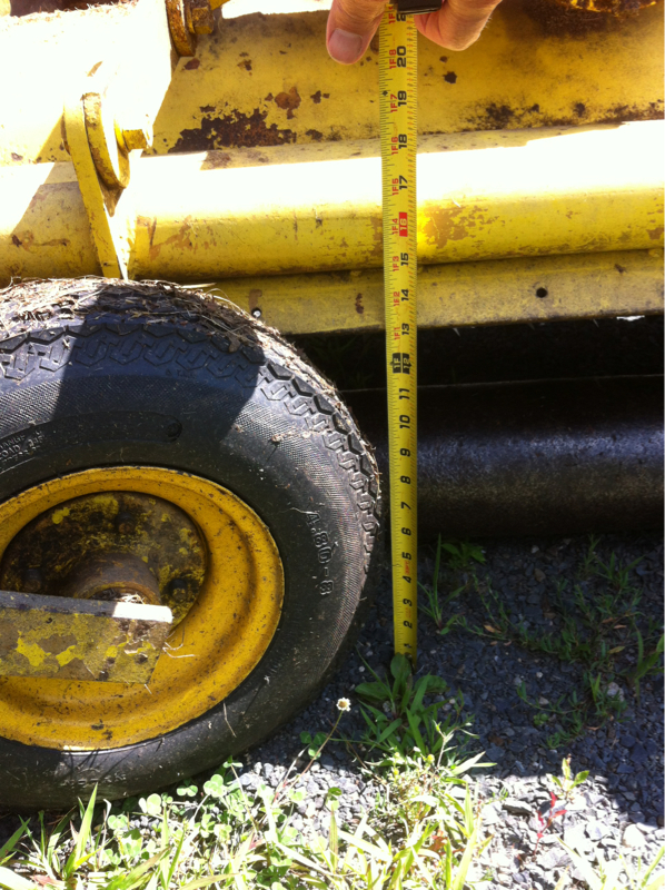

Just checked, and it's 13" open. Guess I'll close itin and see how that works.
Jim. Hmm, hope to get rid of 2nd pic

Get a piece of old conveyor belt and bolt it on. They also sell a "rubber" flap for it. That is what mine came with but I still get chaff on the top because my roller is set high.

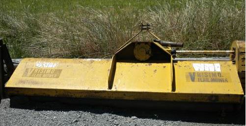

Does someone here know what model Vrisimo flail this is that showed up on my local CL? It's listed as an "8 foot" cutter, though that may be its overall width. It looks to be a precursor to the current Super Series. The most distinctive feature is what appears to be a completely rounded belt housing top with vents. Would parts be available for it? I'm trying to decide if it's worth the 3 hour round trip to scope it out. Thanks.
