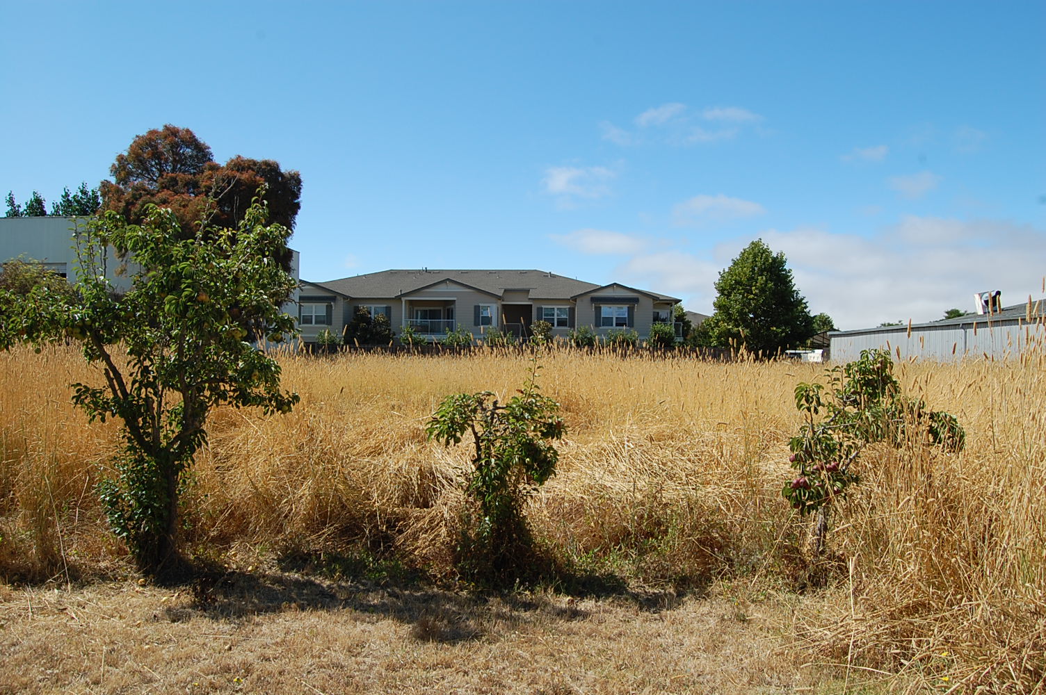

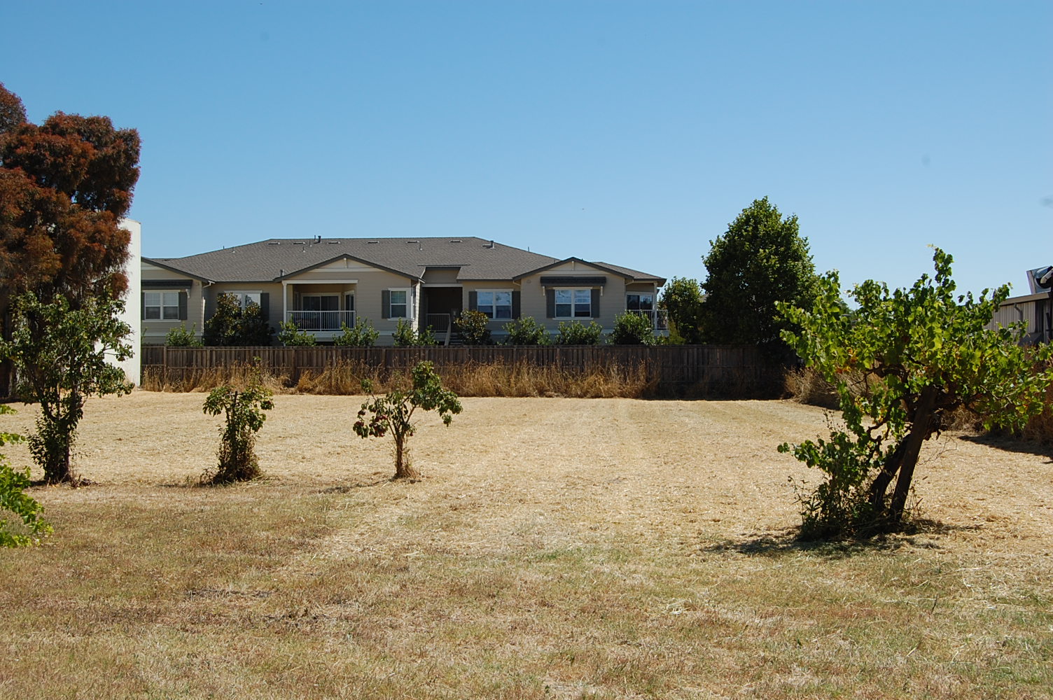

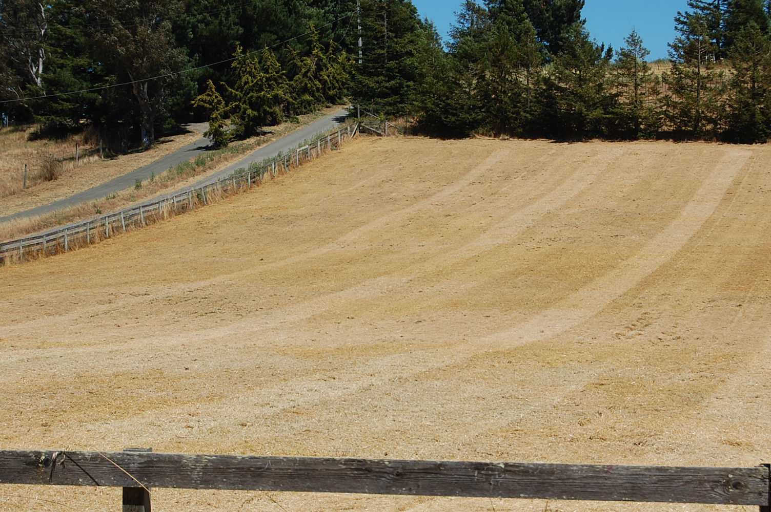

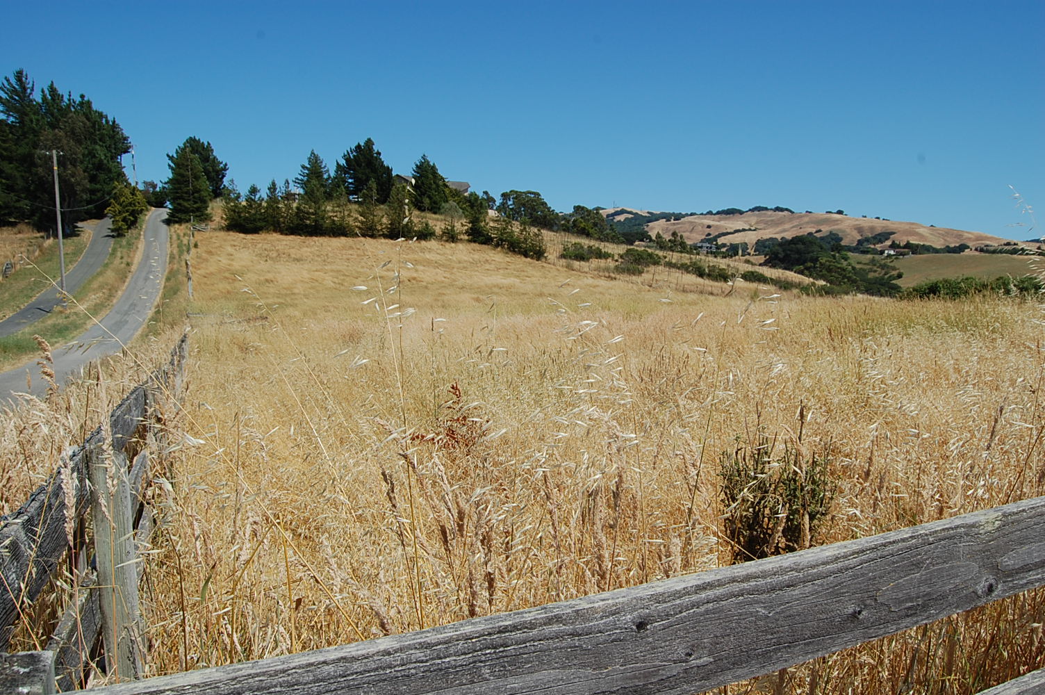

Lol, yes and no. I know it seems like an easy question. I'm not sure if it come from eating to much grass or the tractor not having the power to cut it.
My average speed for 3' grass is 1 mph when thick. When it's just tall weeds I run about 2mph ... It's only 1mph more but if I could cruise at that or even 2.5 Id be happy.
All the blades are essentials dull too. I spent over 3 hours sharpening 1 row the other night. Unbolting each one individually then sharpen and reattach made for a slow evening. 184 blades total and I only got %25 percent done.
