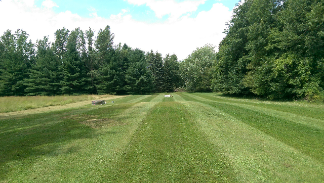

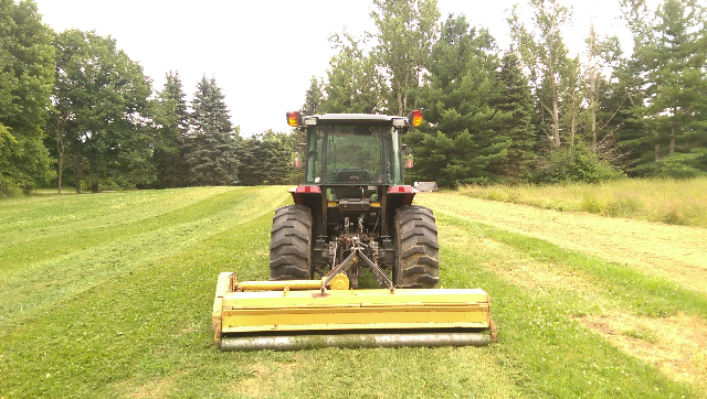

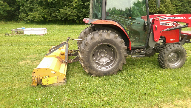

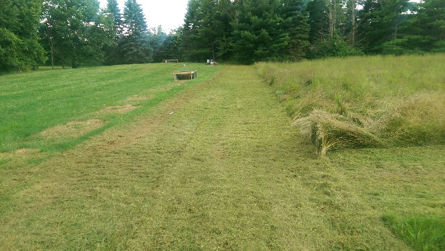

I mowed for about 4 hours today using my Caroni 1900. Yesterday's session ended early when the original belts gave up the ghost! The flail performed very nicely today and while mowing I was thinking about the "pressure gradient" debate.
On several occasions, I came upon a hawk feather (maybe they were turkey feathers), and each time the feather escaped from the mower unharmed! I even ran over a few of them a second time to see if I could mulch them. No, I could not.
My conclusion is that GMan Bart is correct.

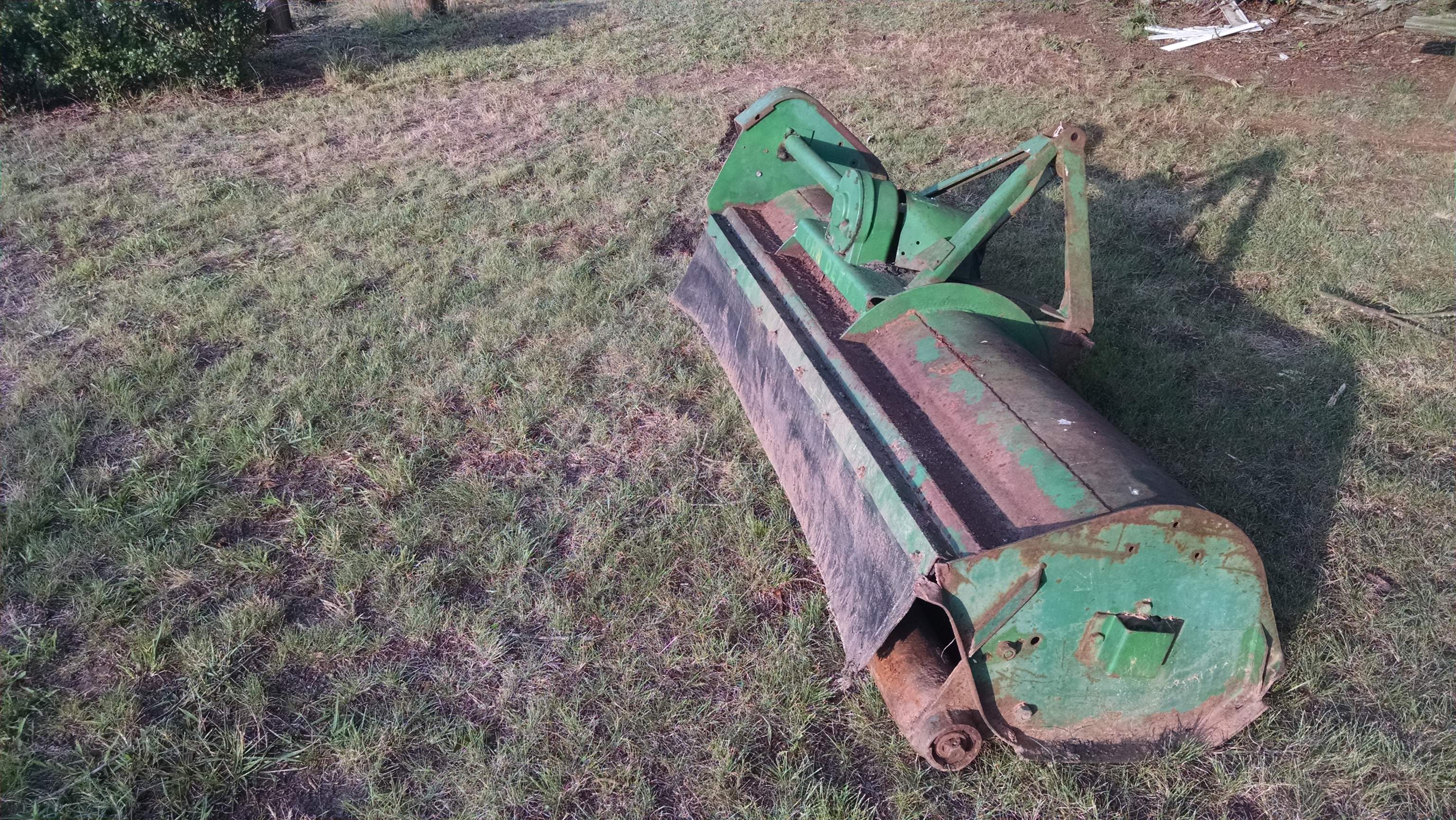

jd flail 3.jpgjd flail 1.jpgjd flail 2.jpgCan anybody help identify which model this John Deere flail mower is? I need to buy bearings and would also like the specs and in case I need any other parts, knowing what model # would be great. It is about 7ft, I'm guessing 6.5' cutting width.

TSO- those are some very nice stripes with the flail!

I want to welcome you as the newest member of the "Flail Mower Nations)
(no Passport required).
You appear to have a John Deere 25A flail mower, very well built and reliable.
It has a 7 foot cutting width and fits through an 8 foot overhead door.
I would strongly suggest you visit a John Deere Dealer and order a manual
from them for this flail mower.

Yes sir they are and it not cost him an arm, two legs,
and a second mortgage for a lawn striping roller either.

I'm very excited. Hopefully I will get it up and running soon. Thank you for the info and help!
