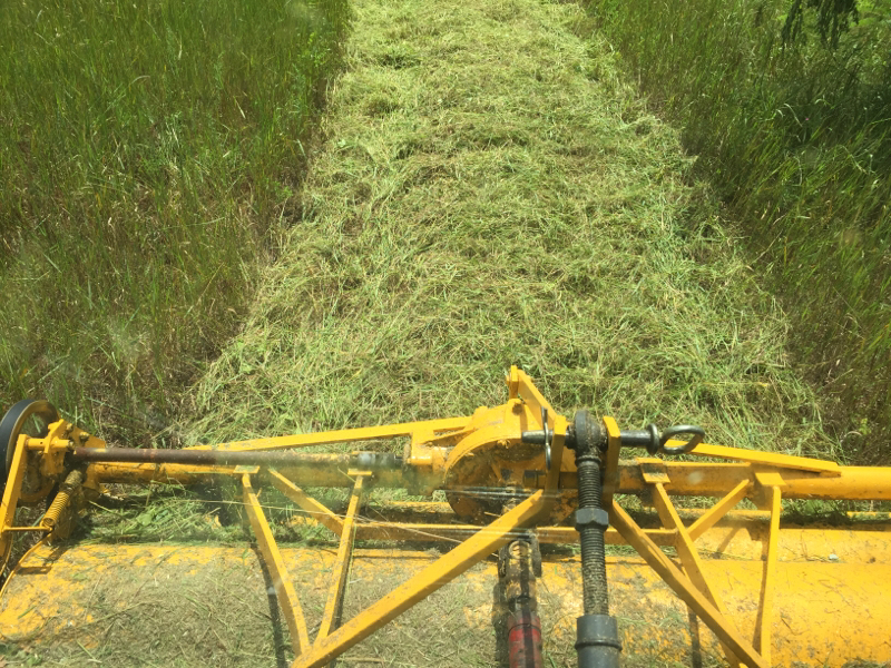

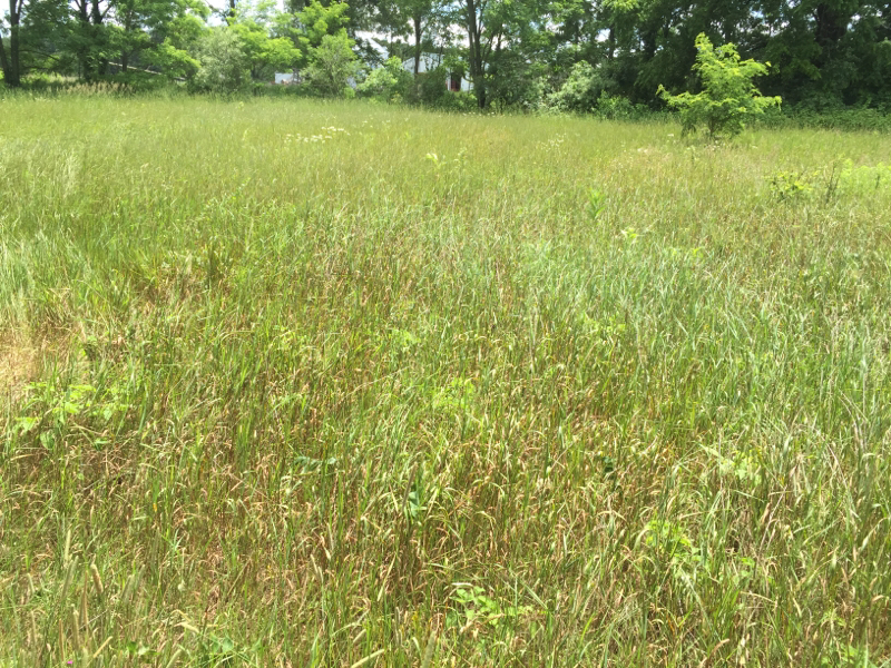

So today I cut about 35" grass/weeds with the top link extended leaving about 6" plus Mohawks ....
I then blew the cut grass off the area with a back pack blower revealing the Mohawks ..... I then shortened the top link and cross cut the area with nice short results..... I love this flail mower game.....
/ Let's talk flail mowers #2,099
Hello KenB2920, I see that your mowing session went very well. it will be even better when you go over it again at two inches in cutting height. Happy mowing.
Yes, this was a photo of the first pass (and dull blades). I then blew off the grass clippings and cut at a lower height. The customer seemed to be really happy. He is having a firework display this coming week and wanted as much dry dead grass gone.
The one thing I really like about a flail vs a rotary cutter is the ability for a regular mower (Ztr) to be able to immediately cut afterwords.
The flail doesn't leave the large clumps and can cut much shorter. Then with a rotary mower, if you attempt to cut short and then make a turn, it slices the top of the sod with the drag rails leaving a mess.
I still have many more hours of trial and error to perfect my performance but this seems to be a winner. Rotary cutter may only come out for thick brush as these are a dream to use.
