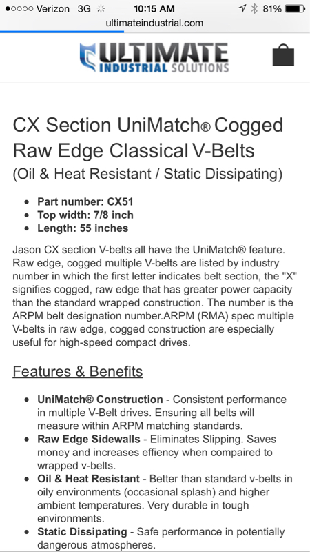

Is this belt ok? It's what's on my Mott. Id like to have a backup in case the current one breaks. This is what's currently on it. More photos to come but I can only send one photo per post from my phone for some reason
It only has one belt? I wouldn't use a cog belt unless it has cog pulleys. The cross section is smaller and you may need all the strength you can get.
My old 72" Barracuda uses three belts. But it does overdrive to something close to 2.5 x PTO.
/ Let's talk flail mowers #2,042
As long as the belt is the proper size for the pulleys and the length it will last until it breaks.
after that you can buy the standard Kevlar V belts.
this type of tooth belt has a high strength for normal use as a true cog drive belt has wide toothed pulleys..
