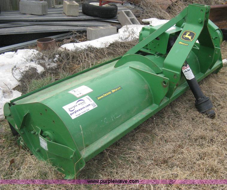

I bought a well used JD 25a flail a few weeks ago. Decided to grease it and give it a test drive as-is and was very disappointed with the cut and performance overall. I just about put this mower in the garbage can but decided to spend the money for a new set of knives and related hardware. Swapped them out tonight and took it for a test drive, and wow what a difference!
The old knives weren't that bad but I'm absolutely amazed at the difference with the new knives. This thing actually performs like I thought it would (based on reading this thread) when I bought it. For any of you thinking about picking up a used flail I definitely recommend spending the coin for new knives as the improvement is significant.

I have a JD 25A mower. There are two types of blades for the 25a

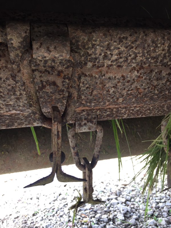

This one is used for more of a finish cut
attachment.php
and this one cuts better in tall grass
attachment.php
Here is a newer type with iMatch compatibility
attachment.php
I have the older type without iMatch compatibility
attachment.php

Wow, ok. Here I thought the duck foot was called a hammer and more designed from brush and the the side type blades were meant for finish. Interesting. The next question, what is i match?

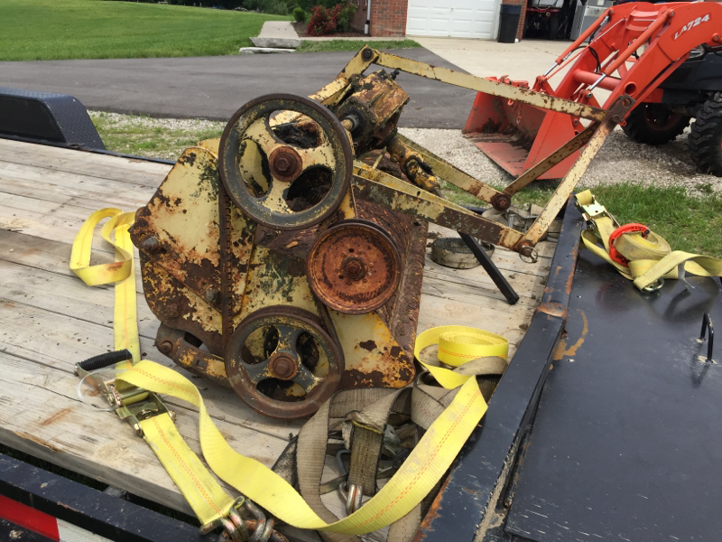

Picked up these today <img src="http://www.tractorbynet.com/forums/files/attachments/429836-lets-talk-flail-mowers-image-3715905170-jpg"/>
Two "new to you" flails?? Nice. I see fresh grass one one. Is the second also functional?
